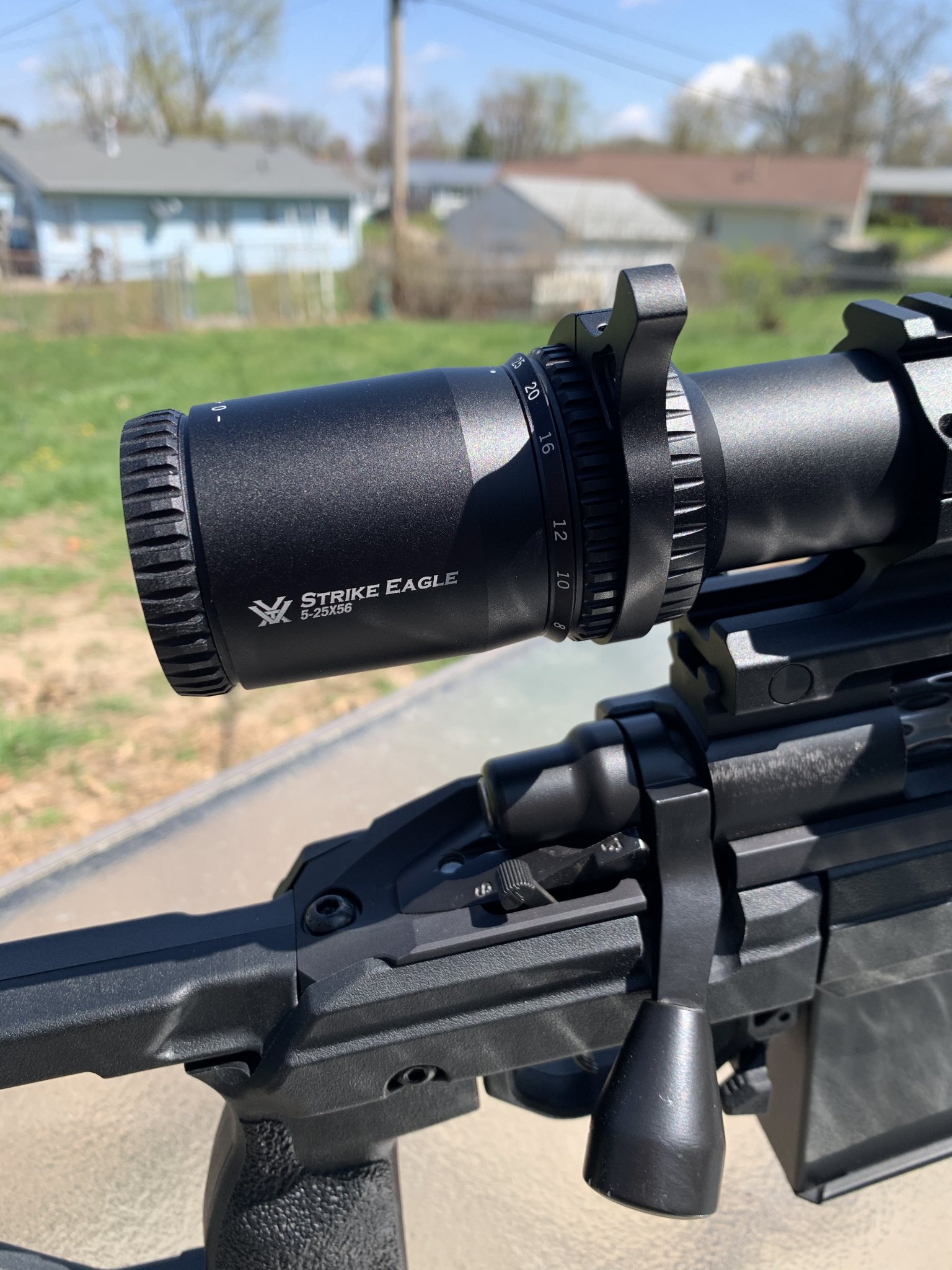

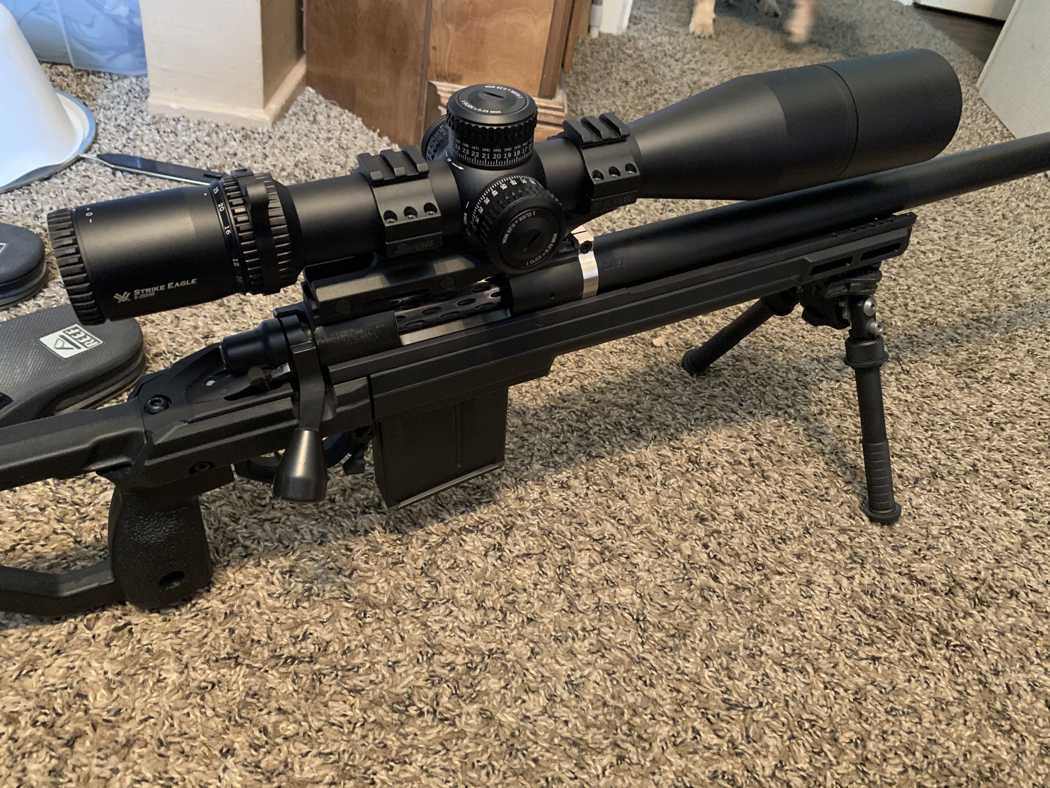

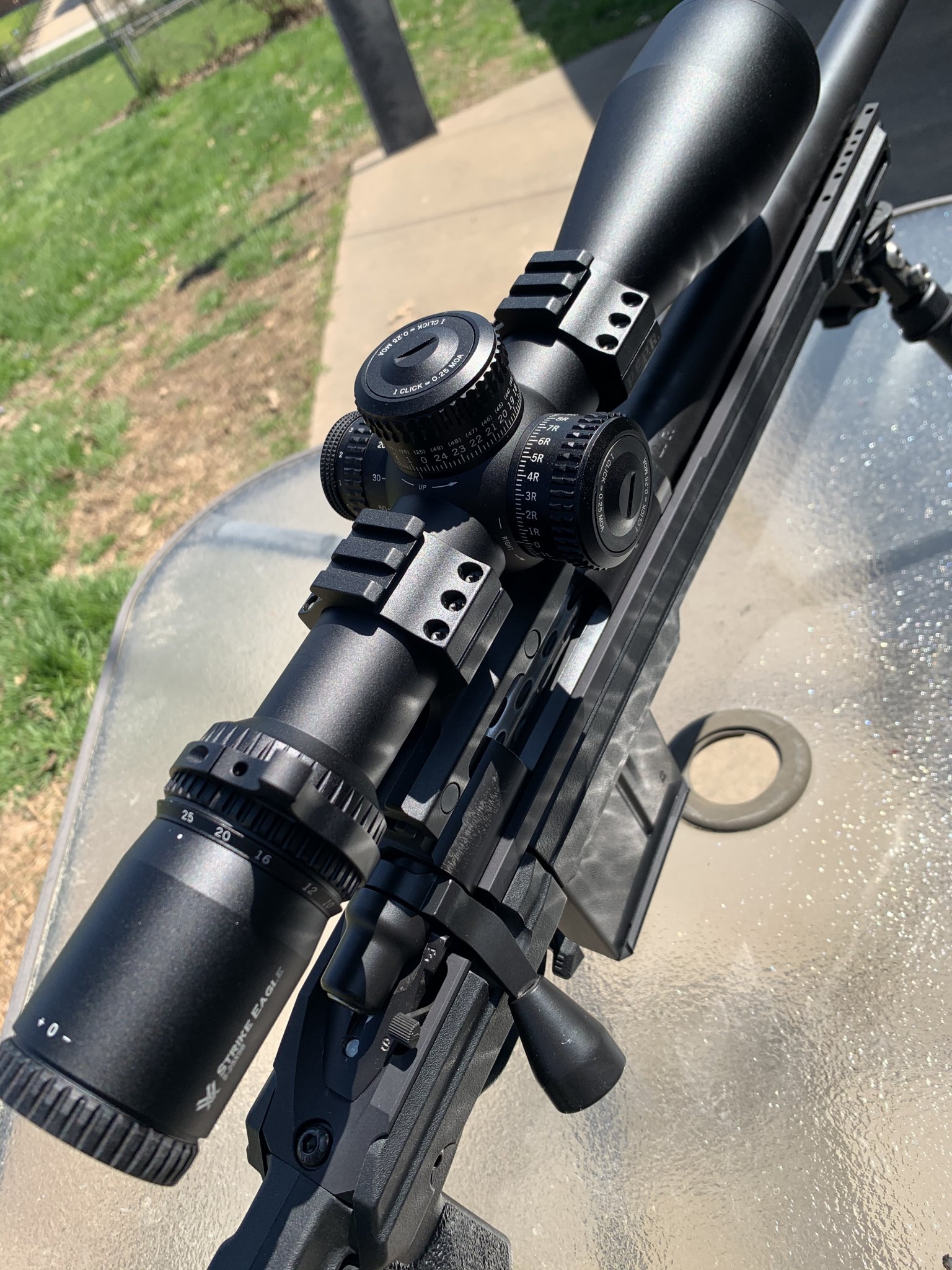

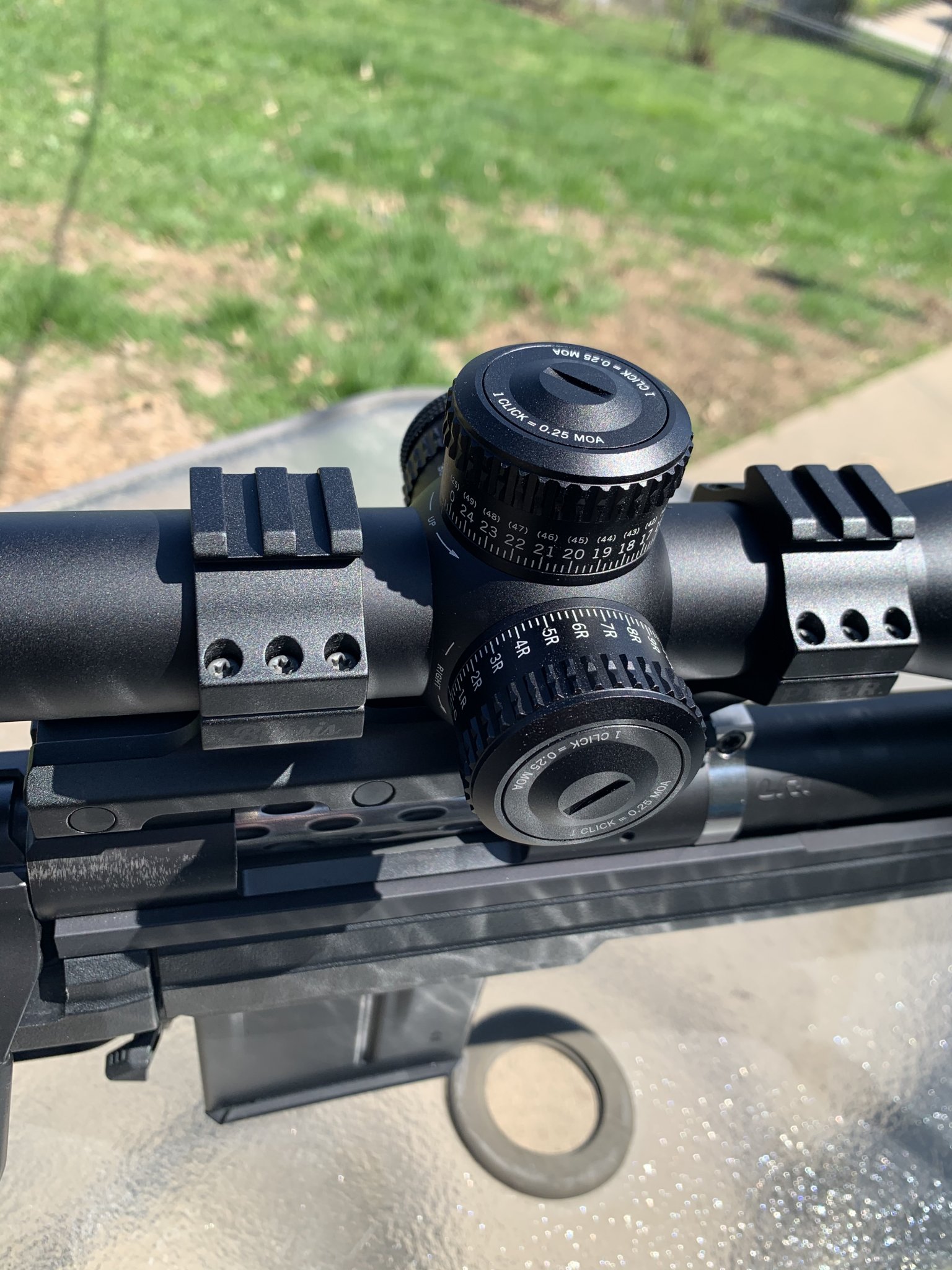

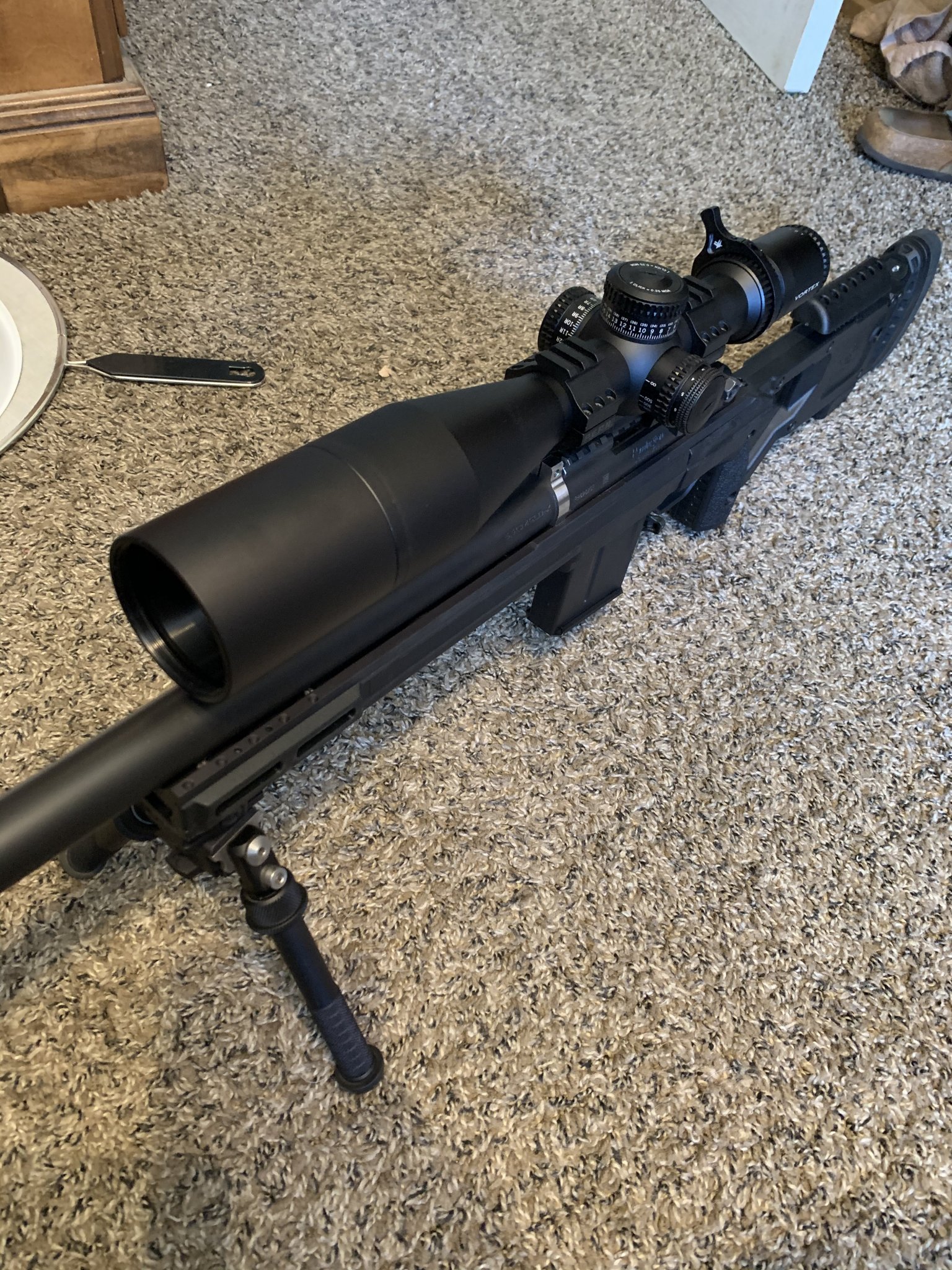

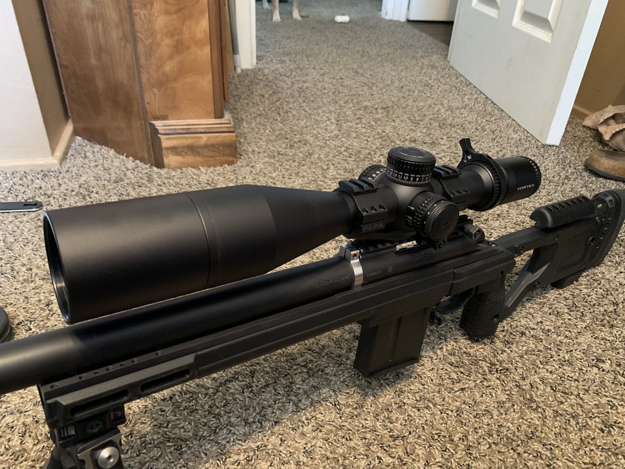

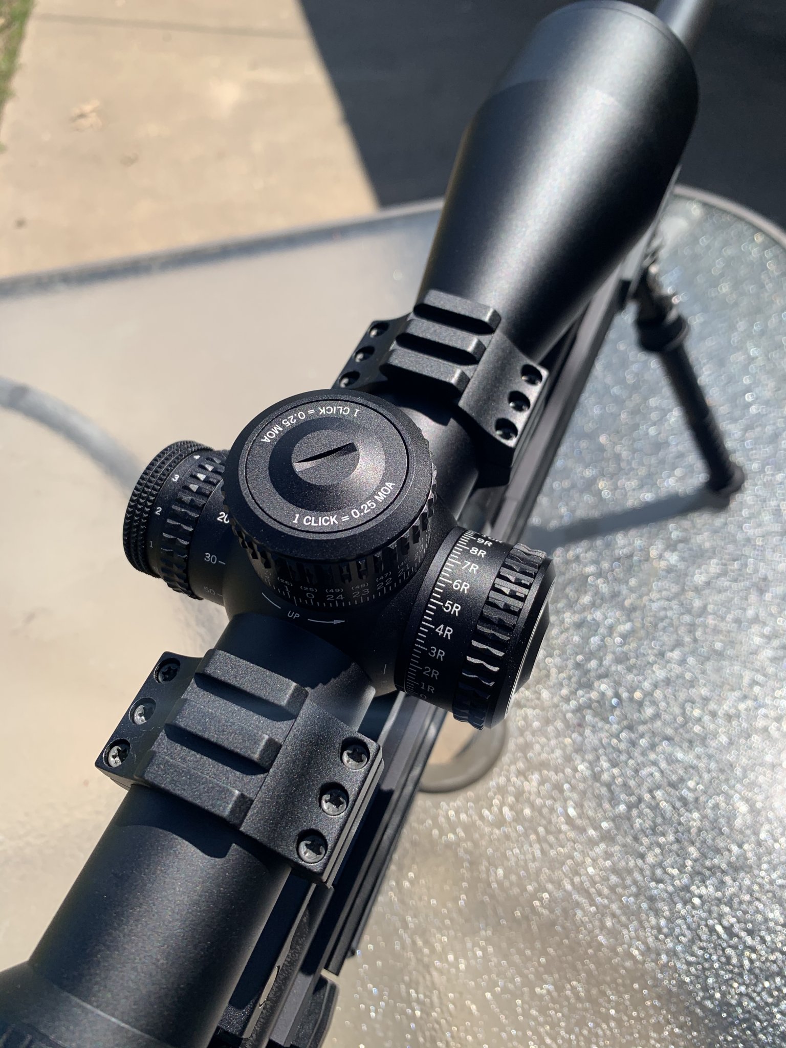

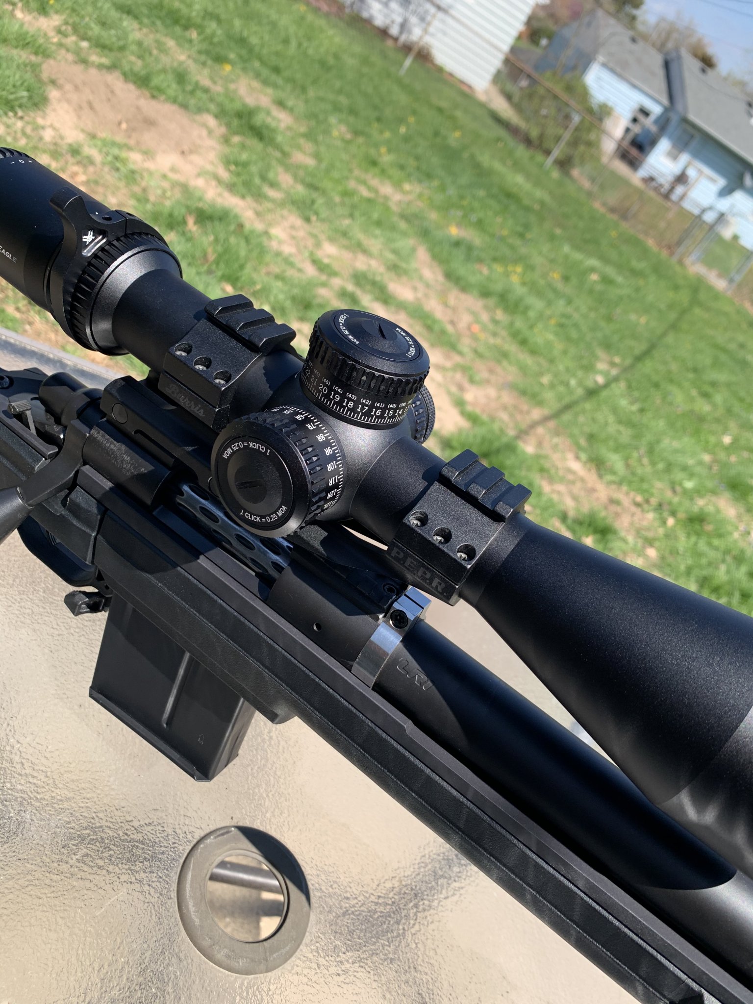

They are here..... First impressions are decent. Turrets are similar to the pst gII click wise. glass isn't to shabby but i would definitely compare it to the pst gen I or HST. Gen II i feel does have the leg up of course in comparison glass wise by my eyes. I bought 2 of them gonna mount one of them and see how it compares and figure out the zero stop. If anyone wants any pictures just let me know.
Can you please take some pic and also close up pic if you don’t mind?
Really looking forward to get one.
thanks so much this info. im gonna stick with athlon for this price point. It was always gonna be difficult for me to try something else after the midas tacs and Ares.
Here ya go
I hope the turrets are better than the pst gII 1-6. I get those turrets aren't exposed but they were some of the worst factory turrets I've ever felt. They were almost completely useless due to being stiff and not tactile. I recently took some alcohol to the internals and replaced the factory lube with Hornady wax case lube and it made all the difference in the world.
turrets look similar to Gen 2 Viper.
oh man... I need to get one.
could you tell me how much you paid and where to get one now?
I just ordered one yesterday from SportOptics. They said they are supposed to get them in today or tomorrow and ship by the end of the week. I paid something like $667 shipped after tax. Arizona has pretty high taxes so your price may be a little lower.
I just bought mine from aaoptics. Ordered it yesterday and it came today, which was blazing fast!
My first impressions are very similar to others. I was impressed but the turrets. They are not at all like the diamondback tactical line or even the previous strike eagle 3-18 or 4-24. They are much more tactile.
The glass really isn't that bad at all. I didn't have a more apples to apples scope next to it but I did have my nightforce NX8 4-32 for a side by side on my 200 yard range. No it wasn't quite as sharp but not so much that I wished I would have paid 3x the price. It did quite well. I could make out the 22 splashes on the 12" steel square at 200 yards. The top end clarity will work fine but it got better if I backed of the mag a bit. I know others are going to ask about a Midas Tac comparison glass wise. I still think the Tac has better glass. For me I'd rather have the features of the strike eagle for my purposes. That's not bashing the glass either, but the Tac is still at the top of the heap for glass in this range.
I think after I spend more time with it at extended ranges, it will be a better assessment. I just didnt have the range today.
It is really nice looking through a 34mm tube and 56mm objective. The FOV was great. I also noticed a forgiving eye box which is great for positional shooting.
Overall, I would not hesitate to buy one of these.
