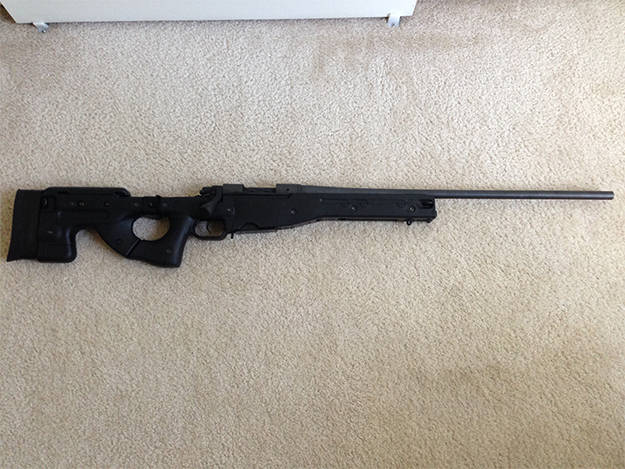

Hello, I'm currently finishing up my first riffle build. All I need now is a scope (and rings + base) to complete the build.
The scope that I originally planned on purchasing is the > Vortex Viper 6.5-20x44 PA Scope
Just this week I see the > Vortex Viper 6-24x50 HS Scope go on sale.
I'm looking for feedback on which you think I should purchase.
Here are some specs on my background:
- I'm a new shooter looking to get into regular range visits and long range shooting
- I own a Remington 700 mounted in an AICS chassis
- I'm currently on a budget, looking for best bang for buck (max I can spend: $440)
- Distances that I will be commonly shooting at: 100 - 600 yards. (more toward the lower end of the scale)
Thanks for your help on this!!
