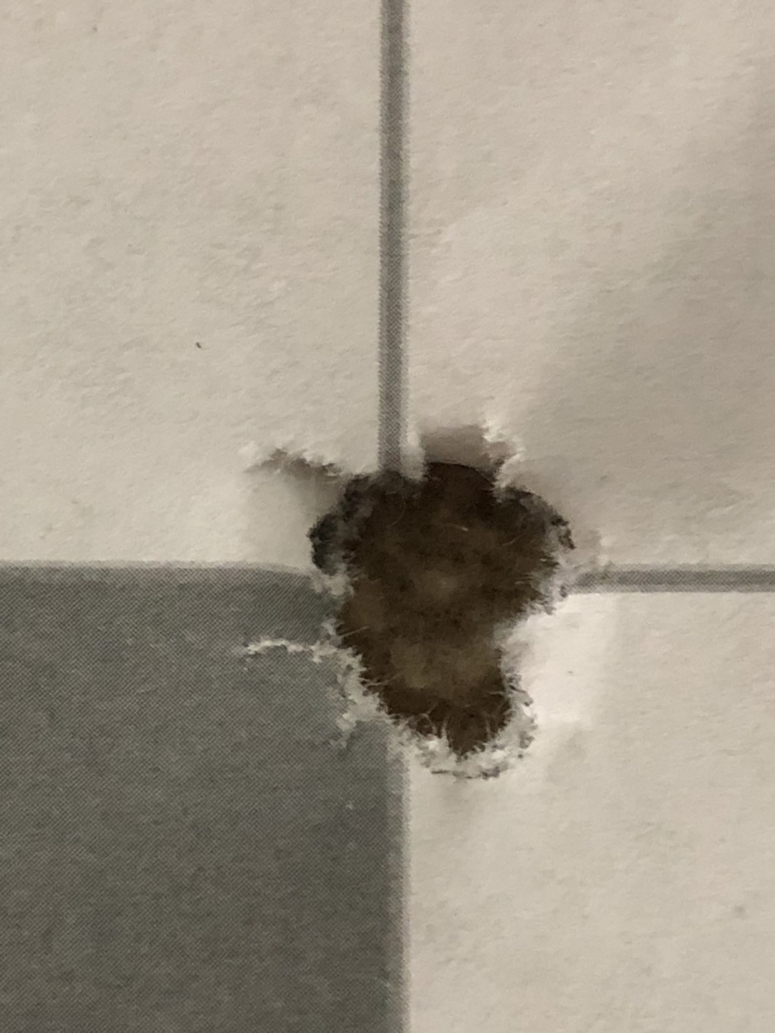

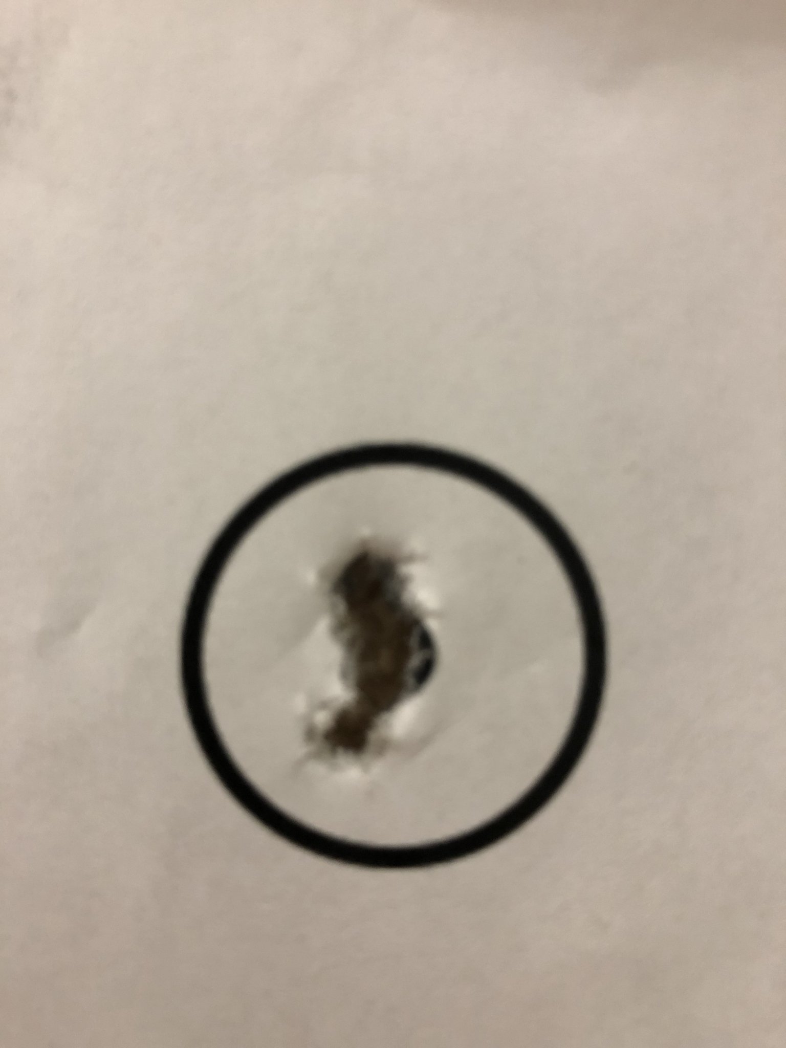

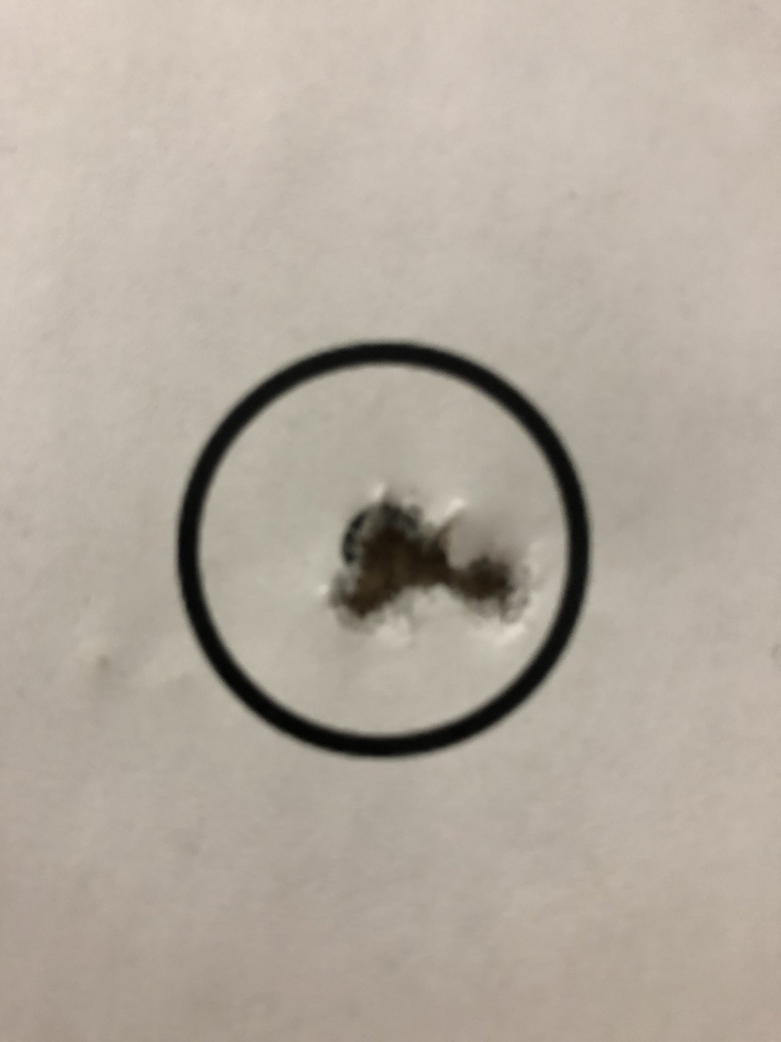

I just shot my Vudoo for the first time yesterday. Here were the first three 5 round groups fired at 50 yards after zeroing it in. This was with Eley Tenex.
