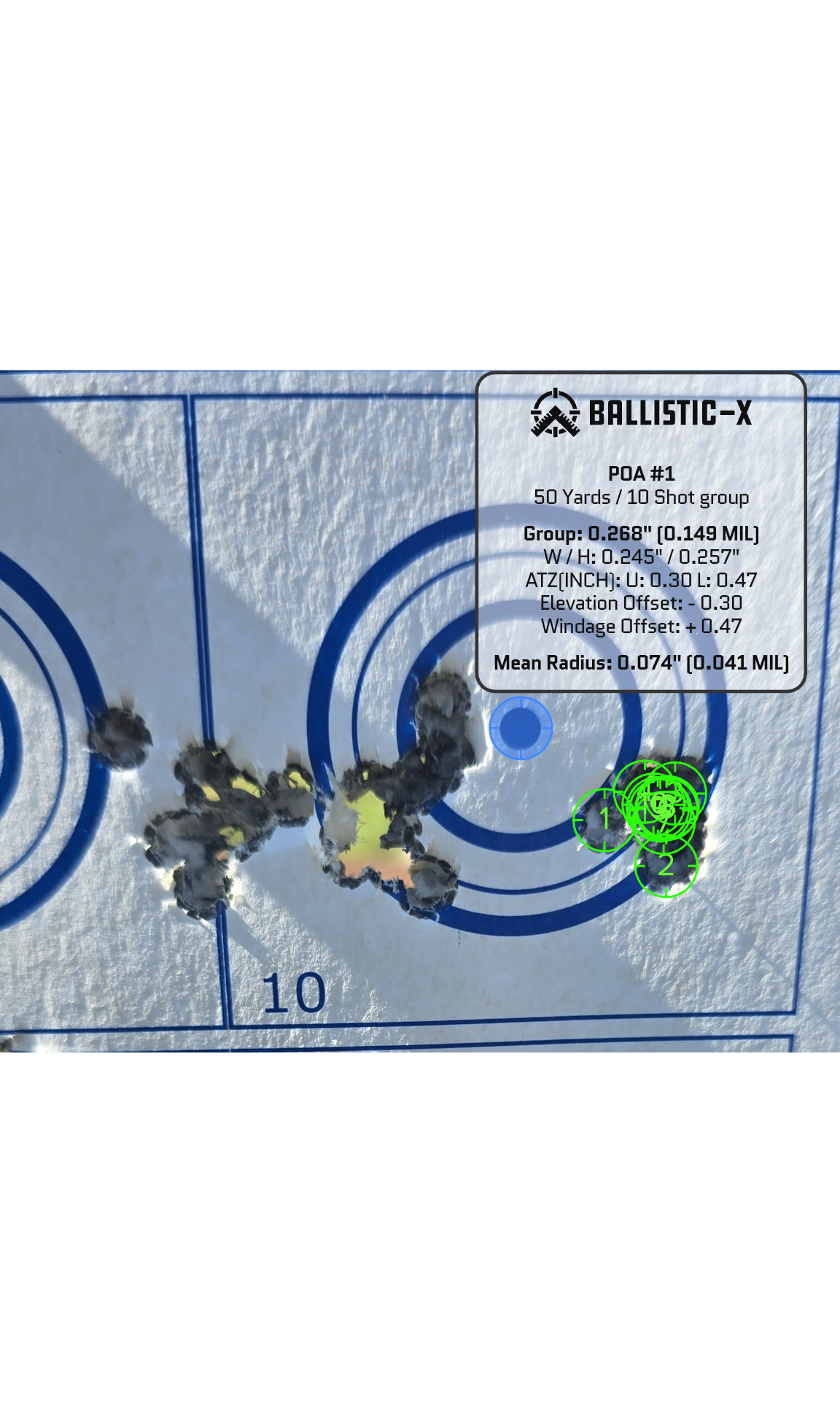

I recently did my own tuner test. I think it was a total of 78 five shot groups. Average 5rd group size was .31. I don’t remember what the average 30rd group size was. With a random lot of center x. I was happy with that. As for the test, I picked the best and worst settings and re-shot them. They flipped…. Also ran a p test on the data and no difference was found.
A few details please. Barrel length and profile and tuner weight or type. Note that you only proved your tune was without merit, not that everyone else's are without merit.

24ā€ MTU. EC v1 tuner. Note that nobody has yet to show a test proving it works on their gun….

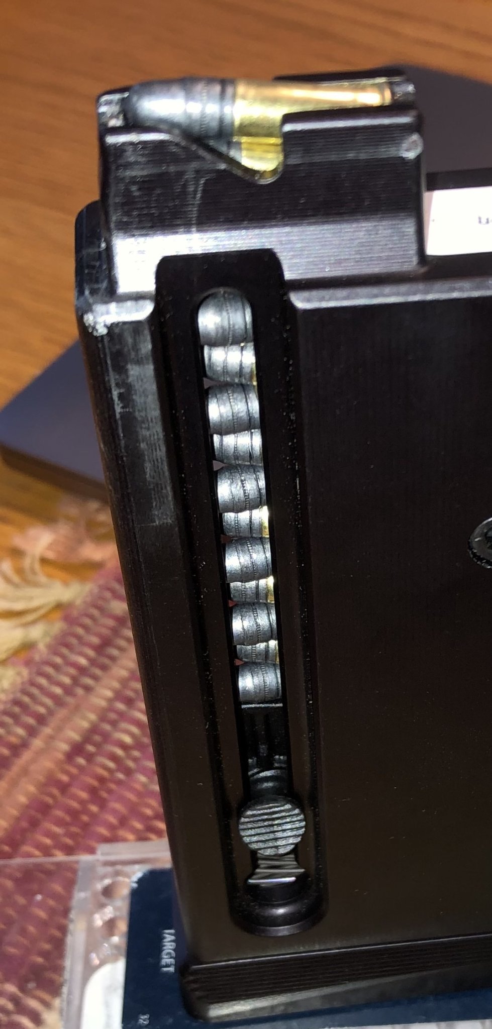

Another viewpoint on Vudoo magazines: They must be loaded correctly.
  • See the photo - notice the staggered appearance of the cartridge column. If the mags are loaded correctly - by depressing the follower button just enough to slide a cartridge under the feed lips - the column will usually adjust itself properly.
  • If two cartridges do not orient in this staggered fashion, the shooter will likely experience a misfeed when these misaligned cartridges reach firing position.
  • Note the bullet orientation at the top of the column. If the bullet appears "flat" and its nose is at or below the front of the mag, a stoppage is likely.
  • If a shooter just presses the follower button down as far as it will go and drops cartridges in, rim lock and/or misalignment (first bullet) are likely.
Last year, a guy appeared at a match with a fairly new Vudoo, and he experienced stage-ending (for him) jams on first two stages. I asked him to show me how he was loading his magazines. He pushed the follower button all the way down and dropped in cartridges. Misalignment in this bunch, and he had had actual rim lock on one stage.
I showed him one of my loaded magazines and explained how to load. He finished the day without another misfeed.
[This is NOT directed at OP; it's a general observation] Too fussy? Fine. Go buy a 10/22 with a bolt that flops around like a toothpick in a soda straw. Or an AK-47, which will feed with the action half-full of sand. You want optimal accuracy in a .22LR? you gonna have to learn your precision platform's idiosyncrasies, whether it's Vudoo or Rim-X or whatever.
Edit: the photo below shows a cartridge column in a discontinued 15-round Vudoo mag. The staggered appearance is less pronounced in the 10-round mags, but is still visible.
