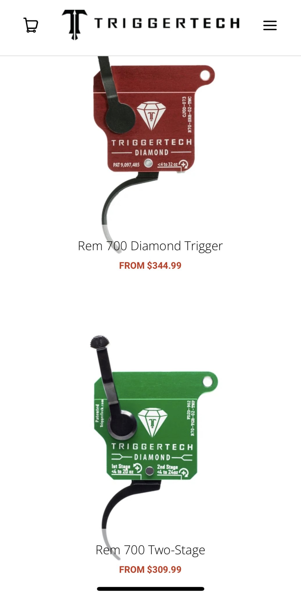

I've decided on a TriggerTech Diamond trigger for my new Vudoo build. But can't decided on whether to get the regular single stage, or a two stage version of the trigger? I have a two stage on my Tikka CTR and love it.... but this is for a .22LR bench rest use rifle...
For some reason the two stage is cheaper than the single stage?
Any suggestions? I'm going to use at a bench exclusively for bug hole groups.

2-stage also isn't cheaper than the single stage.
