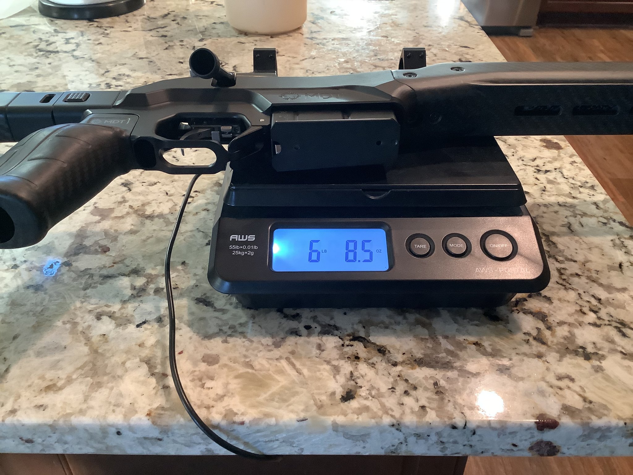

MDT HNT26 chassis, phenomenal chassis that is lighter than my AG composites stock without any bottom metal.

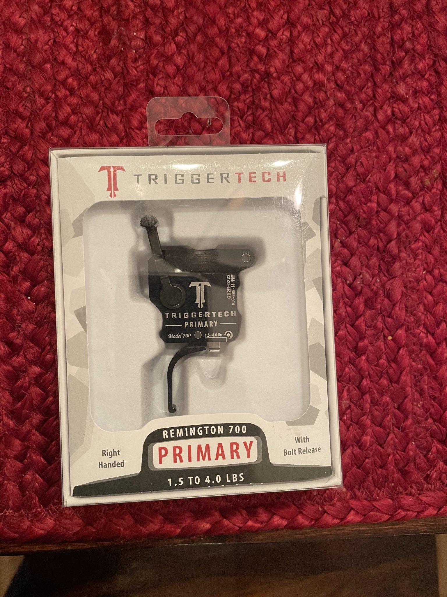

Not necessarily the trigger I was looking to get, but swung by my LGS on the way into work tonight to look at cans and walked out of there with this one:
I know a lot of precision shooters don’t like a straight trigger, but I have them on most of my personal ARs and like them a lot. I figure if I don’t like this one, or upgrade to a two stage (likely at some point), this one can replace the stock trigger in my factory Rem 700.

That’s a pretty good “spare” trigger to have. They are pretty incredible especially for the price they’re going for now

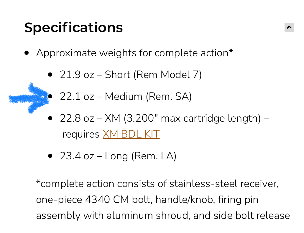

I’ll confirm with Defiant, but my action is their ‘medium’ and specifically says Rem 700 Short Action.
The next size up is their XM for longer OAL…and then of course, the long action:
I’m 99.9% sure I’m still gtg with my Defiance Medium (Rem 700 SA), and will need the regular mags from y’all but will confirm with Defiant. Good thing I’m 10 months out from production to educate myself and get these details ironed out, eh?

Confusingly, Defiance calls their R700 Short Action profile a "Medium" length, whereas other manufacturers (ie: Lone Peak, Zermatt, Impact, ARC, etc.) will refer to them as a "Short" length. Defiance's "Short" length is equivalent to a Remington Model 7, which is very unique and a different inlet all together!
Long story short, yes, our standard 3 and 7 round magazines for the AICS SA pattern magazine wells will drop right into the R700 SA RH HNT-26 chassis and feed factory/SAAMI length 6.5 PRC rounds without issue! No need to change your order :)

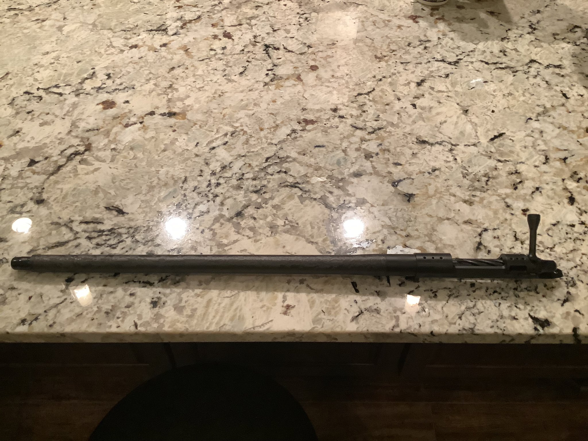

Well, my Defiance ‘Anti‘ receiver is delayed until the end of the year (at the earliest), but I’m one step closer!
21” cf Proof Sendero profile barrel showed up today:
test fit … this is gonna be bad ass! I hope it shoots half as good as it looks!

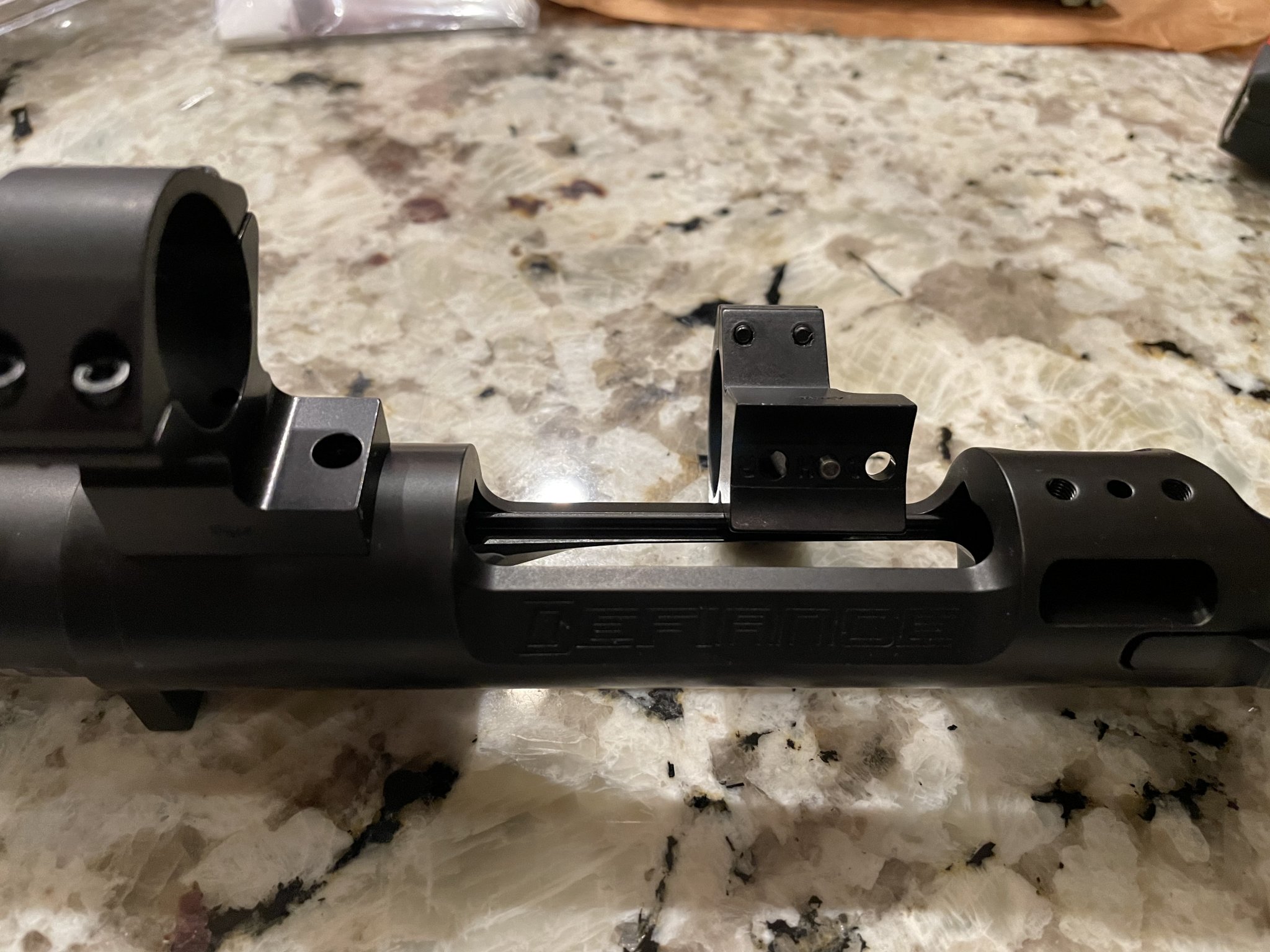

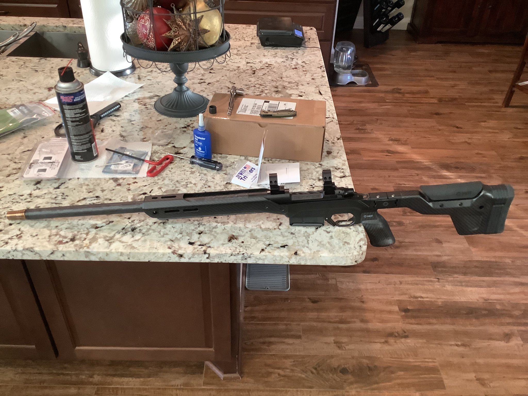

Got it home!
Grabbed a set of their Talley rings too, modified with a recoil pin to match the machined holes on top of the receiver:
Of course it was only after I got home that I realized I don’t have any 1/2-28 cap screws on hand (or even any regular 1/2-28 screws that are long enough for that matter) to test fit the action to the chassis. LOL
Will run out to the nearest Ace Hardware, 15 miles away, to get ‘em…gives me a project before my son and his wife arrive tomorrow morning!
Reactions: MDT_Josh
Quick test fit…only minor issue is that the Q Cherry Bomb muzzle device won’t thread all the way on. Likely just tolerance stacking, the thread protector as well as a couple spare Dead Air muzzle devices I have fit just fine. Just need to pick up a 5/8-24 tap and die set to clean up both sides.

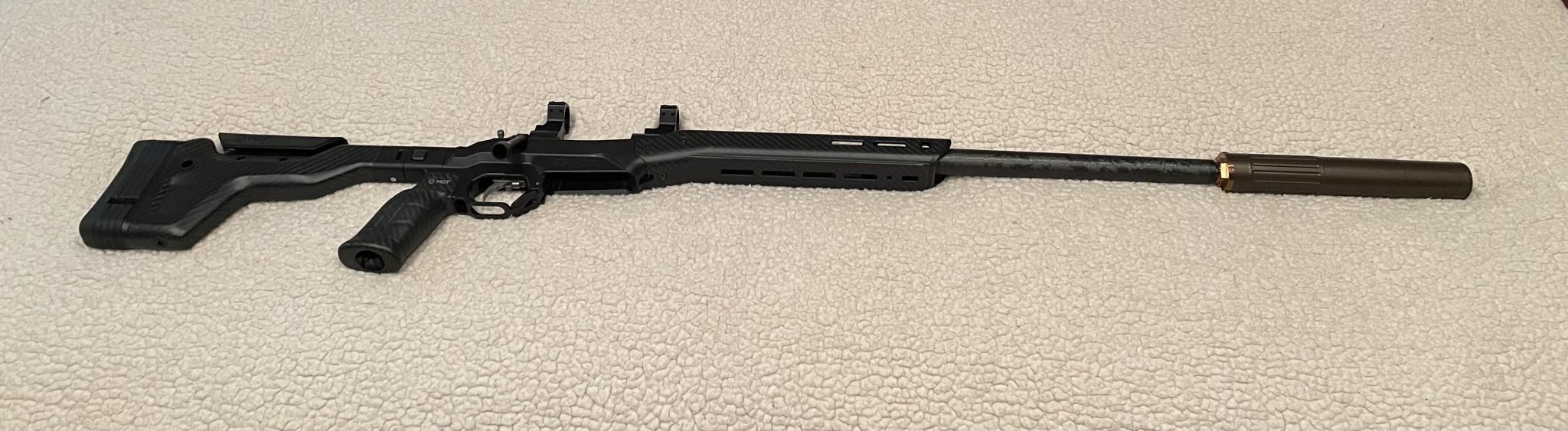

Got my receiver back from @Defiance Machine a couple days ago; had ‘em do up a standard bolt face so I can swap in a .308 barrel at some point. In the meantime, got it spun back up onto the 300WSM barrel this afternoon:
Amazing what having the right tool for the job does for a task…literally took me less than 5 minutes, including setting up the barrel vise in the mounting plate I picked up from Inline Fabrication.
All good after a quick check:
and…
Also got the Nomad LT that’ll have this rifle as its primary host out of ATF jail a week or so ago! Man, blown away how light and effective this can is on some 300BLK loads I‘ve put through it so far.
Really looking forward to seeing how it performs with this gun and 300WSM:

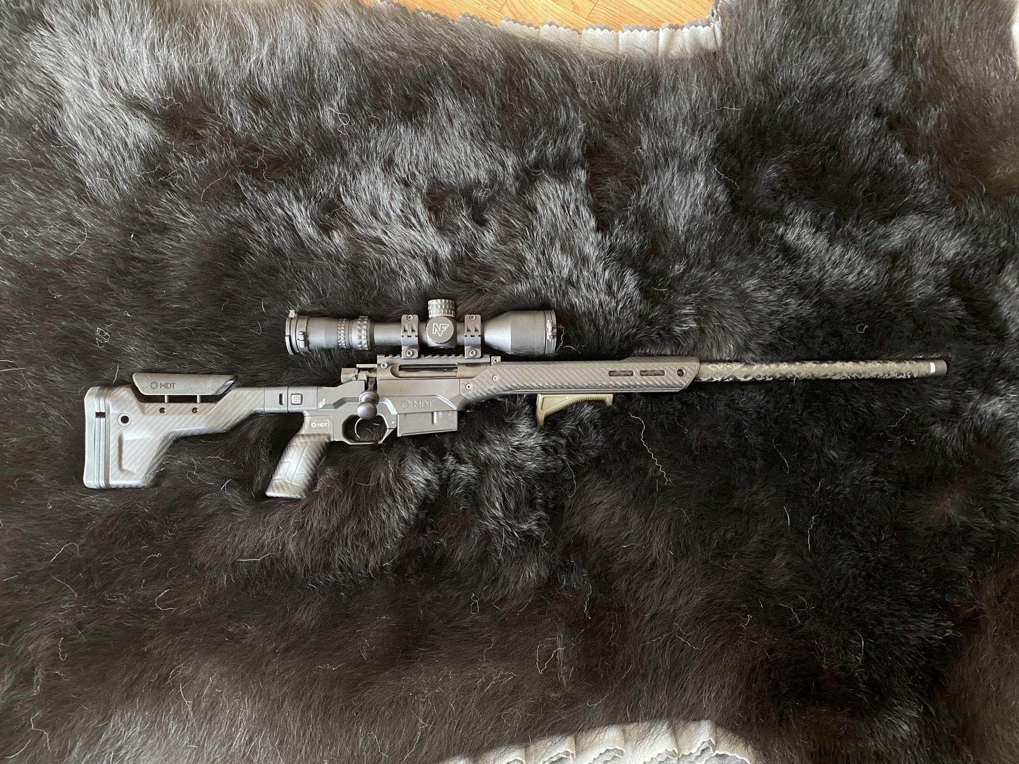

Gettin’ close:
Quick update; got a Swarovski 5-25 non-illuminated scope with a 1” tube for now. Not ideal, but the lightest scope I could find with the magnification range I was looking for.
edit: the bell isn’t touching the barrel…only a couple mm clearance though.
Had time to do a quick 100-yard zero before I ran out of daylight, and will try to get out for a 200-yd zero later this afternoon, or next weekend. I was all over the place until I actually sat down to shoot instead of using the tripod, but once I got the center two, final zero was the upper right diamond target (2 clicks left for the last 3 closest to the center).
Yes, I still need to work on breath control (vertical strings)…and use a real rest instead of a wobbly stack of carpeted 2x4s.
Got back home too late to get to the range again today, but took a couple more pics in better light…
And a pic of the very narrow gap between the barrel and the objective bell. Actually a bit wider than this, bad angle, but you get the idea:
