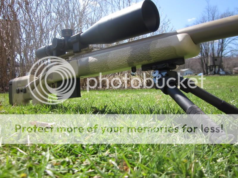

I recieved this build back a couple months ago but just got finally around to posting pics:
Thanks to the Warner's (Warner Tool Co.) they make a beautiful rifle.
The weather has been so bad here and I have been so busy I have not had time to shoot it yet but I do have so 208gr. A-MAX's, 220gr. SMK's and 190gr. SMK's loaded up with H-1000 and RL-22 to test. I just got some of the new Hornady 225gr. BTHP's yesterday. Im going to try them with H-1000 or Retumbo first.
<span style="text-decoration: underline">Here is the Specs and Pics:</span>
Bartlien 26" #7 MTU Contour 1-10 Twist bbl
Badger FTE Brake
McMillan A-5 Stock w/ Adj. Cheekpiece
Rem700 L/A Blueprinted, Marine Tex Bedded.
Surgeon KMW Bolt Knob
Warner Tool Recoil Lug
20 MOA Base opened up to 8-40 Screws
Badger M5 Bottom Metal
CG Jackson Trigger Mod-22
Accushot Atlas Bipod V8
Accushot 3.5" Bipod Rail
Nightforce 3.5-15x50 NXS w/ NP-R1 Reticle
Badger USMC DMR Rings (1.031")
All metal Coated in Birdsong Tan-T
Its a 16lb BEAST!!

The guys at Warner Tool sure know how to make an accurate rifle. The farthest range i was able to get to so far was 600yrds. It held MOA no problem out that far. I cant wait to stretch it out to 1000yrds+ and see what it can really do.
It took me 11.5 MOA to get out to 600yrds with Factory Black Hills and FGMM 190gr. SMK's.
The wieght of the rifle (17lbs loaded) and the Badger FTE brake surprised the hell out of me of how much it tamed the recoil but the guys shooting next to me where kinda pissed!...LOUD!
