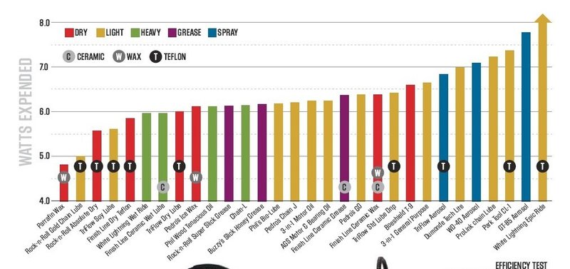

    I saw a graph once that showed the frictional force of a bunch of different oils and wax had the least frictional force. If I can find it, I'll post it.
    There's something missing in that chart. "Watts Expended" to do what? What is this application, or what does this chart pertain to? What are the surfaces involved, and what kinds of pressure and heat are they subjected to. (I.e., a surfboard is very different than an engine main bearing, etc).
    Vh20,
    I'm not exactly sure what the chart pertains to, but I'm thinking it's either a bike chain or motor cycle chain. I just looked up wax friction on Google is all I did.

    Vh20,

    That would make sense. I have a wax based ceramic impregnated lube for my mountain bike chains. Its really good stuff, It goes on dries up and does not collect dirt. I have used it on the ram of my reloading press also to stop it from squeaking, It lasted about a year and a half before the ram started seeking again. I will have to ask my dad, but I am pretty sure he is using it in his ar-15, bolt lugs, and pistol slides.
    The one I use is actually listed on the chart, "Finish Line Ceramic Wax lube."
