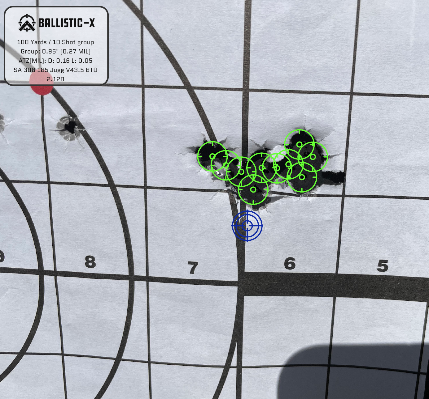

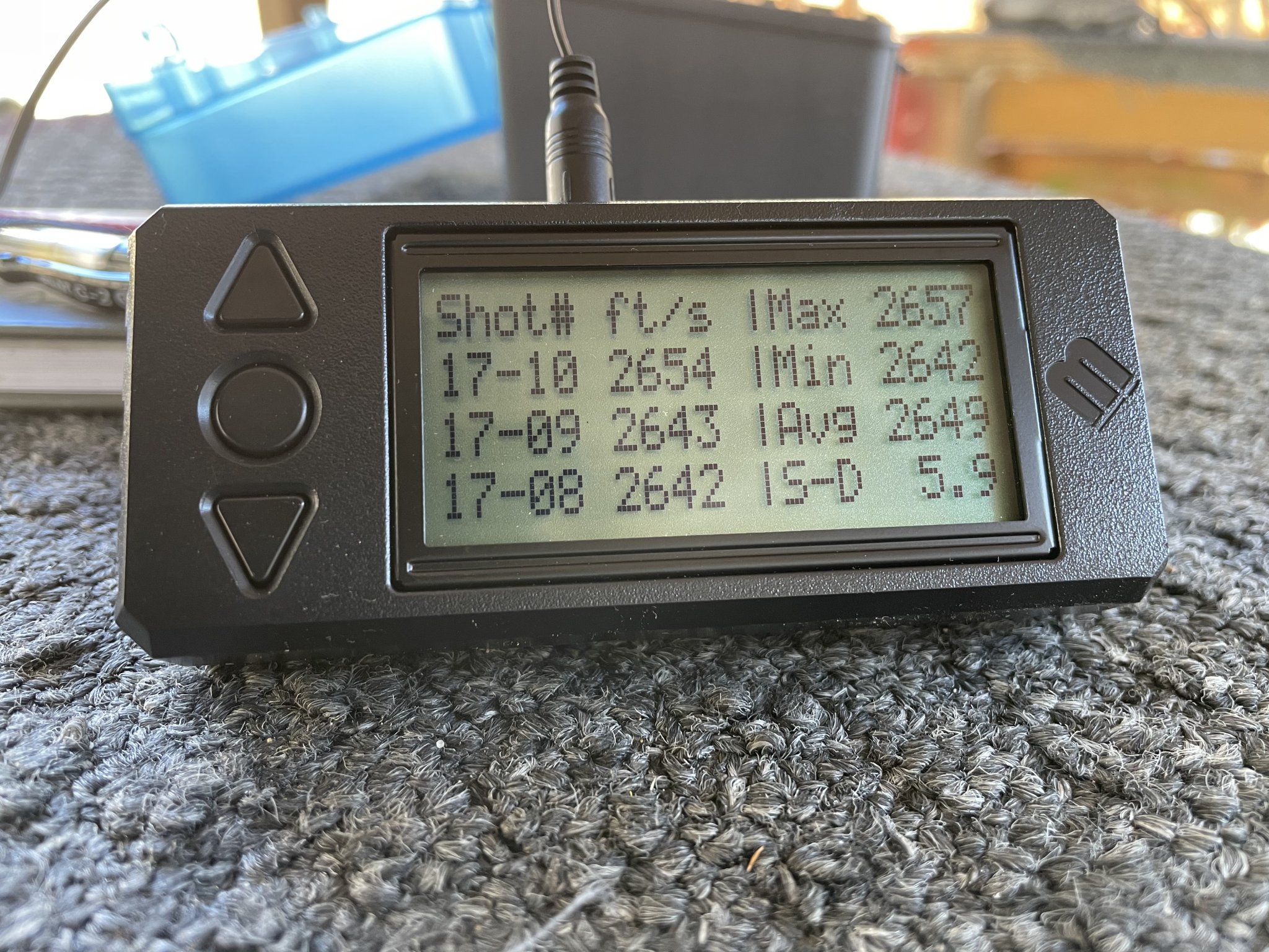

.308 CBC brass on about its 7th reload w/ V43.5 from a small Hornady scale and hand trickler. Sized w/ Hornady dies and spray lube. 210M primers. No extensive cleaning, weighing brass or neck tension routines. I don’t even clean primer pockets routinely if the hole is open. Not saying all the extra steps aren’t important in some circumstances or if you’re super OCD and need that to get off but I just do what works for my guns. These pics were a random day shooting recently to recheck velocities on this brass I’ve reloaded a lot. Even a shorter BTO than I usually use. This is out of a Savage APO I got for $600 on clearance.
