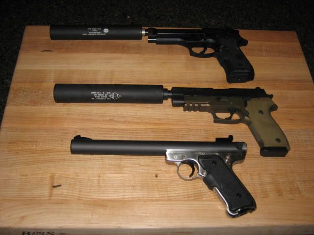

I love the Ruger at the bottom of the pic. It has a Gemtech full upper. It will not cycle subsonic well but regular full power ammo cycles flawlessly.
