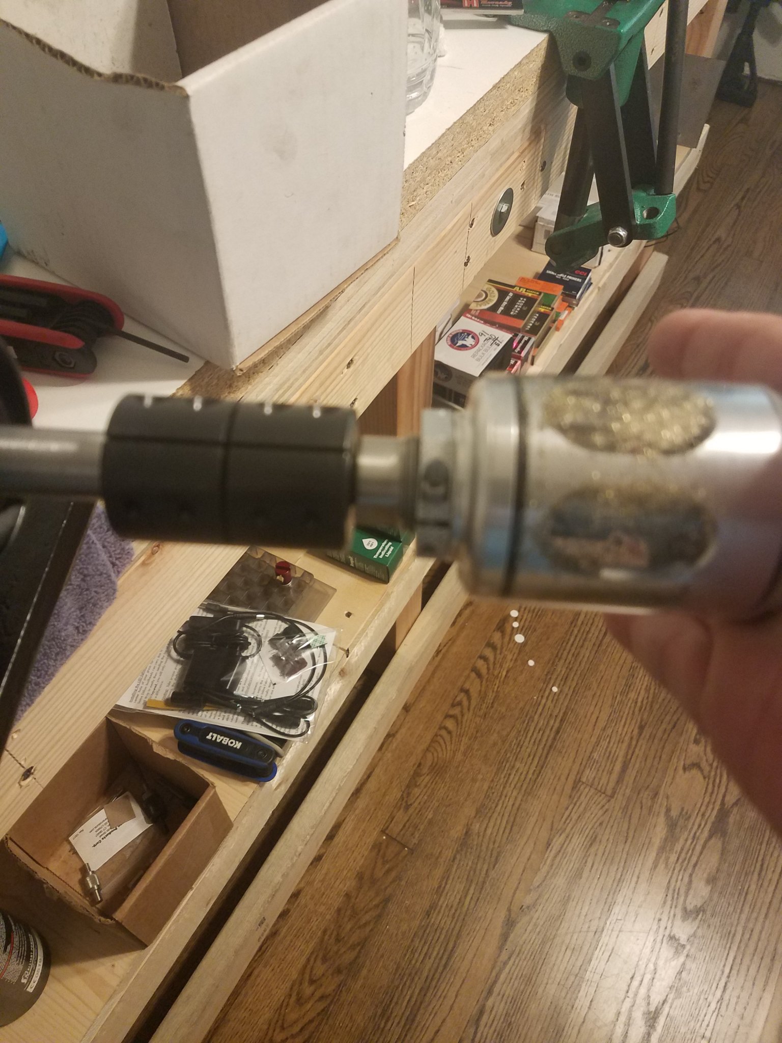

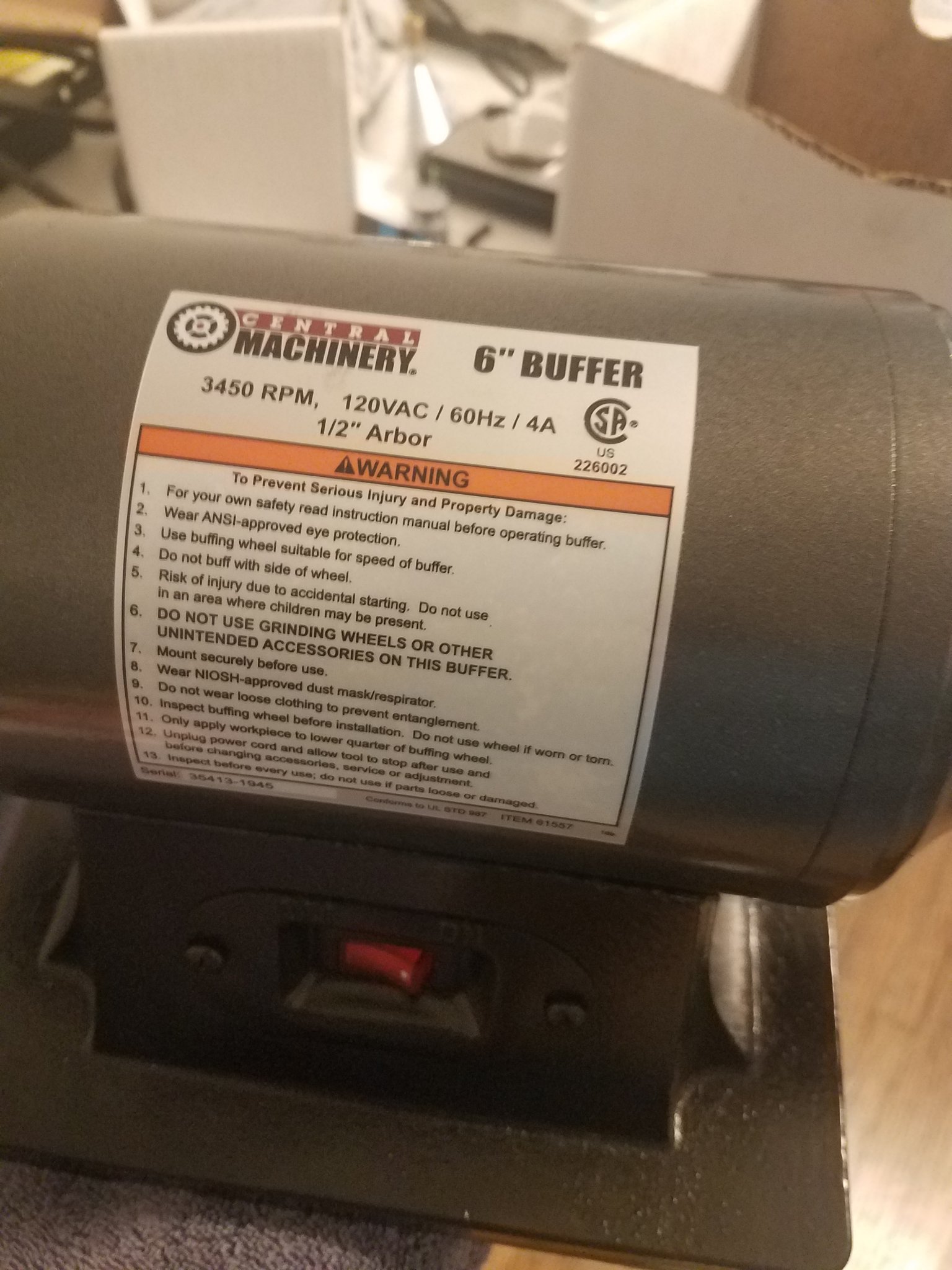

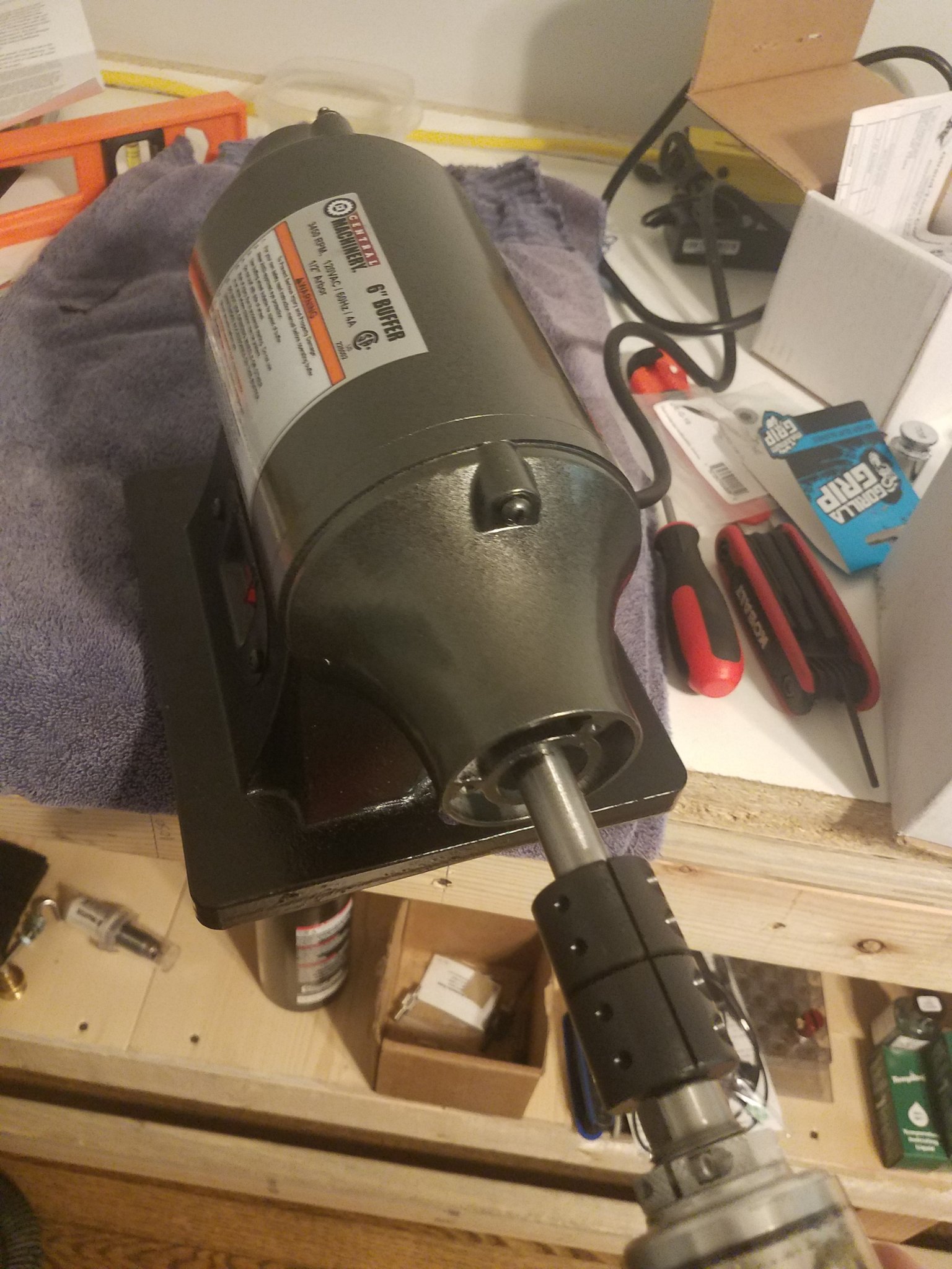

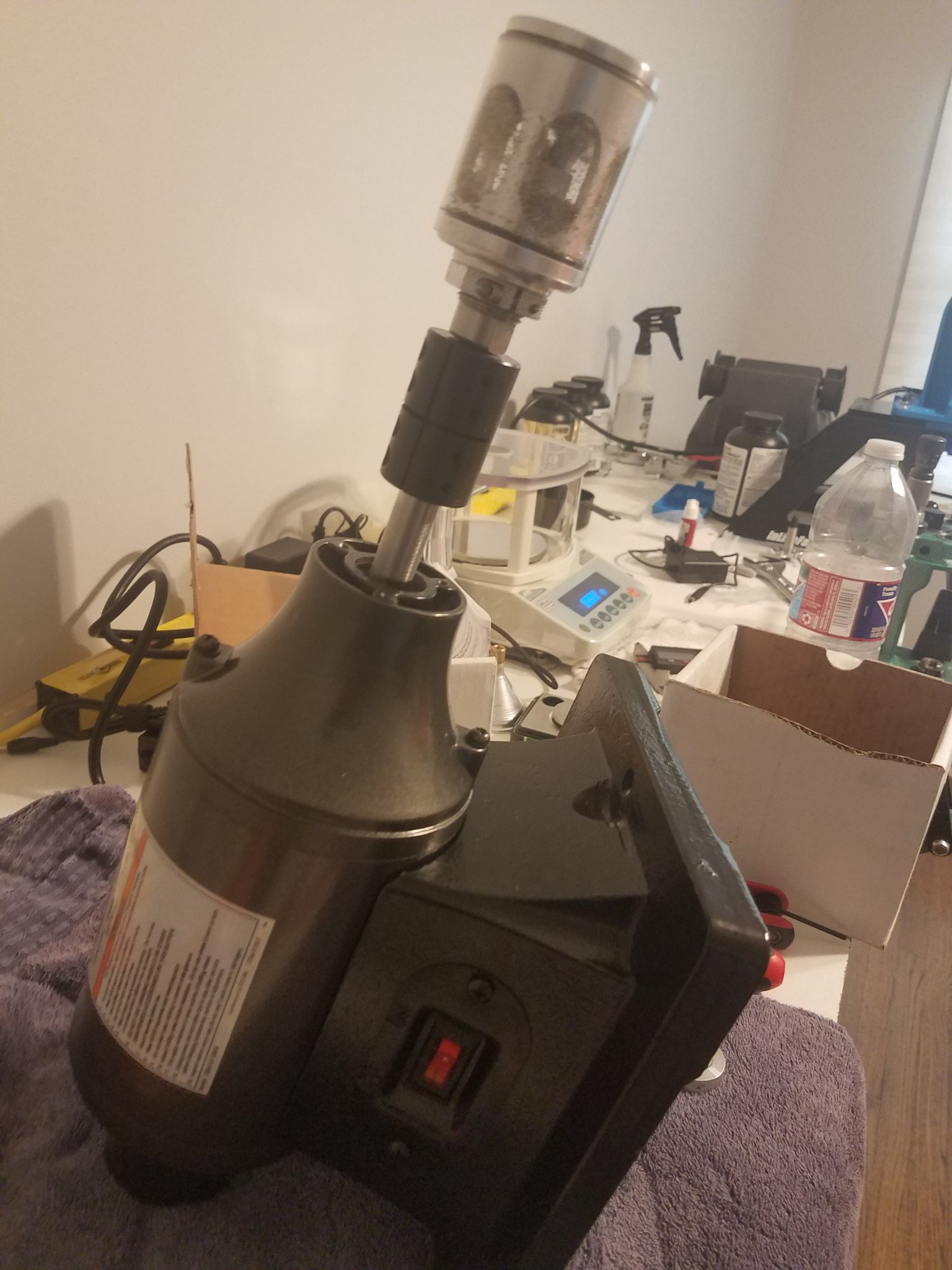

the giraud fashioned to a harbor freight bench grinder/buffer is the best I have had.
total cost $160 and will trim, debur, chamfer.
hard to beat in my opinion.
Get the tri trimer $105
Get a bench buffer harbor freight $55
Get a shaft coupler $10
Google search girard bench grinder
Lots of threads here on the hide too
Best trimmer available in my opinion and you can trim very fast.
Here is a few pics of mine

I like that stand A LOT!!!
easy way to make it stand alone and off the bench! Which is what I was looking to do.
It's a gamechanger. In the horizontal orientation on my bench the pegboard backer vibrated like crazy (which is what drove my dogs nuts.)
This way it's quiet, ergonomic, and mobile. Thrilled with how it works.
