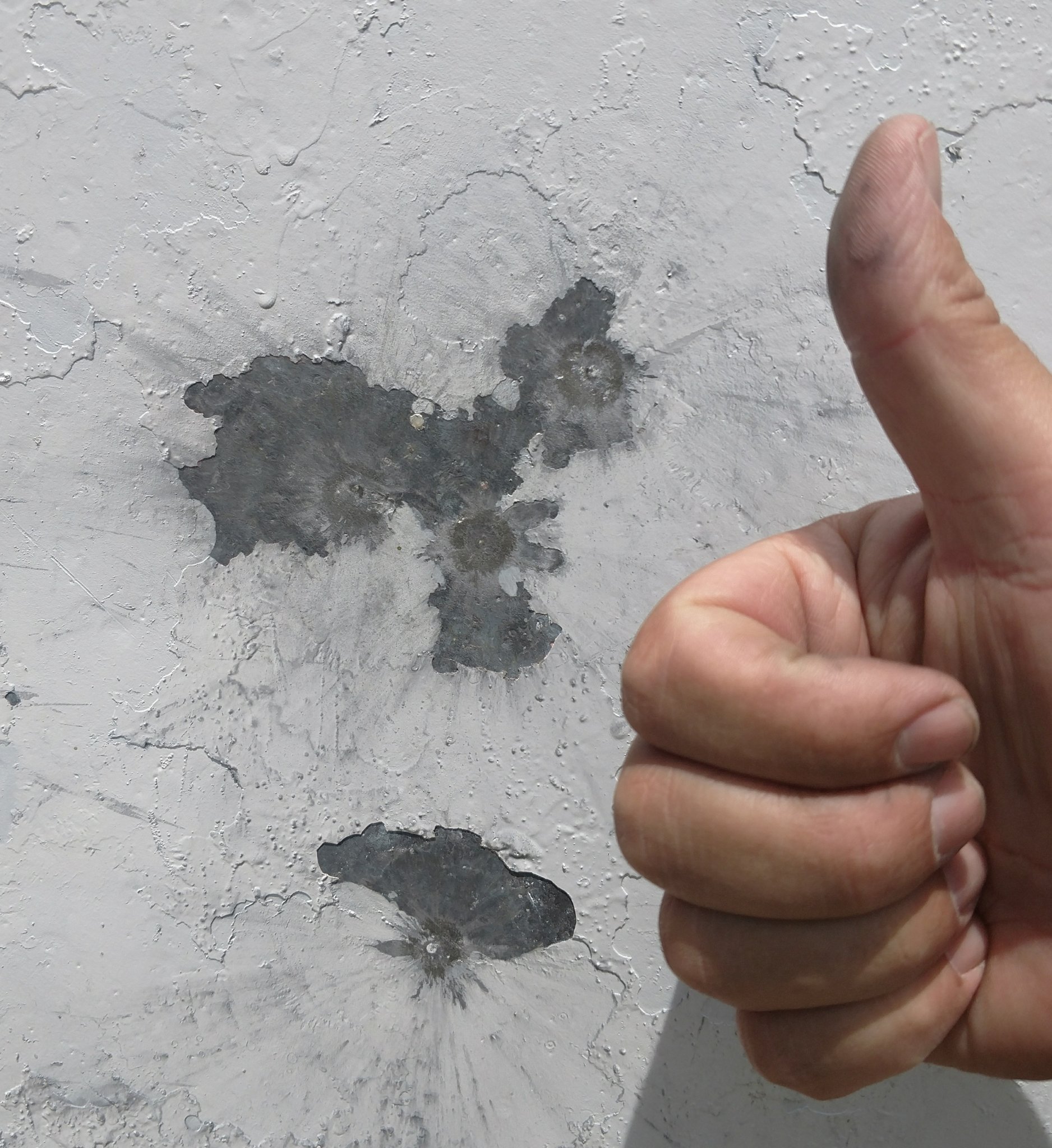

I run a 20" barrel in my DT with an ultra 7. I shot this 5 shot group at 1000 yards yesterday with it. This is the barrel I use to hunt with as well. I was worried about going so short, but have not been disappointed at all that I did.
