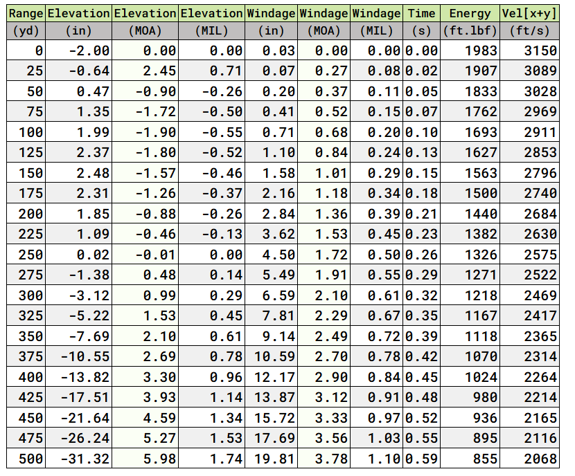

Go to a 100 yard range and zero at 2 inches high. That is enough time and distance to start correcting for windage and even the Magnus Effect at longer distances.
I don't know what particular flavor of .243 ammo you are using so I just picked one from Federal.
See the inches at 100 yards.
