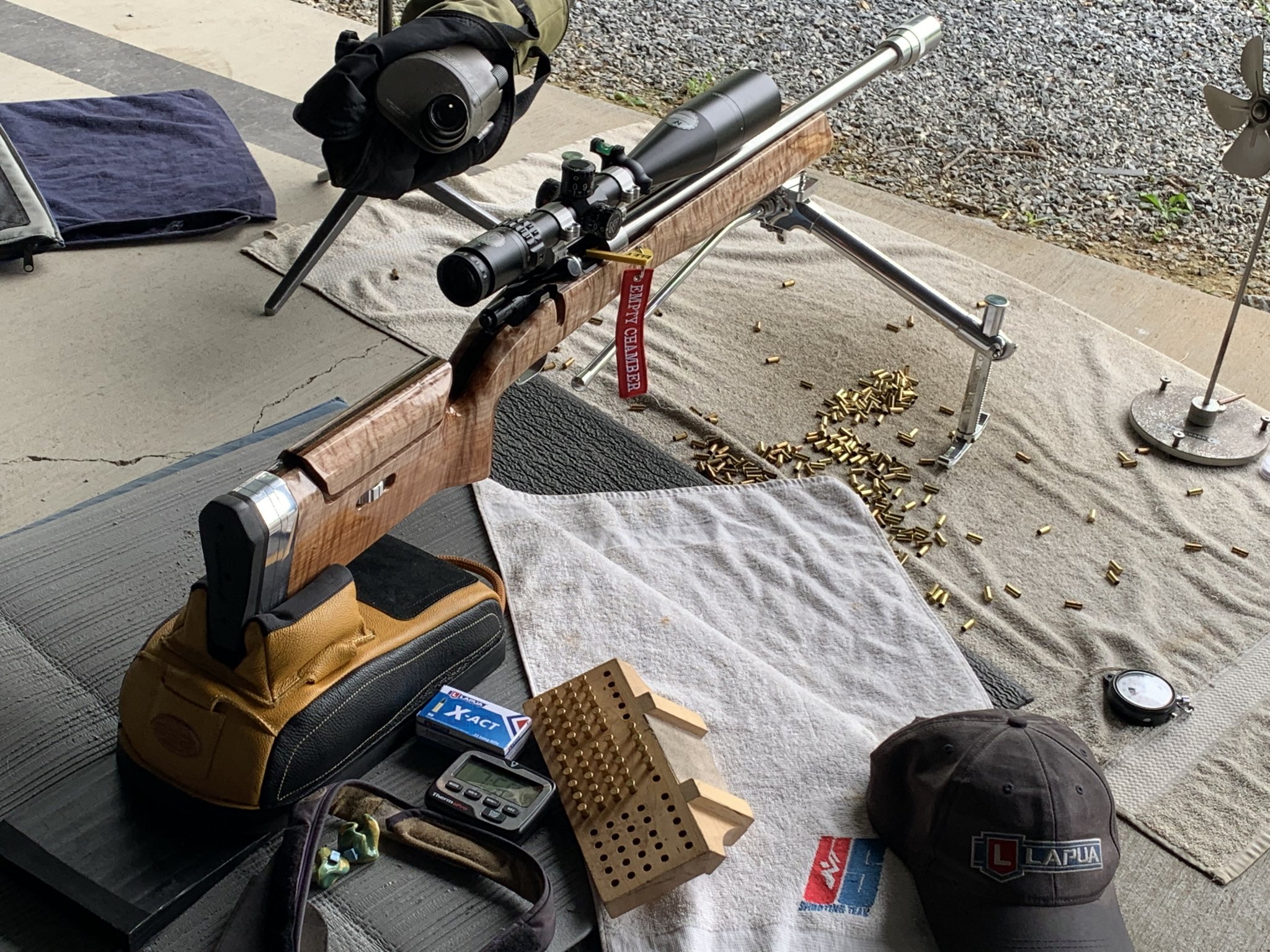

Simple, clearly visible from a distance and inexpensive. Never had a shaving in the chamber and this is one of the tightest match chambers you can have and still actually load the rifle. If you are getting shavings, the chamber flag is way too tight.

Must have been a cheaper made one or how they shove them in as I have run one in my Vudoo since 2017 and never an issue with the chamber. I used one this past weekend too as I couldn't find the magazine one but always have a few of the in chamber ones in my pack. Only issues I have ever had with them is their falling out. I think I will get the magnetic one next.
I have shot a Texas carbine match, 3 different PRS style rimfire matches and a USPSA pistol match a bunch. Never used or saw a chamber flag, but have seen a couple magazine blocks. I volunteered at a centerfire bench rest match a couple weeks ago and that was the first time I saw chamber flags being used.
The only down side to a chamber flag to me is the action has to be open. One of the matches we shot has a lot of sand/dirt and it was windy, bolt and action got a lot of dirt in them just sitting around. We ended up doing like we do at the pistol match, remove mag, show clear, close bolt and put it away.
