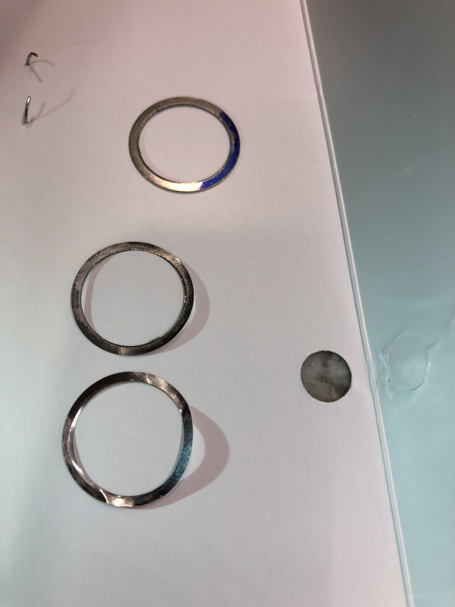

Do you have a clearer picture of the washers? I cant see what you mean by bent?
See below. Bottom one is in the worse shape. According to TBAC the brake only needs to be a couple thousands off in order for it to get off center. Keep in mind I’m shooting a 6.5 projectile through a 6.5 can and not a .30.

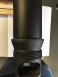

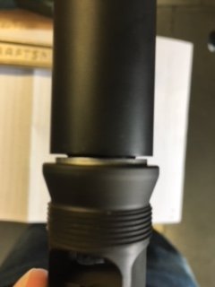

I am glad you figured it out. When the peel washers get really thin, it gets tougher to make sure they don't fold over when tightening them down. I personally doubt that extra loctite caused the problem, but I guess it's possible. It doesn't take much error at the shoulder to cause an alignment problem at the muzzle, IE, less than one thousandth off at the shoulder can cause a catastrophic misalignment at the can's exit aperture.
Typically when a brake is known to be on the build before the muzzle is threaded, while the barrel is in the lathe for muzzle threading, its shoulder is cut so that the muzzle device in question clocks with no peel washer. It is a really really bad idea to "clock the brake to the barrel" because that involves removing material from the brake and it is almost impossible to do this after the fact without screwing up the brake's alignment between its bore and the plane defined by the rear mating surface.
In this case, it looks like the barrel was already coated (paint on the muzzle shoulder) by the time the brake was installed, so using our peel washer would be the proper way to do it.
Hope this helps. I am glad you reached out to us. We deal with alignment all the time and have quite a bit of data on the most likely causes given any particular setup. If you or anyone else has any questions, please don't hesitate to give us a call. We read emails and get voicemails over the weekend and we'll get back to you for issues like this ASAP.

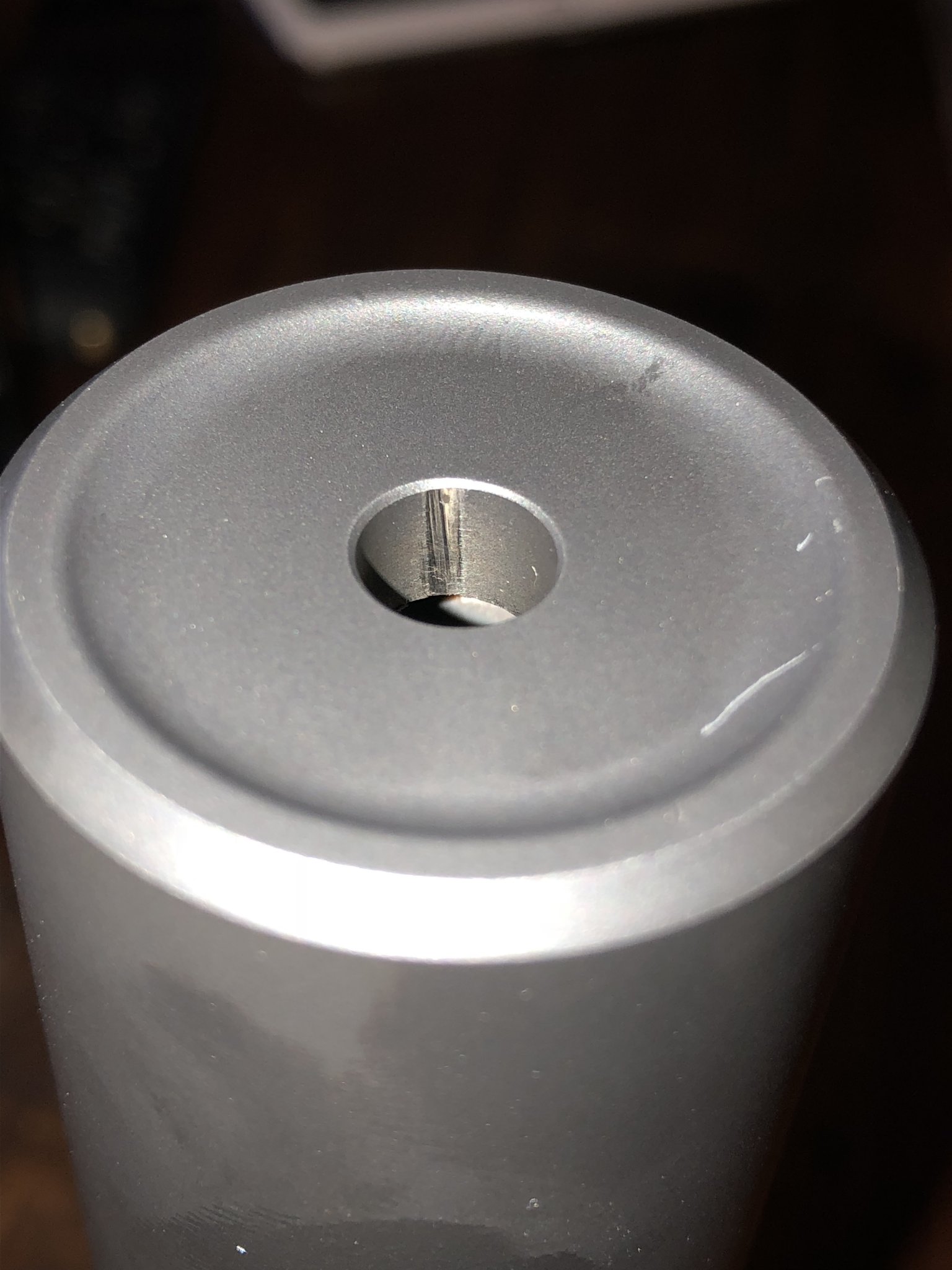

Well I thought my projectiles were not kissing the end cap. Guess I was wrong. Pretty close to ruining this brand new can. Is it safe to use copper remover on the can?

TBAC has a feeling that the culprit may be combination of the washers and the shoulder. Packaging up the barreled action and can and sending it to TBAC to get this resolved. Keeping fingers crossed for a quick fix. I have a hunt I was planning on using this rifle & can for.

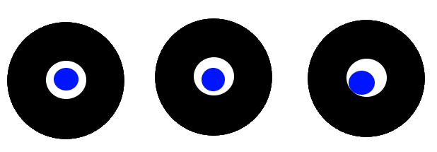

FWIW you can get 36" precision ground soft tool steel rods in various diameters +/- 0.0005 shipped directly to your door from McmasterCarr. A precision ground 36" 0.246" diameter rod is $6 + shipping ($10 or so, might as well grab a whole gamut of sizes for your other caliber rifles) a great addition to your kit for verifying the integrity of your barrel and suppressor interface.
I run the appropriate diameter rod down the barrel after attaching the brake/mounting device and suppressor just to verify. Run the rod all the way to the closed bolt face, it will be laying in the barrel and will easily indicate if you're clearing the suppressor baffles and endcap.
Interesting suggestion. So do you generally account for the difference between the bore (land to land) diameter and groove diameter when checking the rod clearance through the can baffles and aperture?
I think most suppressor baffles/endcaps have about 0.030" to 0.040" of clearance from their specified caliber, so a 30 cal endcap should measure something like 0.348" or so. For my 6.5mm caliber barrels I use a 0.2500" rod, for 30 cal I use the 0.2813" rod. When you run it down through the suppressor/barrel you'll immediately see if you have enough clearance at the endcap. It will either be nearly perfectly centered, close to touching on one side, or making full contact. See attached illustration.

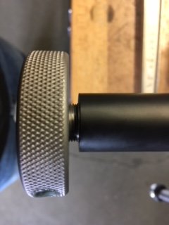

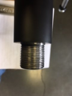

For those following TBAC received the barreled action and the can. After taking a look at it the conclusion is that they found that the barrel has no relief cut which is causing the brake to stop short of the shoulder (see silver ring close to the shoulder in picture 1). The threads have some taper to them, where they can get a mic in and they measure good but the go gage stops pretty short with a solid stop (see picture 2). Picture 3 is with the brake and no washer and is torqued, notice the gap. Picture 3 is the brake and a peel washer and is hand tighten to a solid stop. There is also a slight strike on the end cap of the can that needs to be fixed.
Reactions: PFG and character0
That will definitely cause problems. Thread tool retract likes to taper out. There should definitely be a thread relief groove at the back especially when threading to a shoulder.
I do cnc threading (non gun) as part of my day job.
