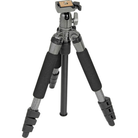

it looks to be the 190XB with the joystick head. i have the same thing and it works perfect from a fixed position but its a little heavy to carry around. if you need something to carry with you, look at the medium slik tripod. i think its in Tburks review.
