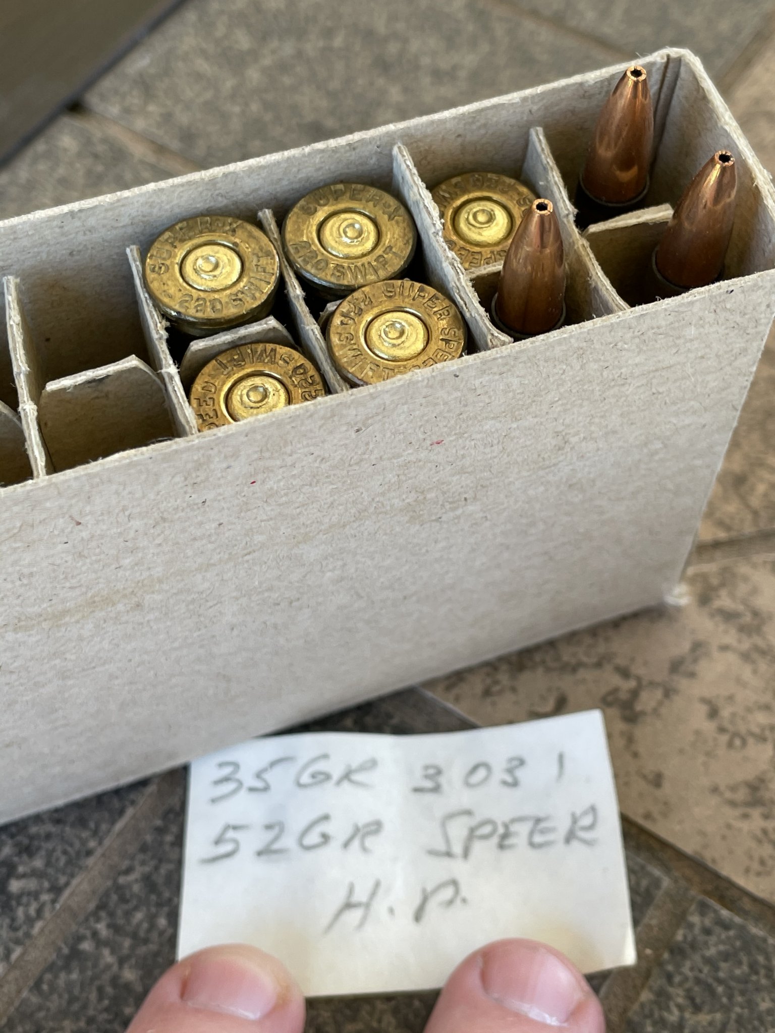

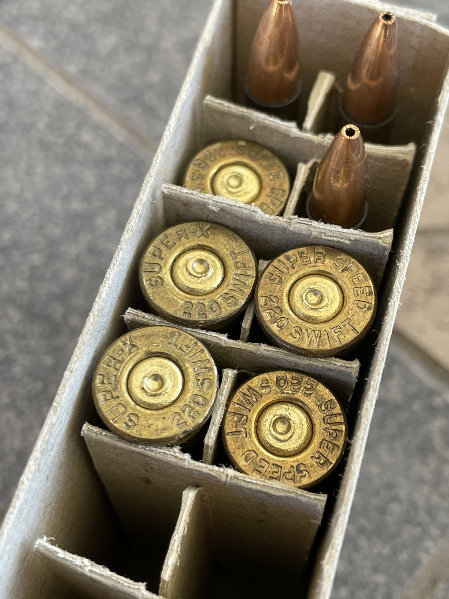

Thank you so much for the ammo. The 52gr hollow points are what I fired. 3800fps.... There was a recipe in one of the boxes...35gr of 3031 with a 52gr Speer.
I haven't tried the soft-points yet.
Keep in mind that those are somewhat “older” handloads. Probably done in the 1980s. 35 gr. Of 3031 would have been a very max load for a 55 grain bullet. And “warm” bordering on hot for a 52 grain. I can look up in my vintage loading manuals to see what max loads were.
However, today’s manuals are decidedly more conservative. Modern numbers from Hodgden have 3031 max load at 35 grains for a 50 grain projectile.
The manuals are definitely more conservative these days. I suspect the formulations are the same (ie better manufacturing methods have not produced hotter powders by some small margin). Instead, I think liability is the driver. Max loads being dialed back as a a margin.
So your primers may be showing some pressure signs.
FYI, normally, shooting someone else’s handloads... I’d pull bullets and just use the brass. But this guys notes that came with his ammo were so meticulous that I have no issue consuming them.
BTW, a lot of folks now don’t recommend 3031 for .220 Swift as it is a fast powder. But it is historically a very accurate powder in a Swift.
