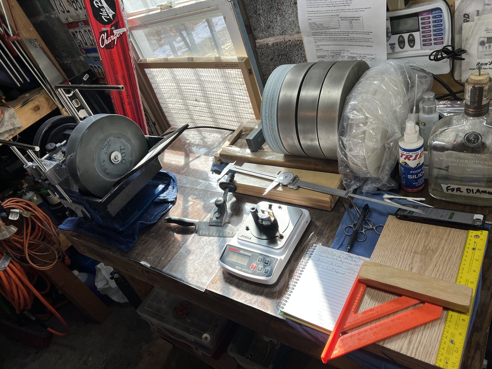

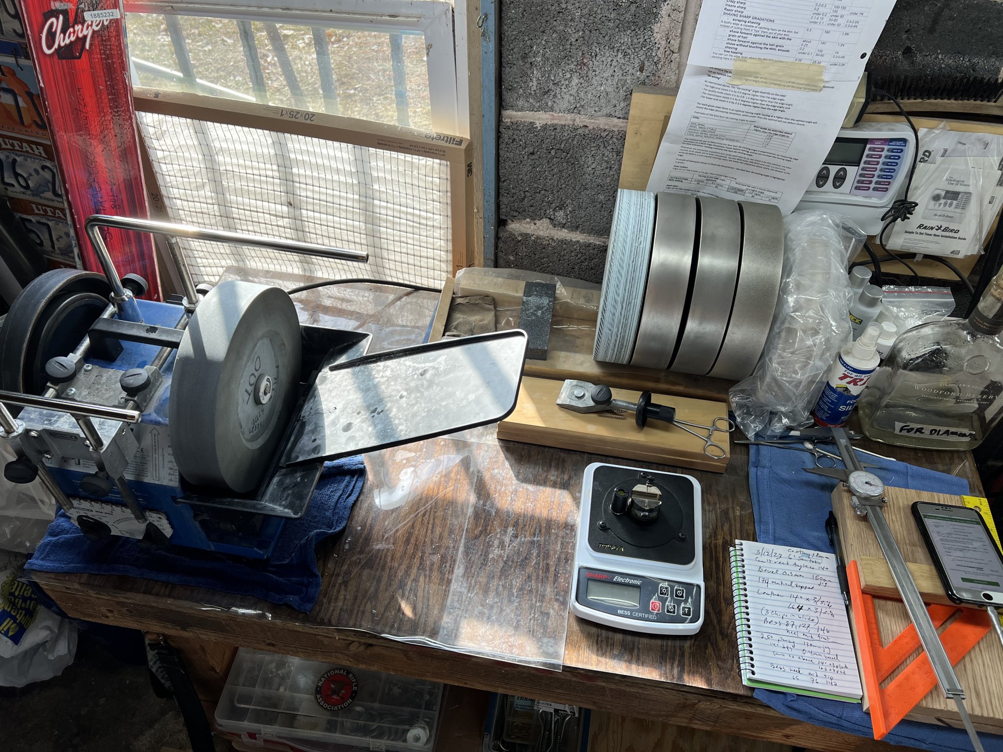

Sharpening knives is very similar to reloading in that you can get great results with some Lee equipment and carry-on. Or you can get super meticulous about it and spend thousands of dollars on Tormek and associated equipment just how we do with reloading and zero presses AMP annealeez, Triebel dies, Giraud trimmers, and what not. Which will make a far superior result to your blades (more so than a Zero press will to your reloads, IMHO). You will have to decide if it’s worth it and how far you want to go with it. With the Tormek, you can do drill bits, scissors, planer blades, wood chisels, and every other blade in your home as an added benefit - but the jigs are not cheap (Made in Sweden). None of the Tormek stuff is - because it's worth it.
Reactions: 232593
whatever you guys do, I encourage you to actually measure your results with one of these gizmos. What you thought was "razor sharp" is probably not as sharp as you thought it was. It changes everything. It's like actually shooting your ammo you reloaded to see how accurate it is
If you don't want to spend the money on this, I suggest this as a surrogate test (hair shaving is garbage): Push cut (no slicing, just straight pushing down) a cash register receipt. If you can do/cut that, you're near or less than 100 grams on the BESS scale, which is about 0.1 micron apex width.
Reactions: 232593
Are you competing in a sharpening competition?
I'm not sure what you'll gain by knowing how sharp your knives are. In reality as long as they're sharp though to work it's all that matters.
You'll have someone chasing their tail to put a steep razor edge on a steel that can't handle it, and it'll just roll quickly. I know, I tried. I prefer D2 tool steel for it's ability to take and hold an edge now. Before I knew better I chased my tail on a few pocket knives that were scary sharp for about 5 minutes and then were next to useless.
If you put on a proper edge on a blade, the edge will last longer - much longer. I’m not recommending a $1000 machine to sharpen a $5 pocketknife in a frustrating cycle of “tail chasing”. Personally, I adjust my sharpening process to the steel I’m sharpening, so I don’t have that problem - positive versus negative burrs, apex angle, secondary bevel etc.
The reason that you measure sharpness is so that you can make the necessary adjustments to put on a better edge. If you do like most people, and like I did for decades and get it to the point where it’ll shave some hair off your arm, then pat yourself on the back for your “scary sharp” edge, you won’t learn anything about putting on a truly good edge, which is much sharper than “arm shaving” sharp.
I offered advice on high end professional sharpening equipment, and a way to MEASURE the results. If you’re not interested, carry on. If your ammo is “good enough” with Lee equipment and a torch with a spark plug socket attached to a drill, I’m not going to try to talk you into a Prazipress and an AMP annealer. But I can point out that they’re available, can’t I? Or is the motto:
“If ignorance is bliss, then ‘tis folly to be wise.”
Reactions: 232593
