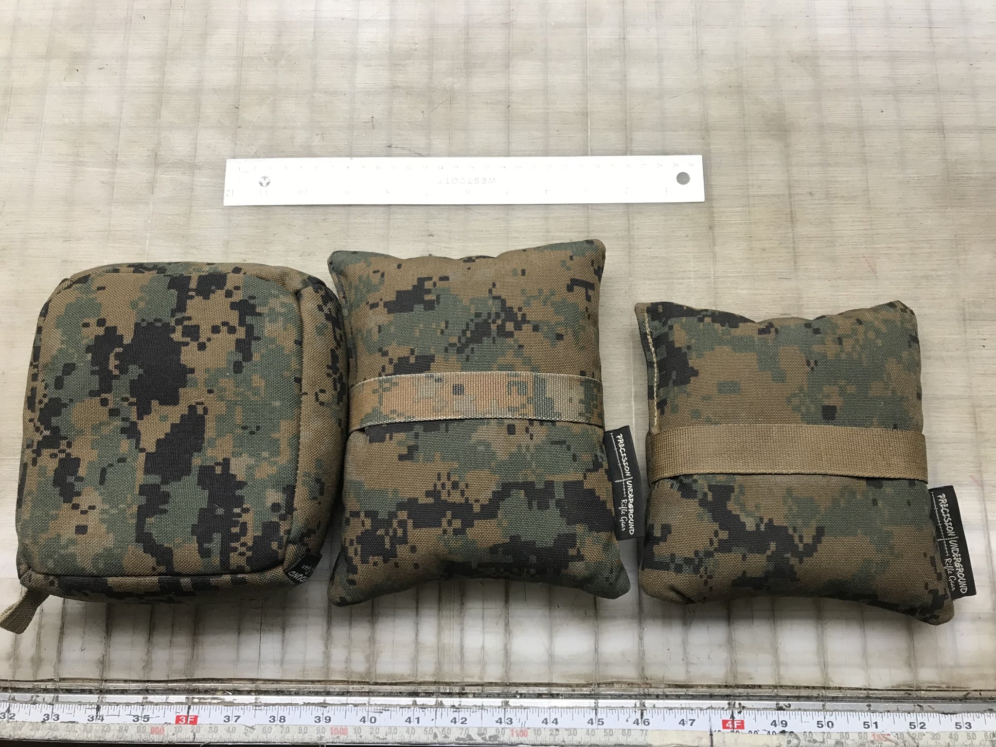

I bought two others of their rear bags - a large and small, figuring I'd experiment to find what suited me best.
When Frank helped out with the ELR Pro, I first wondered whether it could really do anything the other two could ... lucky I decided to check, as (in practice, at least; haven't checked the actual dimensions) it's width is about the same dimension as the short, and the height is about the same as what I was using on the large ... in other words, for me, the ELR Pro replaced two bags with one. Gold!

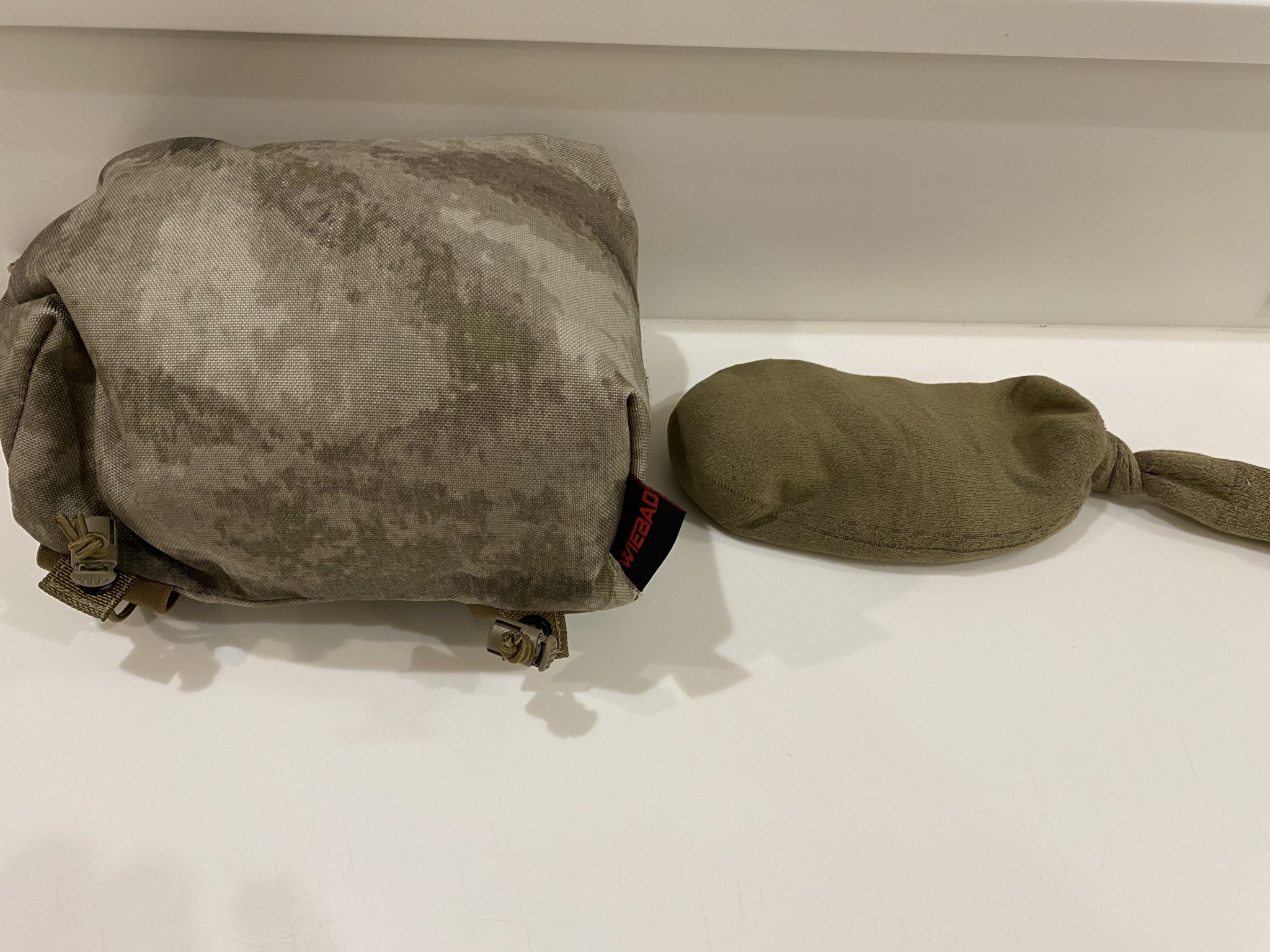

I was weaned on sand / pea chick rock in my OD duty socks, still my favorite. Don't do competition applications. For a long time now I use small polymer beads for fill, sand get's wet etc, and it's a new mess. A Wiebad bag is used from time to time.
