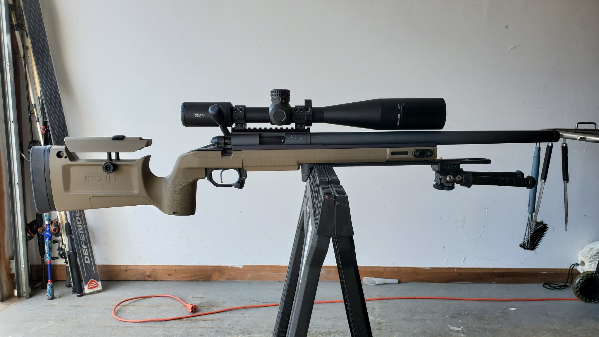

MPA BA 1.250” 34mm mount, 20moa Vudoo rail Razor gen 2 4.5x27View attachment 7466169

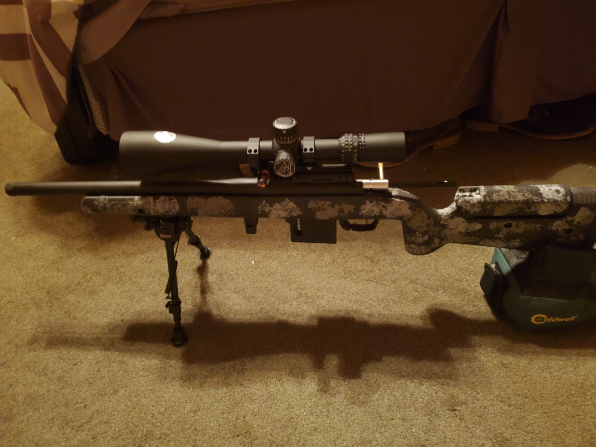

Night Force ATACR 7-35 on 30 moa rail, and 1.125” ring height.

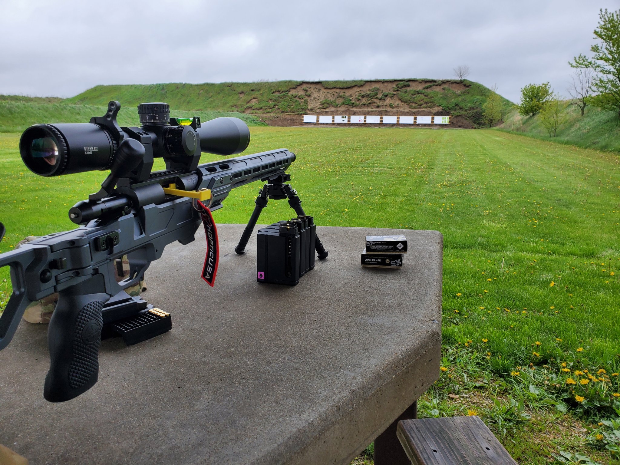

OK ... Made a change. Still a 20 MOA rail but went Razor in a Shuhr at 1.18" and 6Mils (20.6 MOA). Height feels (and looks) right and I should have a ton of travel for reaching out there. Laser zeroed at less than 50 yards with no issue. Will shoot it soon ...
OK ... Made a change. Still a 20 MOA rail but went Razor ins a Shuhr at 1.18" and 6Mils (20.6 MOA). Height feels (and looks) right and I should have a ton of travel for reaching out there. Laser zeroed at less than 50 yards with no issue. Will shoot it soon ...
3x18 ir 4.5x27?
It's the big boy! 4.5-27x.
Let me know if you run into any parallax issues. Debating between the 3x18 vs the 4.5x27. If I wasn’t married to the ebr7 and had a 4.5x27 on my nucleus I’d go another way.
I have the same scope on my TRG and have been very satisfied with it and is the reason I changed out the Cronus and NX8 I had tried previously. All have worked fine but there is something to be said for "sameness". I actually might get one more. I will keep an eye on the parallax as I site it in over the weekend.

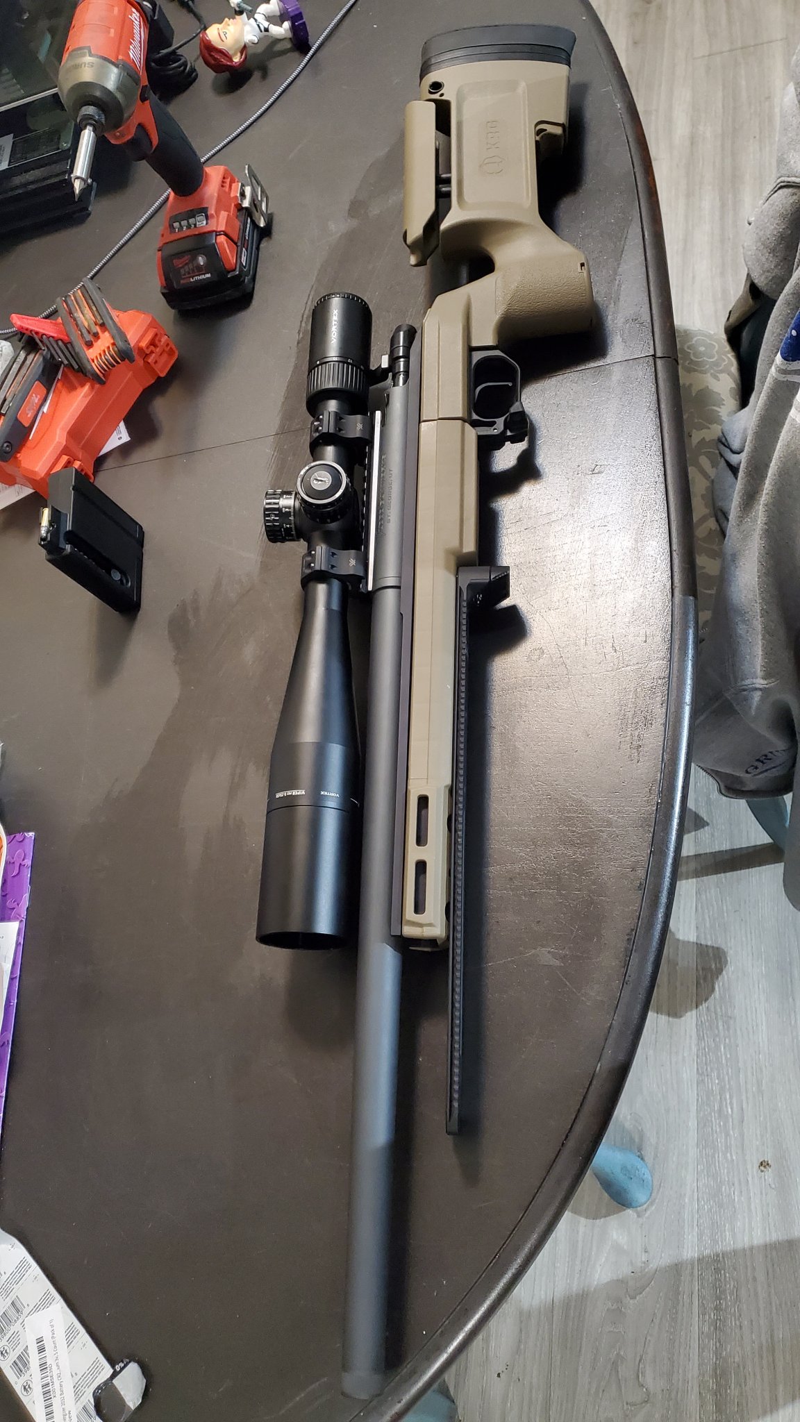

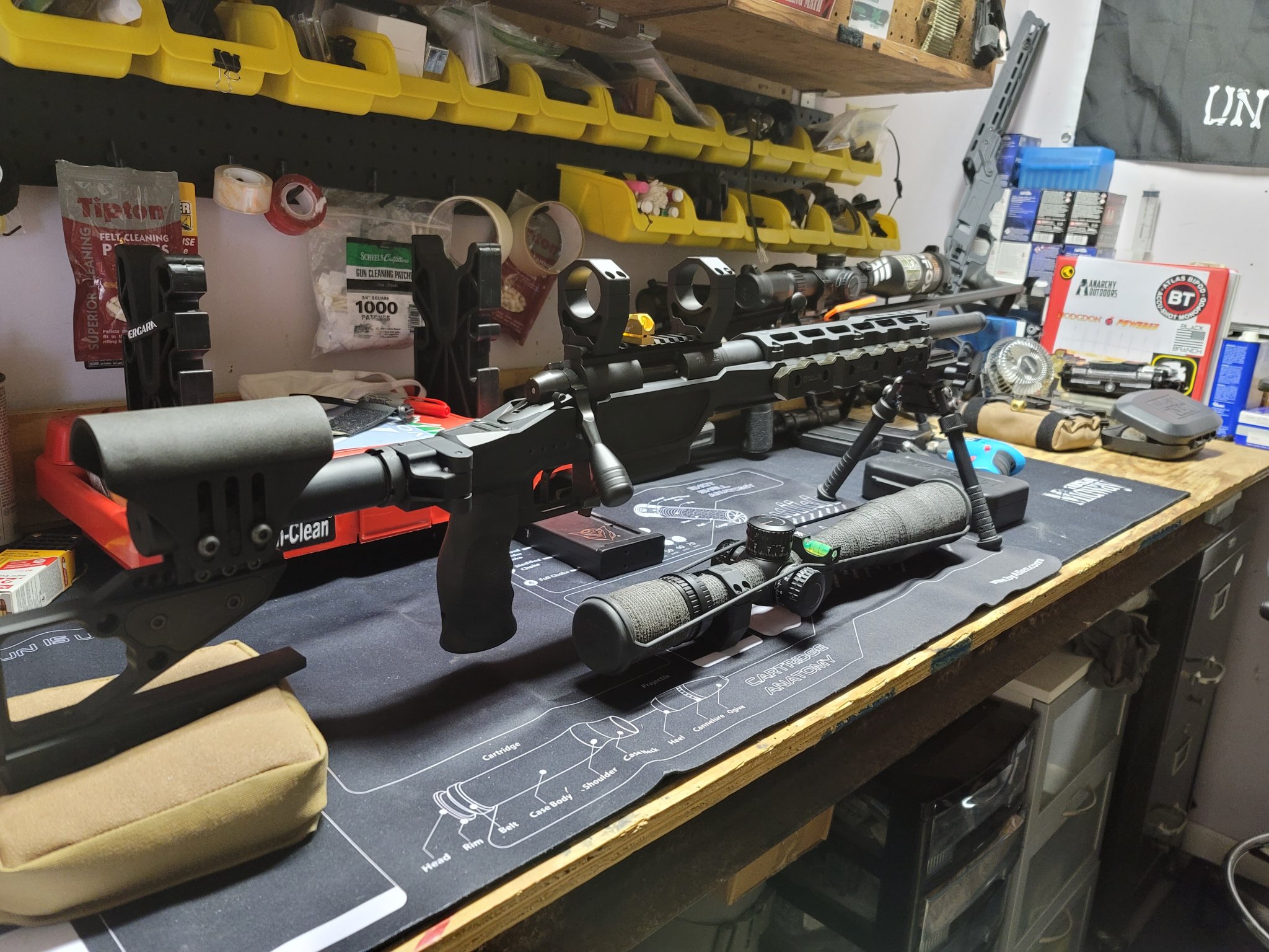

My current RH Vudoo in a Cadex Lite Competition Chassis with Vortex PST GEN2 in Vortex Precision Rings 1.45 on 30moa base
Next build I'm working on is LH Vudoo in a XLR Envy Pro chassis with Razor Gen2 4.5-27x56 in 1.45 rings / 30 MOA base.
(The first pic is me playing musical chassis and throwing RH V22 in the envy chassis with the 34mm rings....I'm still waiting for the LH BA and the razor)

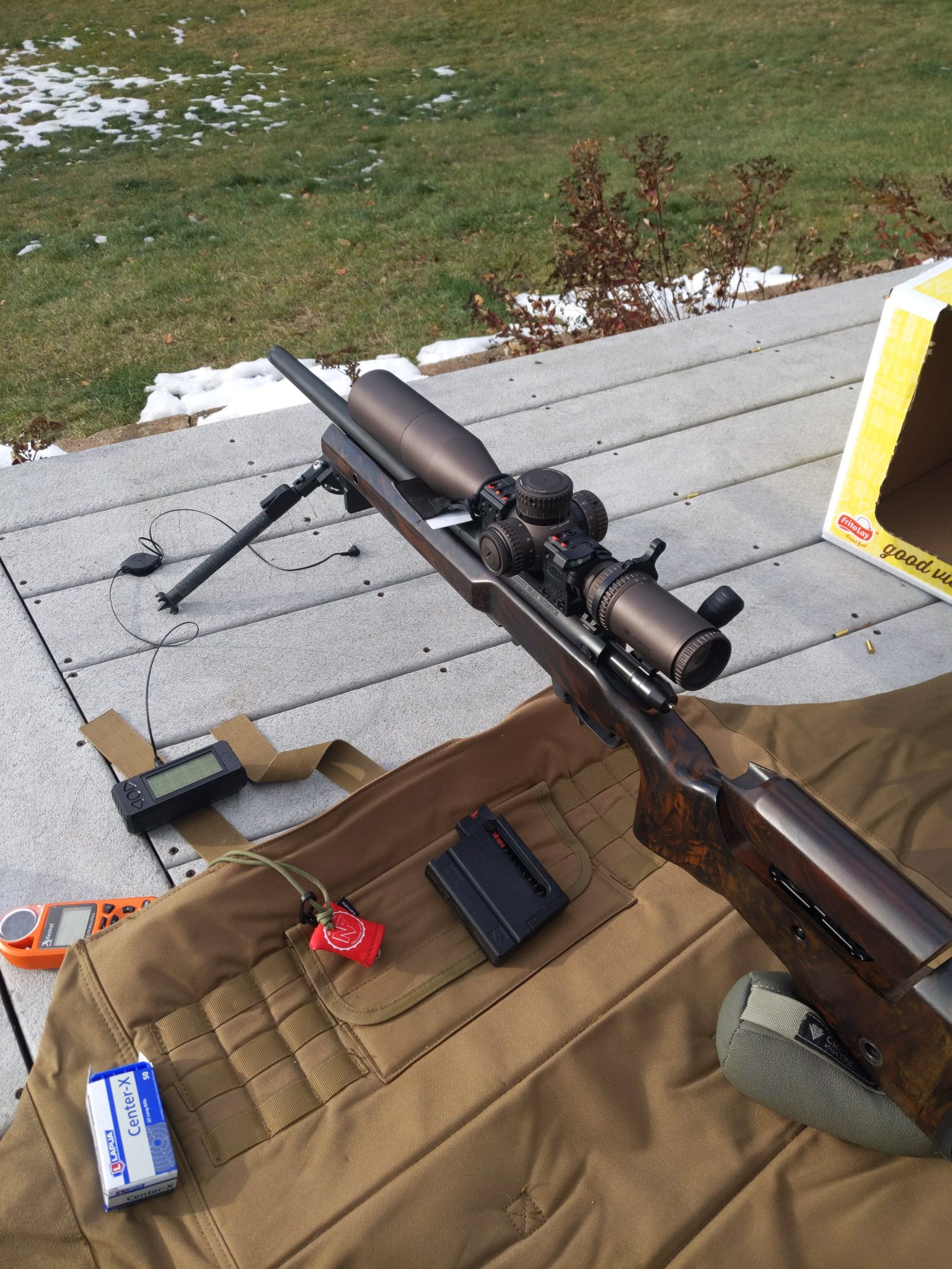

PST Gen2. 40moa base. Low Vortex rings.View attachment 7465864
IamJoeHo, how much travel do you have left in your pst gen2 with the 40moa base? Are you able to zero at 50y still and have no shadowing? Im having a hard time finding anyone with 40moa and pst gen2...about to order a nightforce 40moa base, vortex couldn't answer my question...thanks in advance
I have 26+ mills of elevation on a 40 moa base. 25/50 yard zero is no issue. I have no shadowing.
Reactions: sneakyman
Thanks much!!!! That was the fastest ive ever gotten help!!! I was pretty surprised when vortex couldnt answer...thanks again and shoot straight good sir!
Currently i have razor with ADM 30MOA one piece recon mount with 30MOA rail. 60 MOA total plus whatever elevation travel is on razors. Zeroed at 50, but i do see the shadow in the reticle which is only visible at lowest power.
Thank you sir! Vortex did tell me that they custom milled a 57moa base for an employee because that was the "optimum" moa base for the razor...not sure what gen, seems to match your experience, that last 3moa is probably ly causing a little shadow. Very interesting...if i were vortex id make a 57moa base for the razor!
