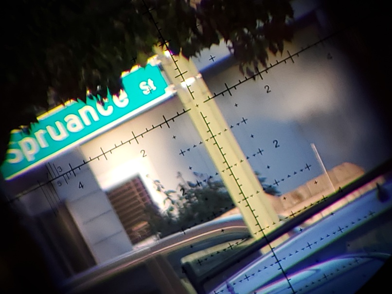

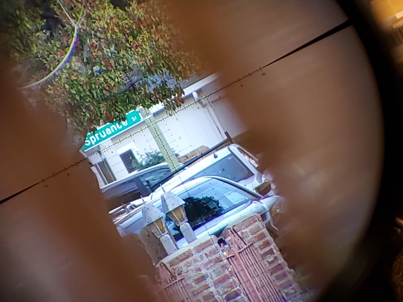

I've considered getting an XTR3, but I prefer a floating dot center vs the + center that the three reticles available to the XTR3 have.
I agree with you but that + on the burris seems way smaller than the coss on the cronus it looks like from the pics anyways.

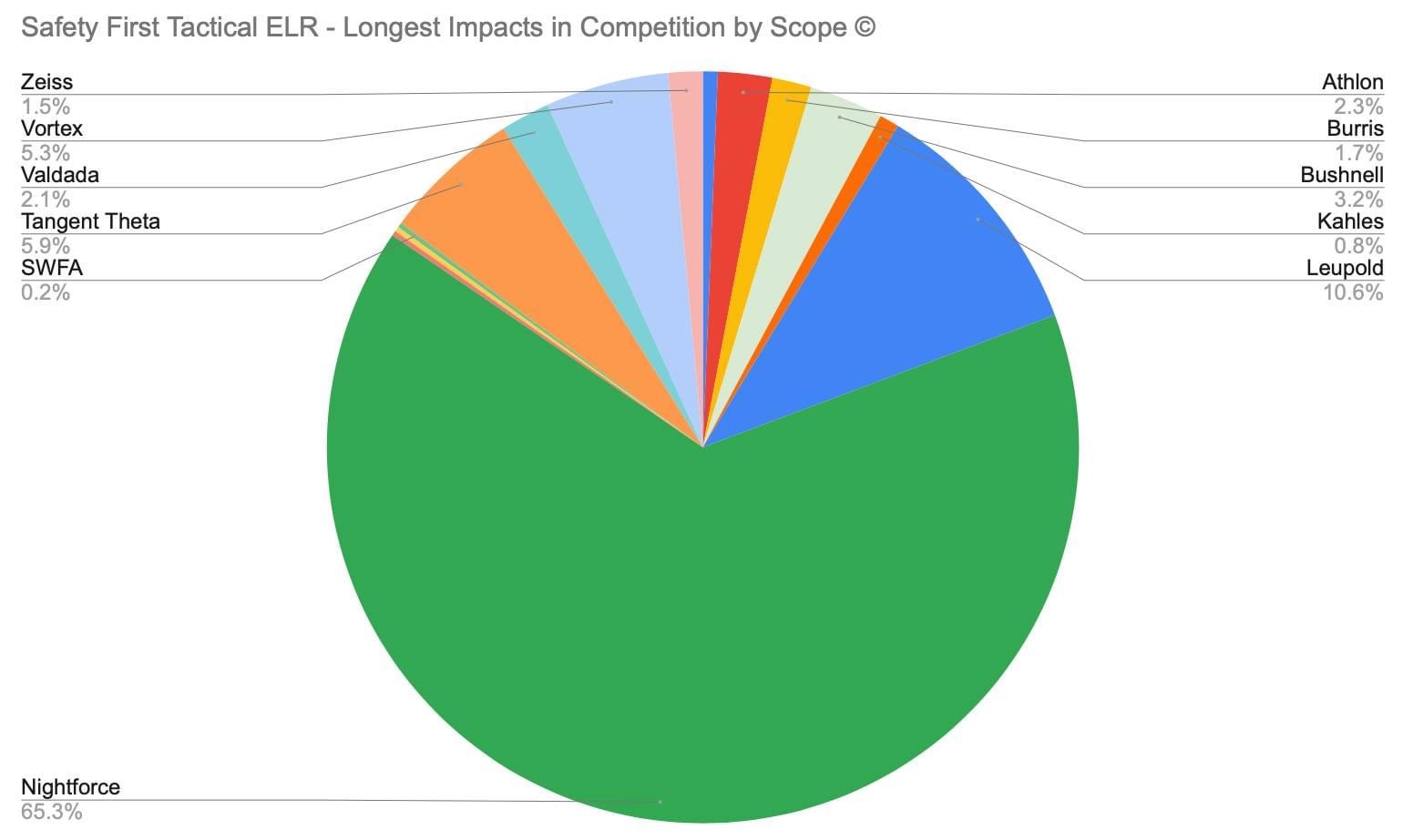

Brian Wink does extensive research on everything ELR.
If you zoom out a little it looks like a dot. Its 1mil across with .5 mil gap around it.
How is that cross compared to the cronus btr if you ever had a chance to see it? I hated the cross in the cronus btr
Never seen a cronus but I have an Argos BTR on a semi gun that I can pull out and compare later.

So the cross is very small
Argos doesnt have a floating X.
The XTRIII reticle. Not a representation of picture quality as trying to take a picture with a phone through a scope is stupid difficult.

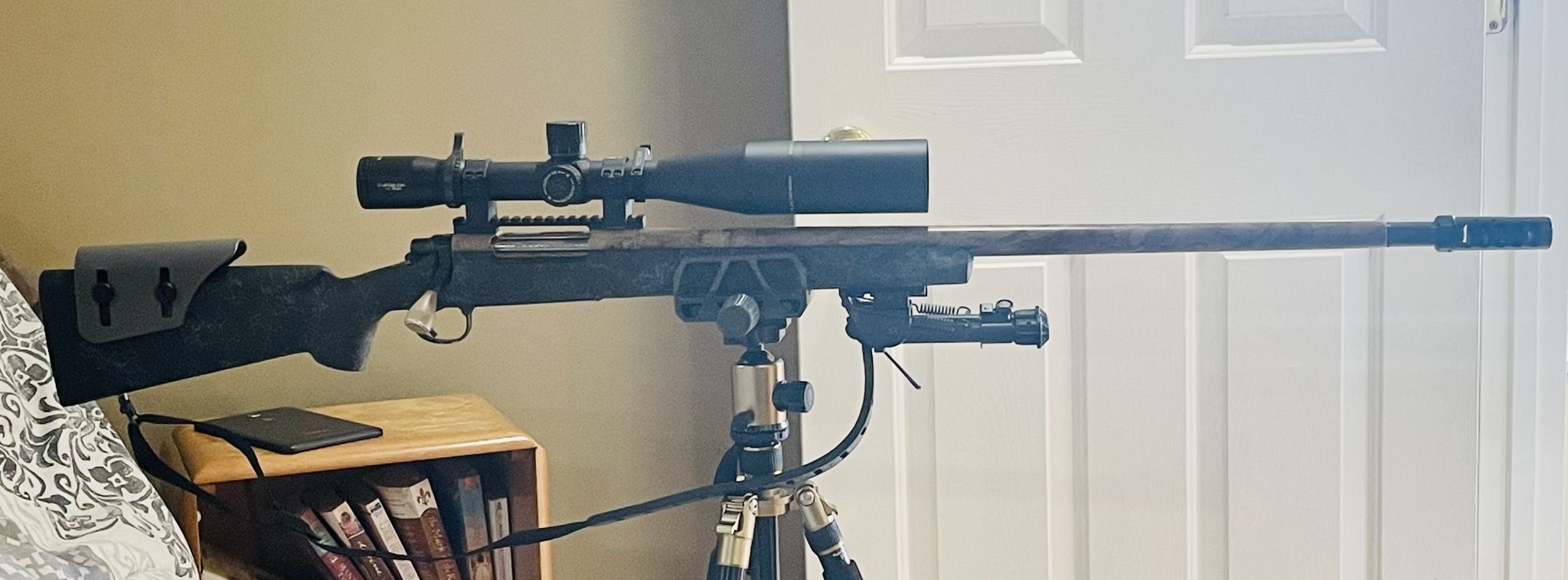

Tangent Theta on DT SRS
and ATACR SFP on DT HTI 375/50 BMG
Honestly for the work I do, all long range, I wish I had not gotten the TT and stuck with the SFP ATACR.
