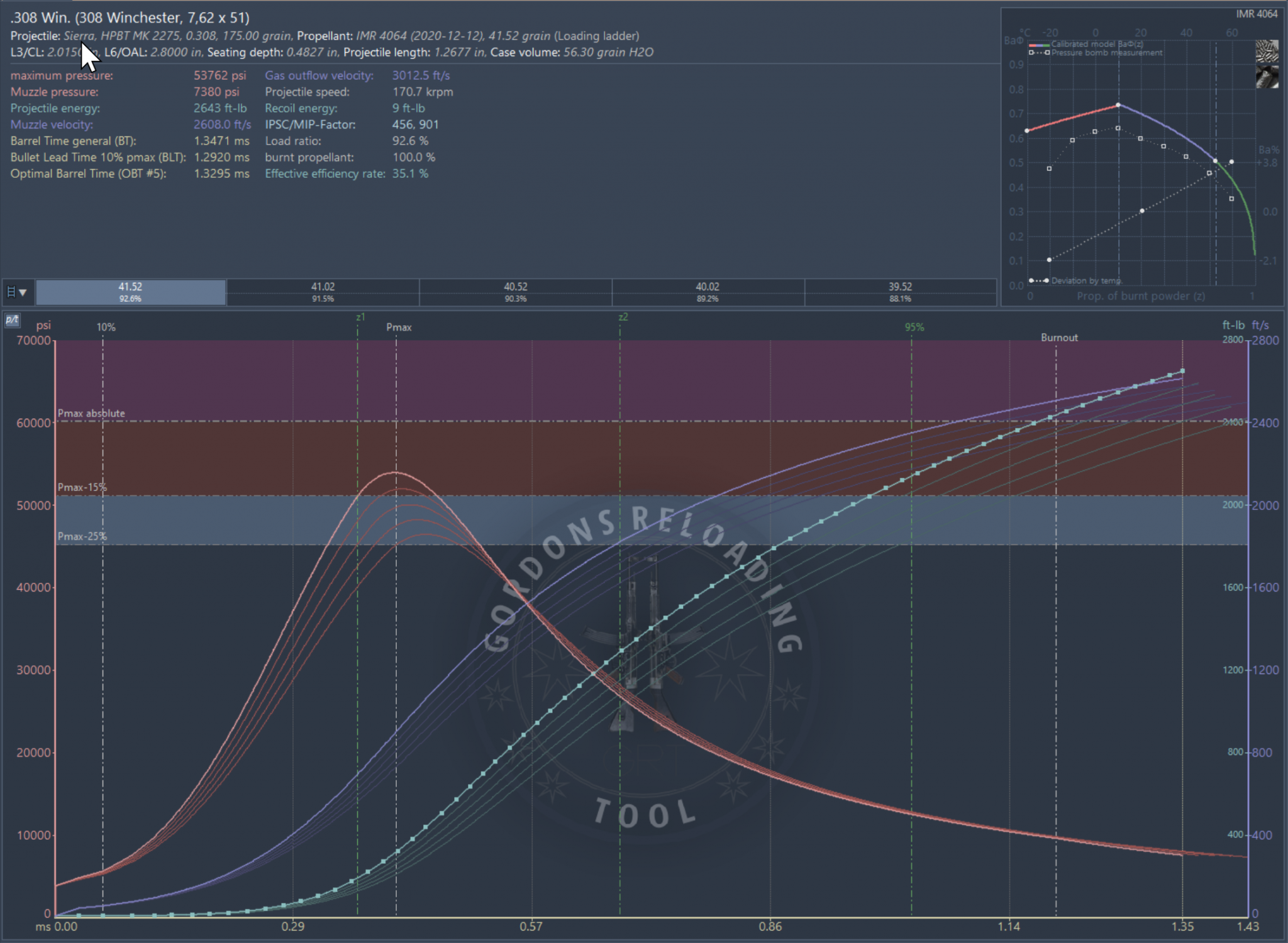

According the Gordon's, 308 with 41.52 grains of IMR 4064, Sierra 175 SMK from COL 2.700 to 2.850 in steps of 0.025 in.
The purple line is velocity - note, velocity is not linear over time so using average velocity to model barrel time doesn't work.
cartridge length / barrel time (ms) / max pressure (psi) / bullet lead time (ms)
2.700 / 1.3063 / 58696 / 1.2484
2.750 / 1.3270 / 56117 / 1.2701
2.800 / 1.3471 / 53762 / 1.2920
2.825 / 1.3570 / 52659 / 1.3030
2.850 / 1.3668 / 51602 / 1.3142
As the cartridge gets longer (that is, there is more space in the case and the bullet gets closer to the lands) the max pressure drops by 13% and barrel time increases by about 60.5 microseconds or about 4%. Time spent in the lead increases by 65.8 microseconds. It appears that the barrel time is inversely proportional to peak chamber pressure. FWIW, Gordon's muzzle velocity estimate is about 100 FPS low. Gordon's is not the only internal ballistics modeler but it isn't terrible.
You assume that with a long jump the bullet hits the lands at some high FPS. I do not think that is how it works. If you have measurements for internal ballistic velocities, please post them. If you are relying on some authority, please post a link.

Look at that. Long cartridge equals more time in the barrel. What you have posted directly supports my statement. Thank you.
Long cartridge = more barrel time cause it’s slower. In his example he held the same charge weight for all load lengths. 13% less pressure for the long one = xxx? Slower MV = longer barrel time.

Don't take this next statement as a condemnation of GRT or QL because my opinion is that they are still very useful models for playing with wildcats and estimating effects of changes. However...
Here is the thing about using models like GRT or QL to try and get details like pressure/velocity versus seating depth and thus making conclusions about OBT theory.
If you actually test the effect of fine seating depth in a sweep while holding the charge constant, the velocity drops with deeper seating depth, it does not climb. It goes counter to the model and counter to many opinions on the internet.

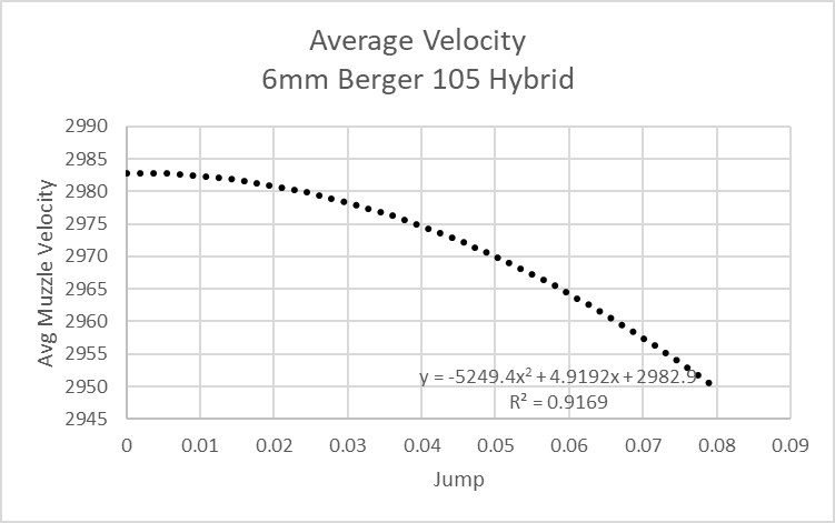

Here is an example of a Dasher with a wide seating depth sweep that goes from touching the lands to 0.080 deeper. Notice the velocity is not increasing and is in fact dropping from 2980 down to 2950. Try it yourself. YMMV
Increasing jump beyond ~.010 has very little reduction in pressure the further away you get from the lands. If one is within that zone and as one increases jump there is a significant reduction in pressure. The statement that "increasing jump tends to reduce pressure is true, but it's not as though it's some kind of linier reduction; it just depends on where you're reducing the jump from.

ive found the same...holding everything the same except seating depth, the deeper a bullet is seated (more jump), the more velocity bleeds in everything ive tested it

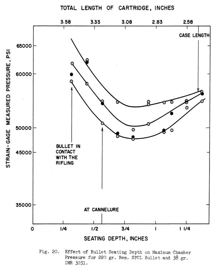

Now....why does velocity decrease?
I suppose it could be that a portion of the explosion is now able to slip by the projectile before a good seal is created against the bore.
I finally found what I've been looking for for a long time in that 1965 Lloyd E Brownel's report that MarkyMark07 posted a link to. It better helped me understand why many competitive shooters like to seat their bullets into the lands as well as what's going on with maximum chamber pressures changing (as you've described) with seating depths.
I've always wondered if there was enough blowby along with increase in chamber volume to override Boyle's Law effect for increased seating depth lowing case volume for more pressure . . . as QuickLoad and GRT illustrates. It's very apparent to me now that it does, but only within range of possible seating depths; though I'm sure the design of a bullet and the chamber have a big influence on what the range looks like.
Here's a graph and the part of that report that pretty much says almost all I need to know about it as a precision reloader:
Now recognize just how far off the lands you have to be for pressure to increase.
It flattens at only half an inch off the lands in that super graph. Good luck doing that in most rifles. Most rifles even compressing powder can’t.
Pistol the seating depth has a large effect on chamber volume behind the bullet and has much larger swings. Rifles with their small bullets and big cases have a much larger ratio of volume to overcome.
