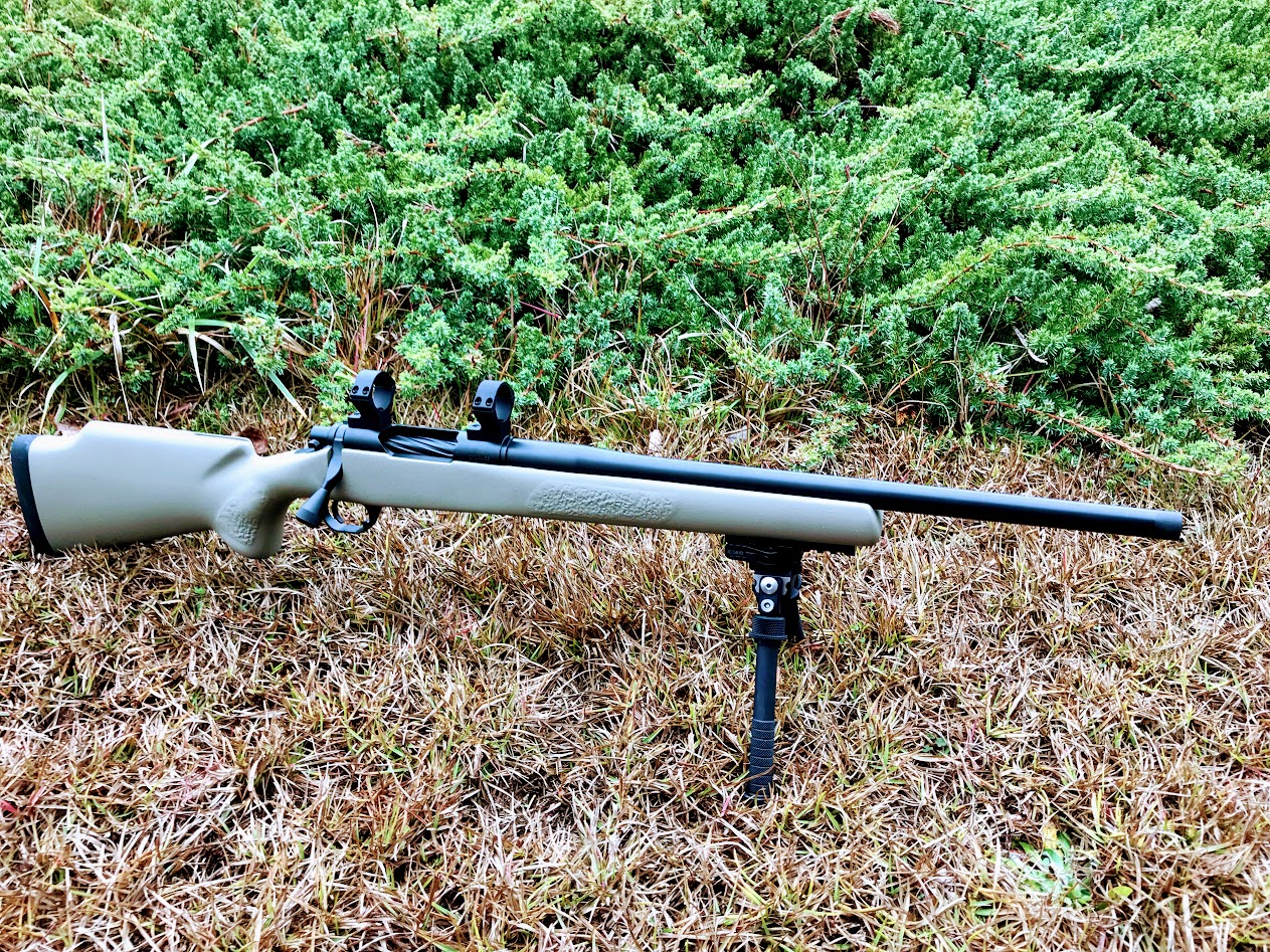

Not even close. The butt of the Game Stalker doesn't resemble a McMillan Hunter and the forend is a lot larger than a Remington Classic. The forend is about the size of an HTG, it may be an HTG forend.
From what I was told the McMillan Rem Hunter and the Game Hunter were combined into the Game Stalker....From McMillan website.
Game Stalker:
Forearm Width = 1.86"
Butt Width = 1.99"
Grip Width = 1.62"
McMillan Hunter:
Forearm Width = 1.5"
Butt Width = 2.0"
Grip Width = 1.79"

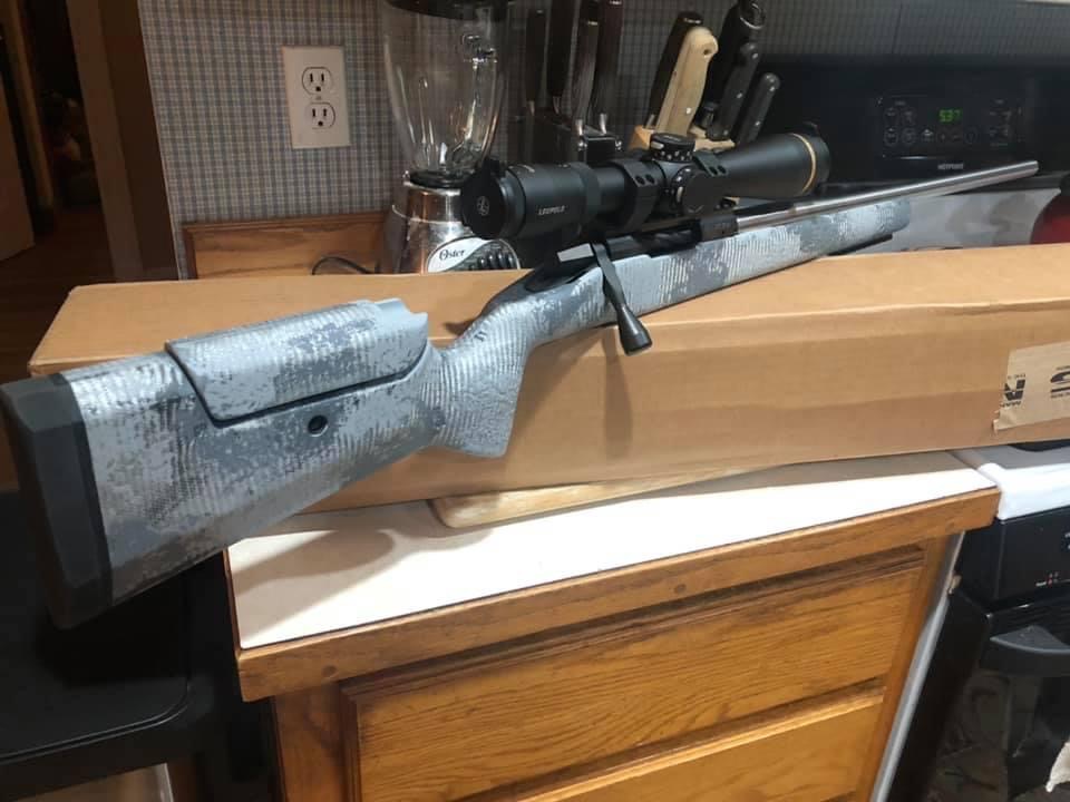

Manners EH6A

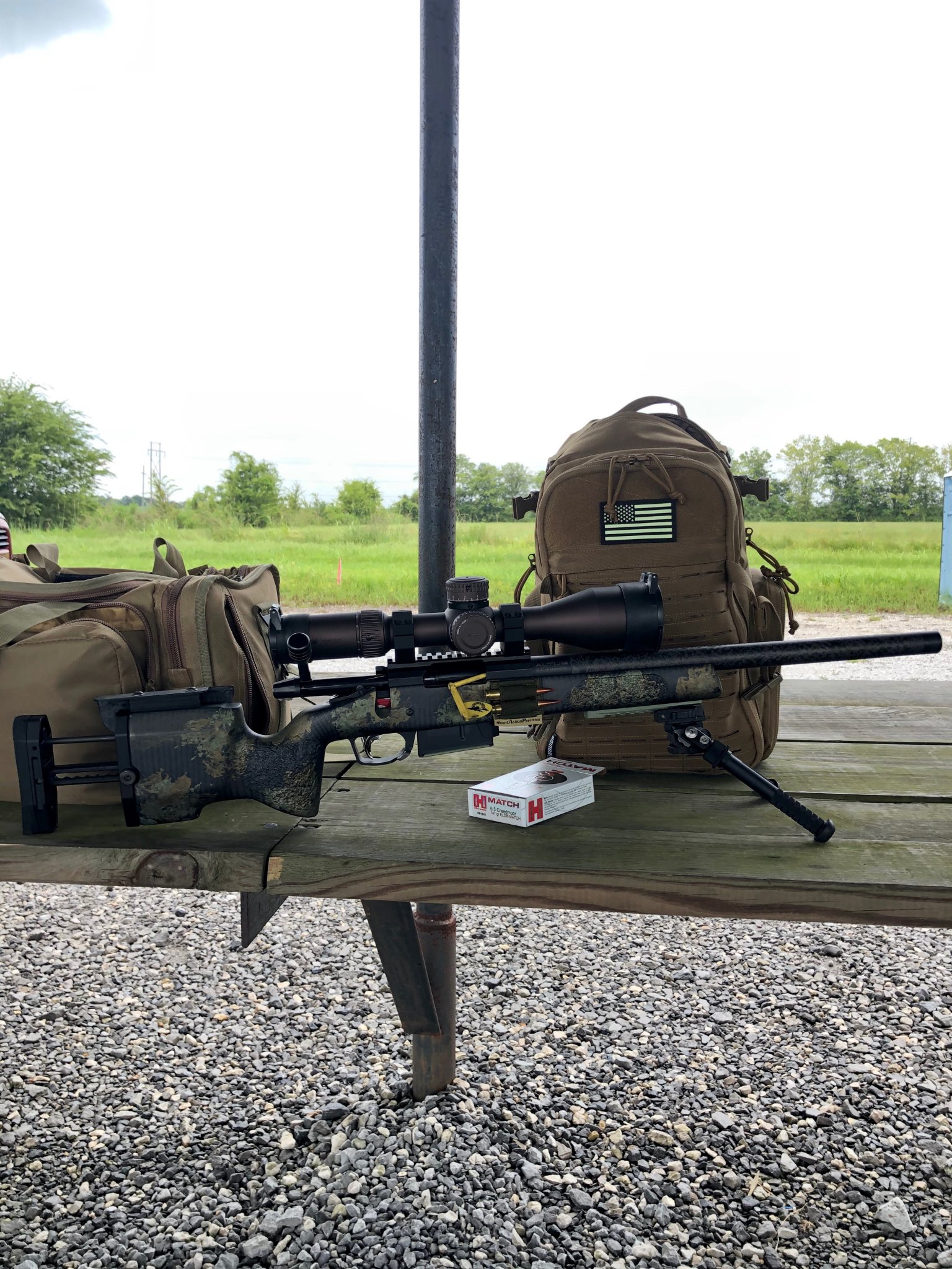

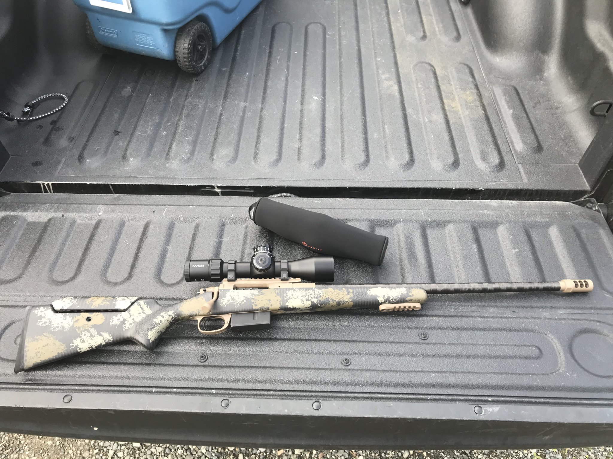

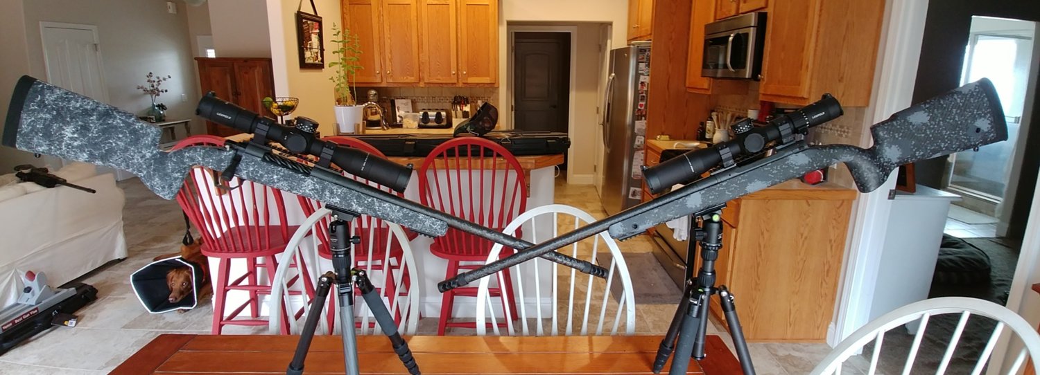

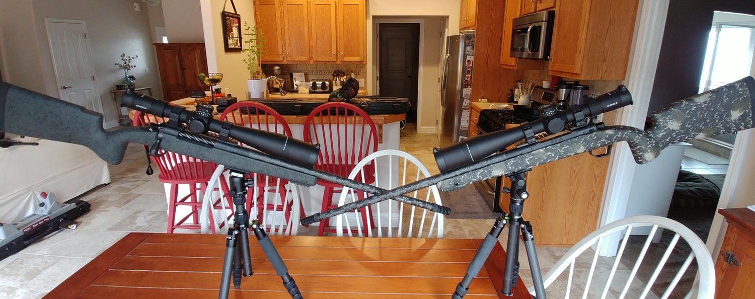

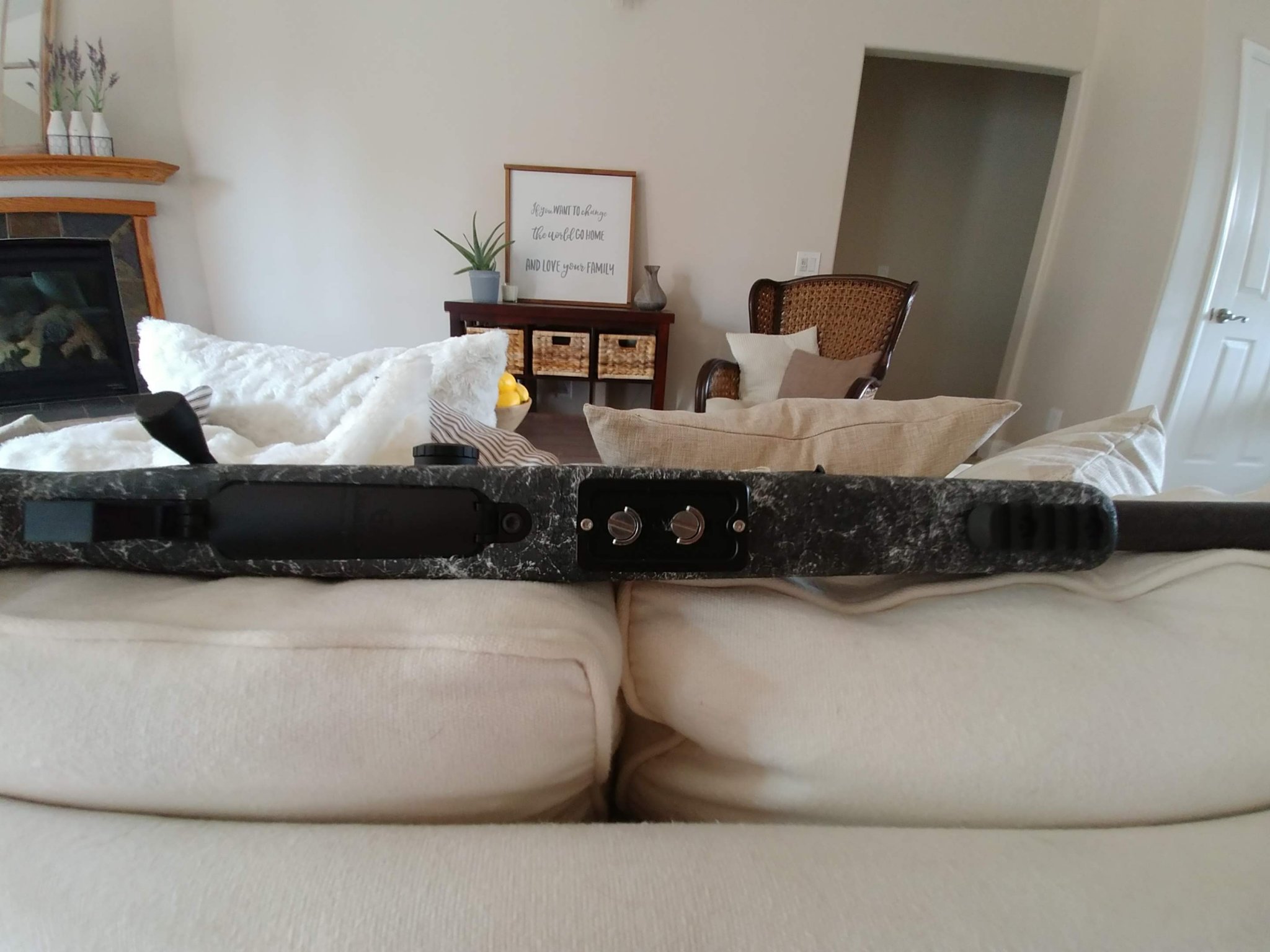

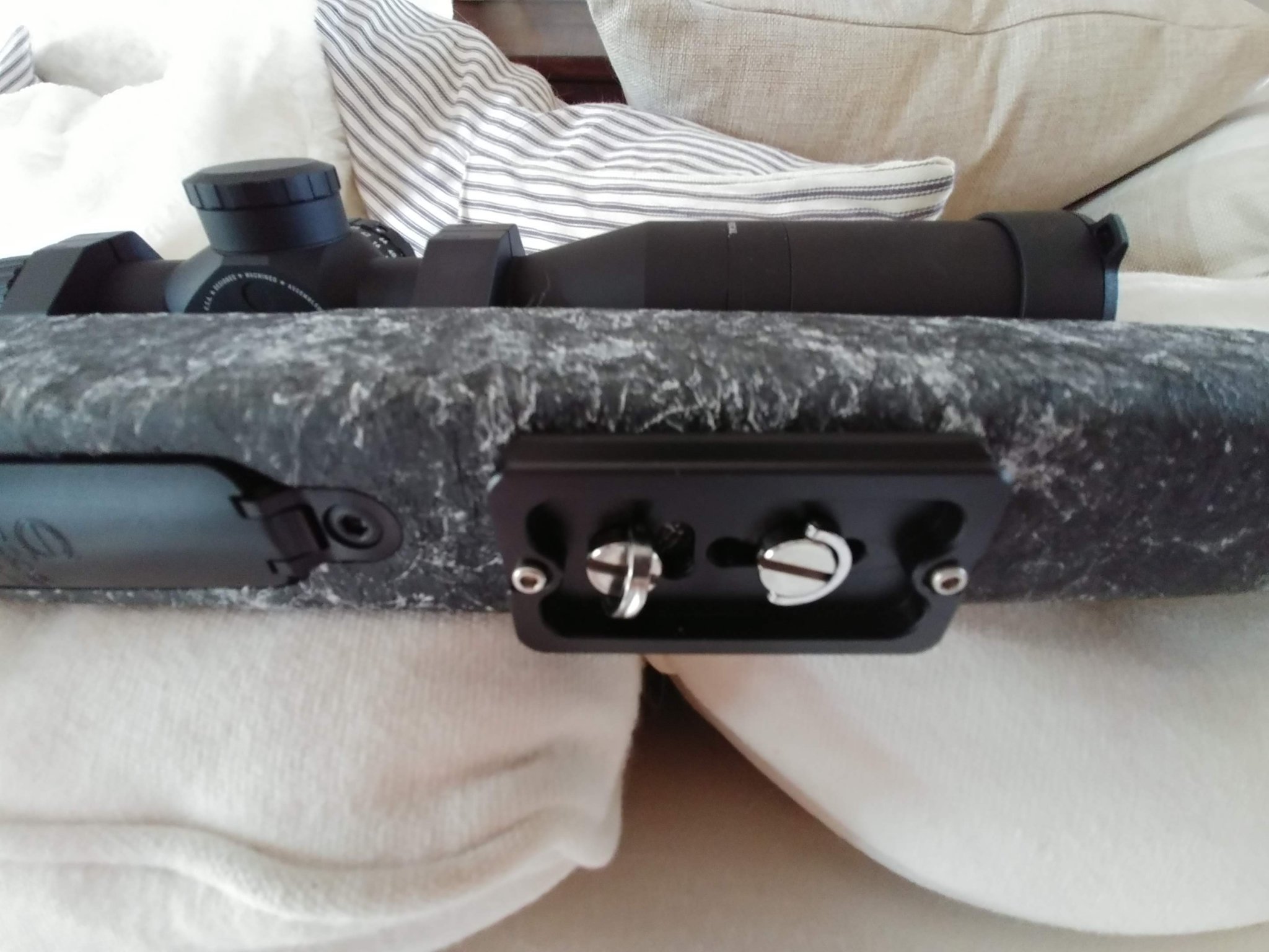

I have 4 of the AG alpine hunters on my 4 main long range hunting rigs. I like them. There are alot of good options out there. AG prices and timeline are the things I like. Also seem to be as good as any when it comes to quality. I want to build another rig in in an xlr element magnesium with the all carbon folder rear. Keep it short and around 8.5 lbs all up. Waiting to see what the 4.0 version that's not out yet brings
did you have AG install the tripod mounts? Or did you put your own arca on? I’m curious what the AG factory tripod mounts look like
thanks for sharing! I’ll probably skip that option and stick with doing my own area 419 arca plate install.
No problem. They work well but I have been contemplating doing the 4.25" area419 arcs rail in its place. Just a more sleek/slim design. Its not needed but why not I guess.. Been running these like this for 2 years. Honestly we really only hunt/shoot off a bipod and prefer a pic rail for that but have it setup for s tripod just incase for that "right" situation

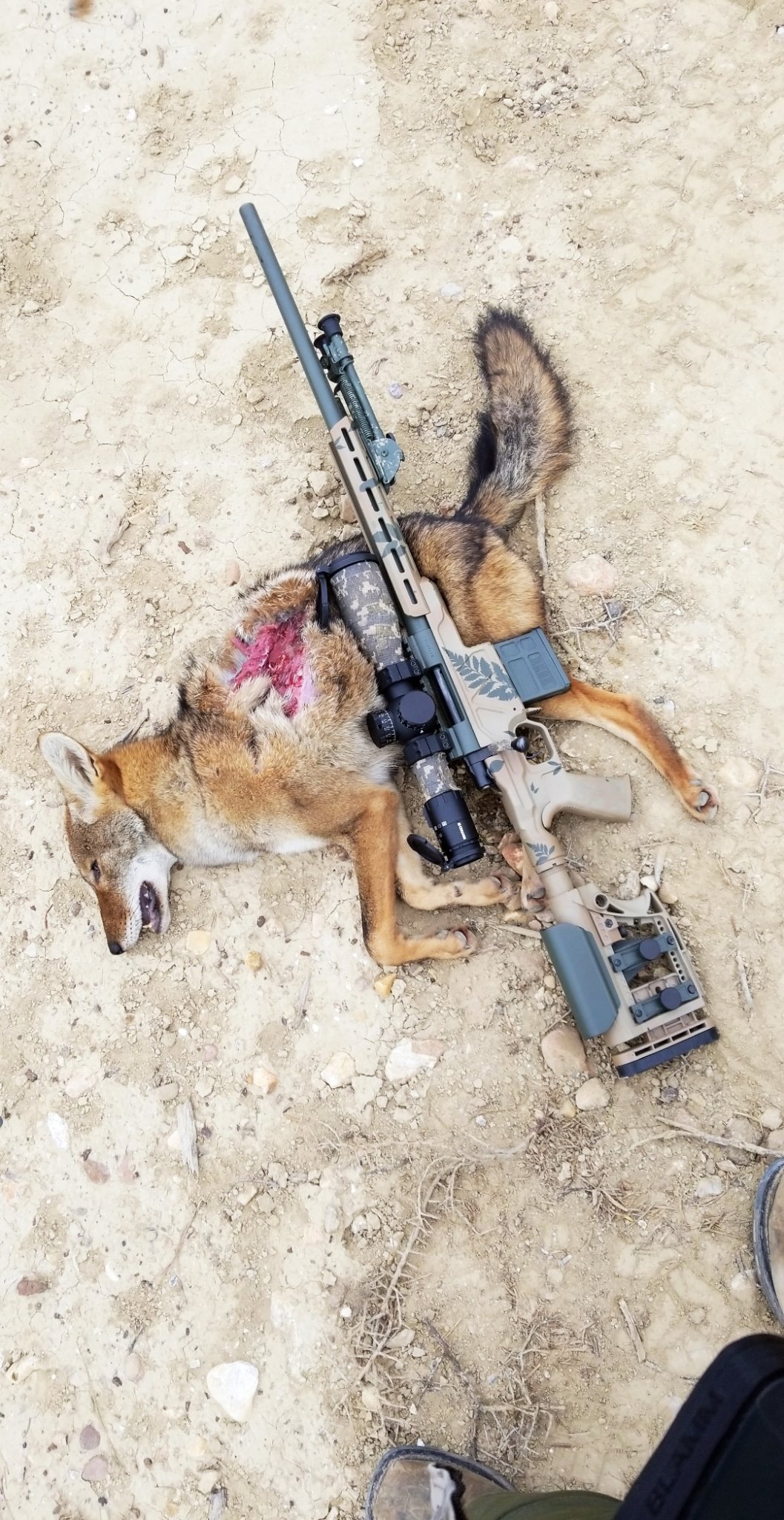

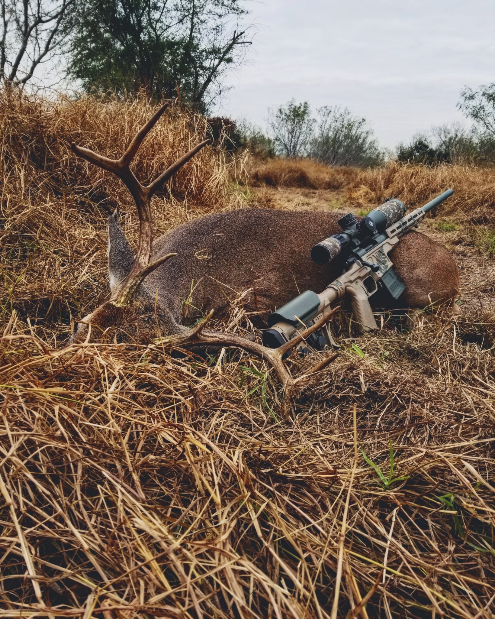

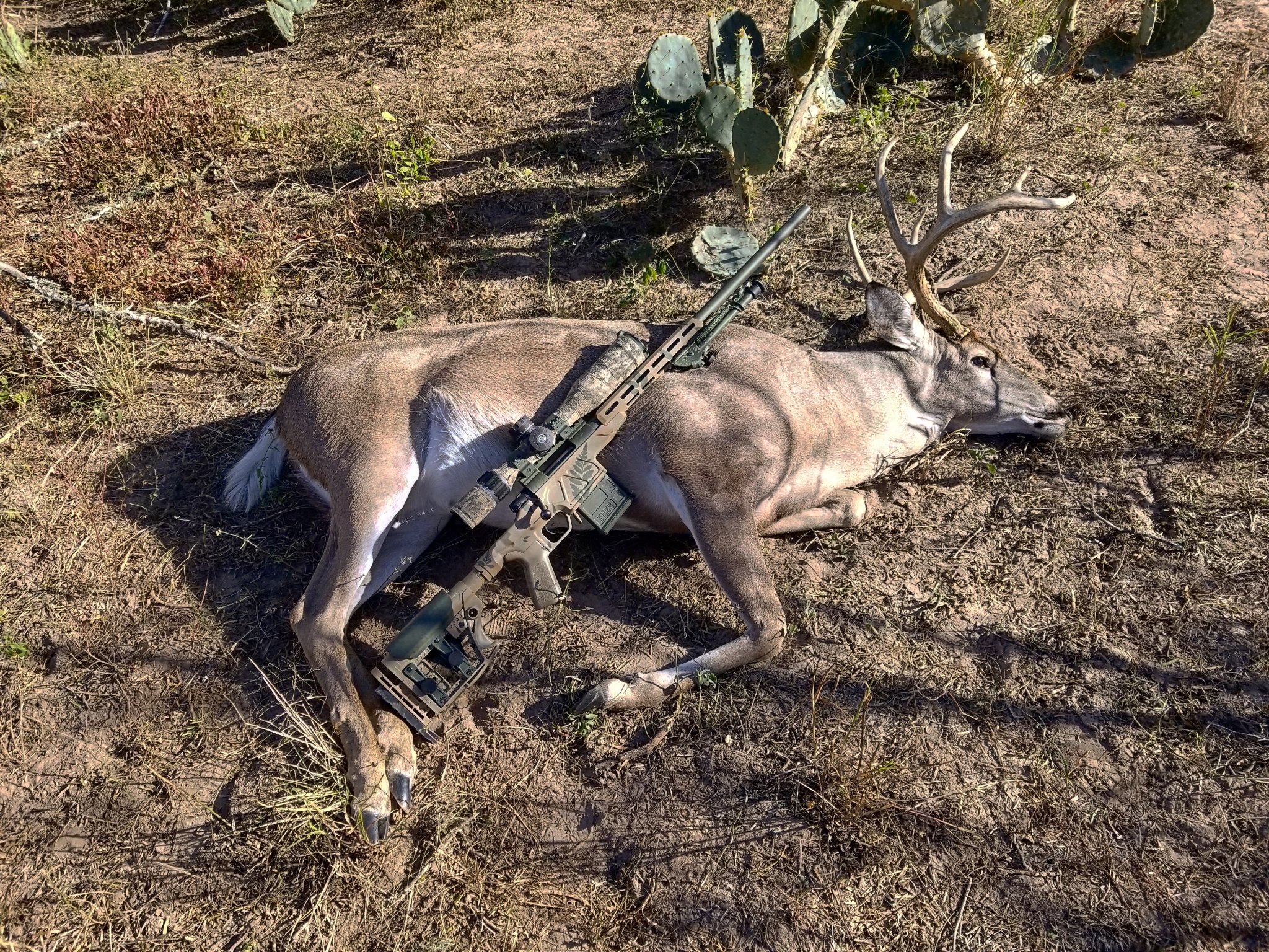

I'm using an accurate mag chassis with an MBA3 buttstock. I recently started using stocks like a McMillan A2 and an HS Precision but it became clear to me that stocks are a no go for me. They look beautiful but somehow i didn't like them for hunting.

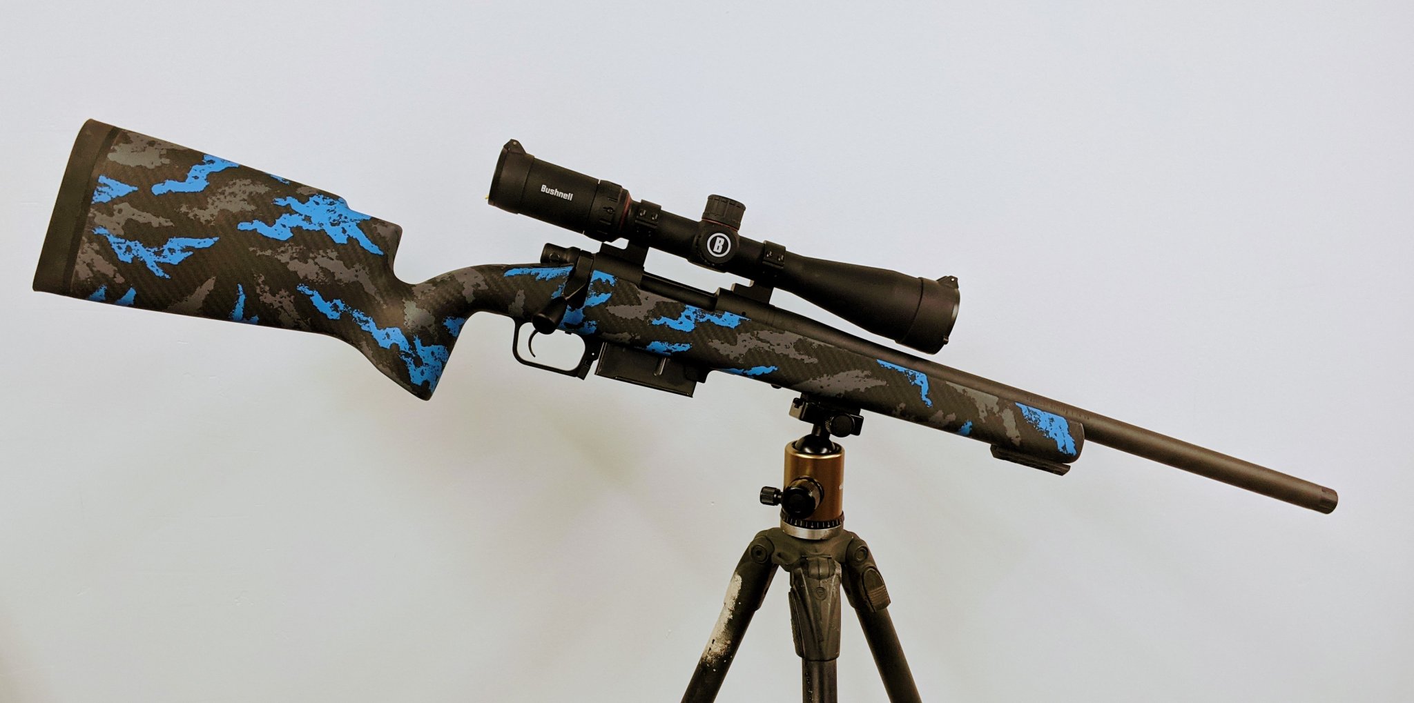

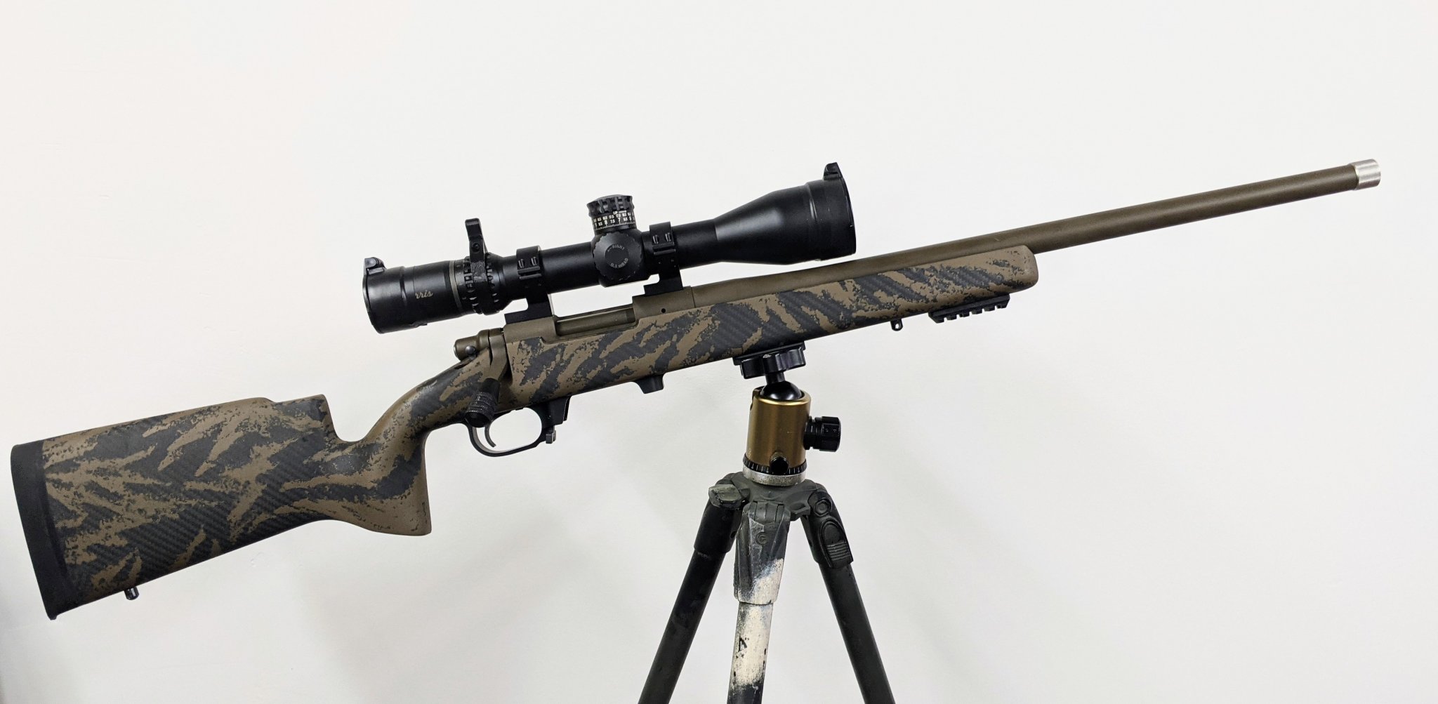

nice bro! This is the 16.5” 6.5CM I built for my daughter. Great little rifle just a little light for elk. It’s on an Origin so just need to get her another barrel for it. Thinkin 7wsm or 300wsm. Just need to make sure it’s not gonna rattle her filings loose when she shoots it. Lol
That is awesome!

yeah the 419 installed with t posts is very sleek, but I do wish they were smooth arca plates instead of the ribbed edges. Be a bit more comfortable to grab onto lol. I’ve quit carrying a bipod while backpack hunting and just use my tripod for everything.
I agree on the ribbed edges. Its the super quick deploy of the bipod and a little bit of the sturdiness that keeps me packing the bipod. I most likely wouldn't of been able to shoot a bull this year on one of my hunts had I only had a tripod... Shooter bull stepped out at 350 and only had seconds to drop down prone and take the shot before he took off.
If you order the tripod ready AG, the hole spacing is set up for the Blackline Precision mount, which is smooth, and VERY low profile. They don't have it on their site, but a phone call and $40, and it will be in its way.
I was under the assumption that all AG stocks had aluminum in the forearm that you could drill and tap for an Arca. Today, I drilled and tapped the foreend of my 2nd Alpine Hunter which was not a tripod ready model, and there was no aluminum in there. I drilled in the same location as the other stock, and nothing...so I used countersunk rivnuts and 10-24 screws to mount the plate I got from Ken Trapp at Salmon River Solutions. The plate from Salmon River. I highly recommend either product.

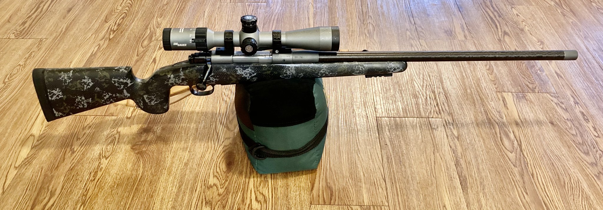

I’ve got a Game Scout, just ordered a Game Warden. In theoy, my Bartlein CF shouldn’t fit in the Game Scout, but it does (nicely!). You can spec different rail options if you’re willing to commit when you order. I started with a M70, not a M700, and went with a 24” barrel, and kept the standard bottom metal. With 1.75 lbs of optic and mount riding the rifle, it comes in around 9.5 lbs. Lighter than it was, but definitely not light.
I love that stock design. Haven’t had an EH1 to compare it to, but that was the only other real option for me.

what bartlein contour do you have, and what did you specify with McMillan?
Well, for the hunting rifle of the day, I have a Howa 1500 Standard Hunter (that came with a walnut stock seemingly made by a blind freshman) into a Bell & Carlson, which itself required me correcting some half-assery with a sandpaper-covered dowel. It's not as light as my Tikka T3x Ultralite, of course, but I find it more comfortable to use in the right situation. I sent my garbage factory walnut stock to Howa over a month ago with approval for warranty replacement (and even with their shipping label) and haven't heard a single peep, so I just got a new stock. Now I know how Howa acts... maybe I'll see a replacement one day. The scope is the Cabela's Euro Instinct made by Meopta. Quite clear glass. Love the build quality.
I've got a #13 CF (in red...color is very subtle, as you can tell) on a M70 in my Game Scout. I didn't/forgot to spec a different barrel (or it didn't make the build sheet and I missed it). I spec'd that barrel contour on the stock I just oredered and Josh called me and said he swapped me to a Game Warden to accommodate that contour and that is is marginally wider/deeper in the forend. My hope is I cannot tell the difference, but we'll see when I get them side by side.
As for the rifle as pictured, the barrel floats to the bedding/barrel knox. ETA - I don’t know that it comes through on the attachment, but the lighting in the original photo is such that you can actually see the gap between the stock and the barrel.
