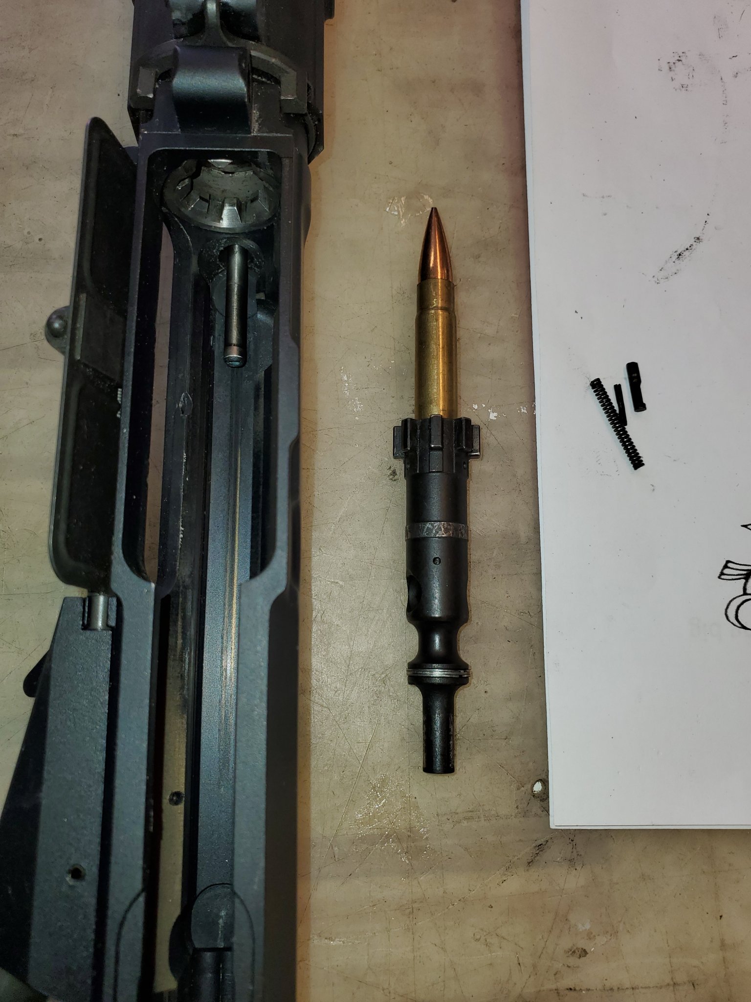

What does the back side of the bolt lugs look like?

fortunately ,,, the chamber and the lugs all look to be fine ,, no damage . just the bolt ,, it bent the ejector, have to ge a new bolt

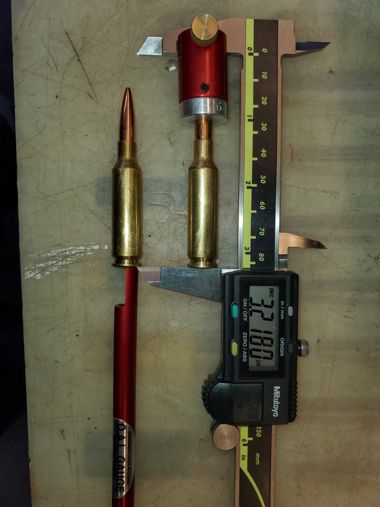

Hornady comparator tools.
Otherwise.
You can take a loaded round in your bolt (less the ejector) Should have a small amount of wiggle with lugs engaged.
You could also color a round with sharpie and look for rub marks

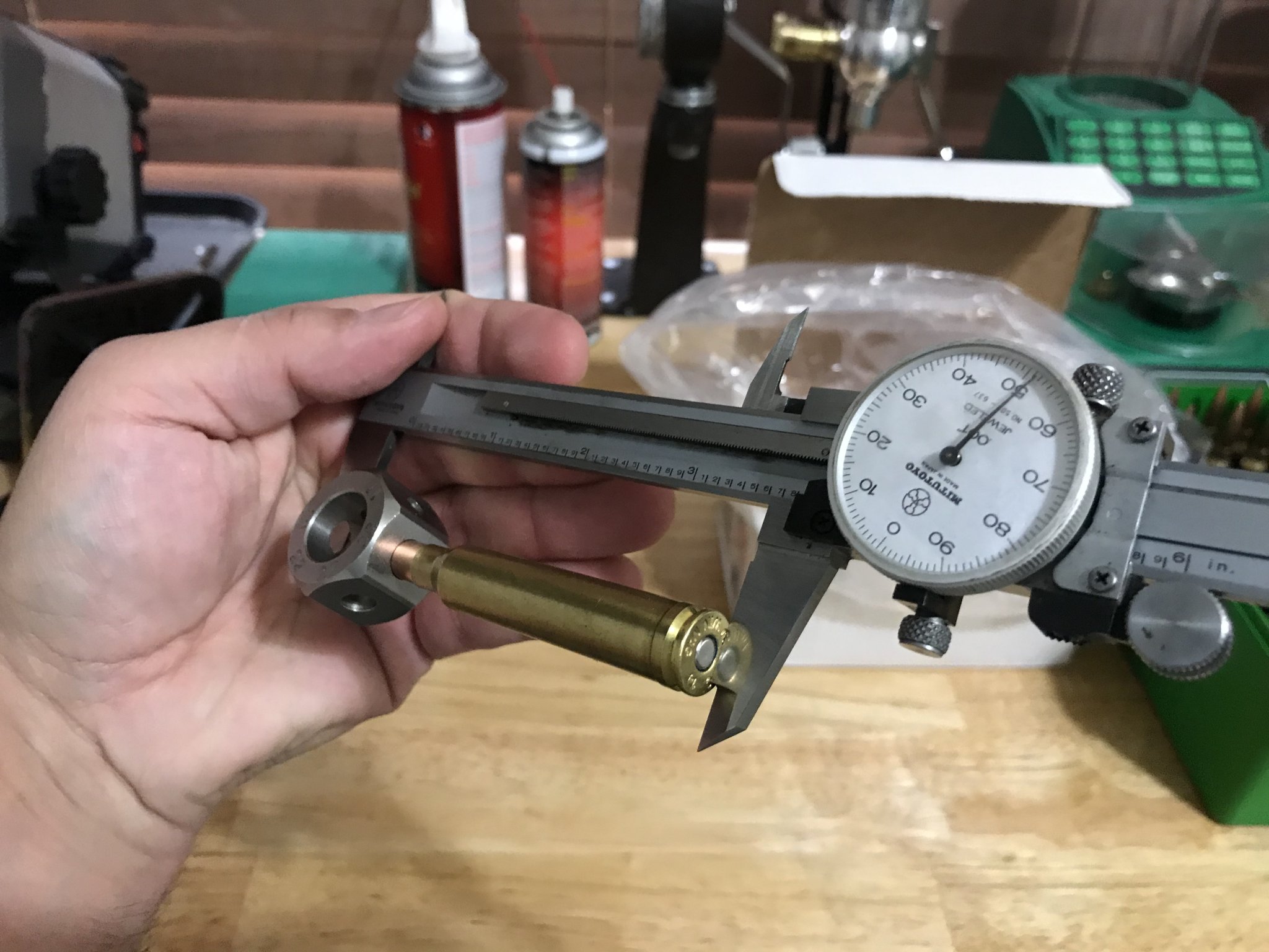

The portion of the bullet that makes contact with the lands and groves is the Ogive...Base to Ogive measurement is essentially for confirming bullet jump, which becomes more important in bolt guns than semi autos but consistent jump helps the load perform consistently to expectations.
Upstream step - determine loaded round case head-Ogive length when the bullet’s ogive is seated so it touches the rifle lands (not as critical since the magazine internal length will likely prevent you from getting to the lands anyway but if loading for bolt gun, this step must be performed before the below...

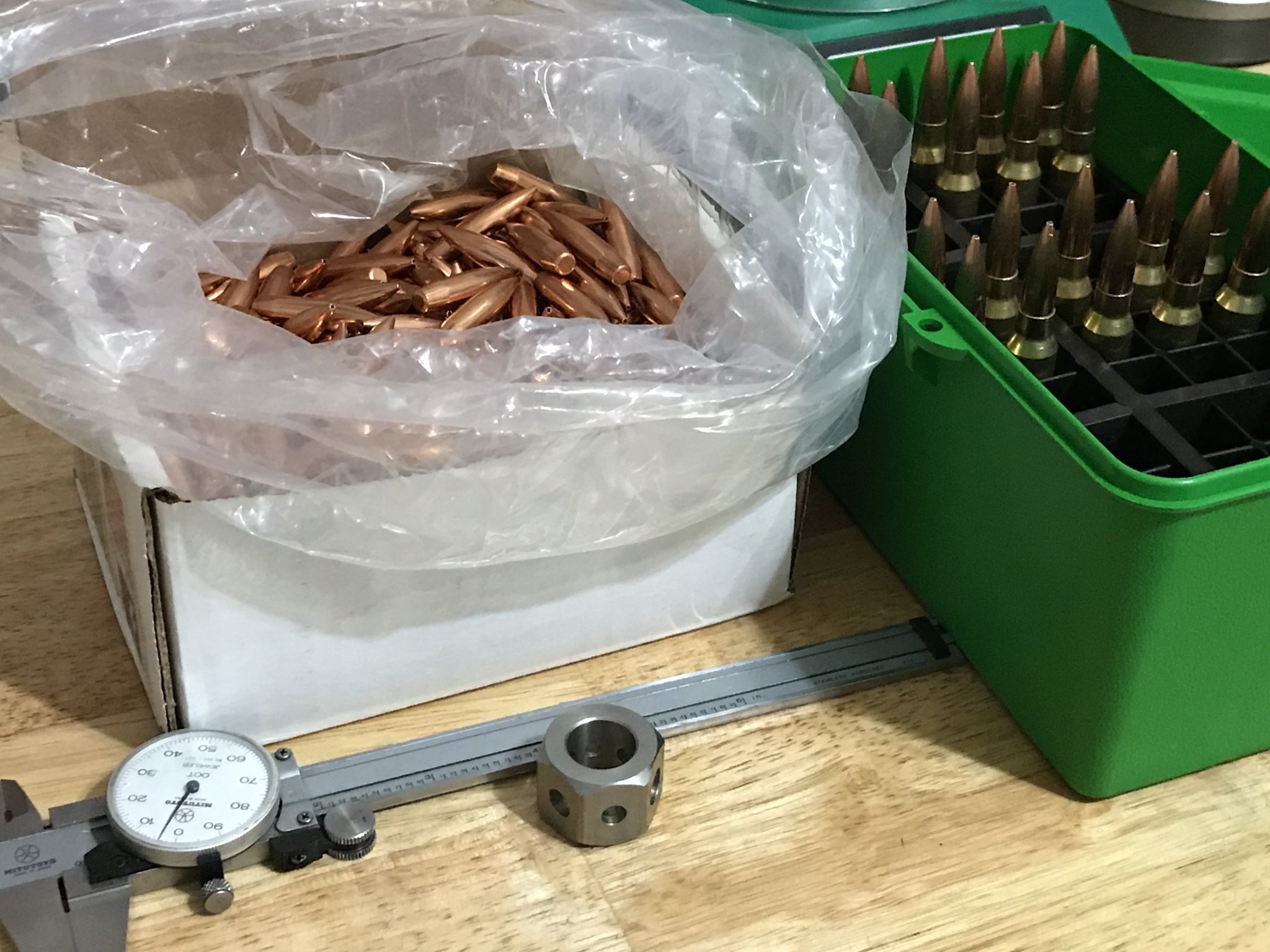

Step one: acquire a dial indicator and bullet comparator (I use Sinclair’s but Hornady also makes a nice kit).

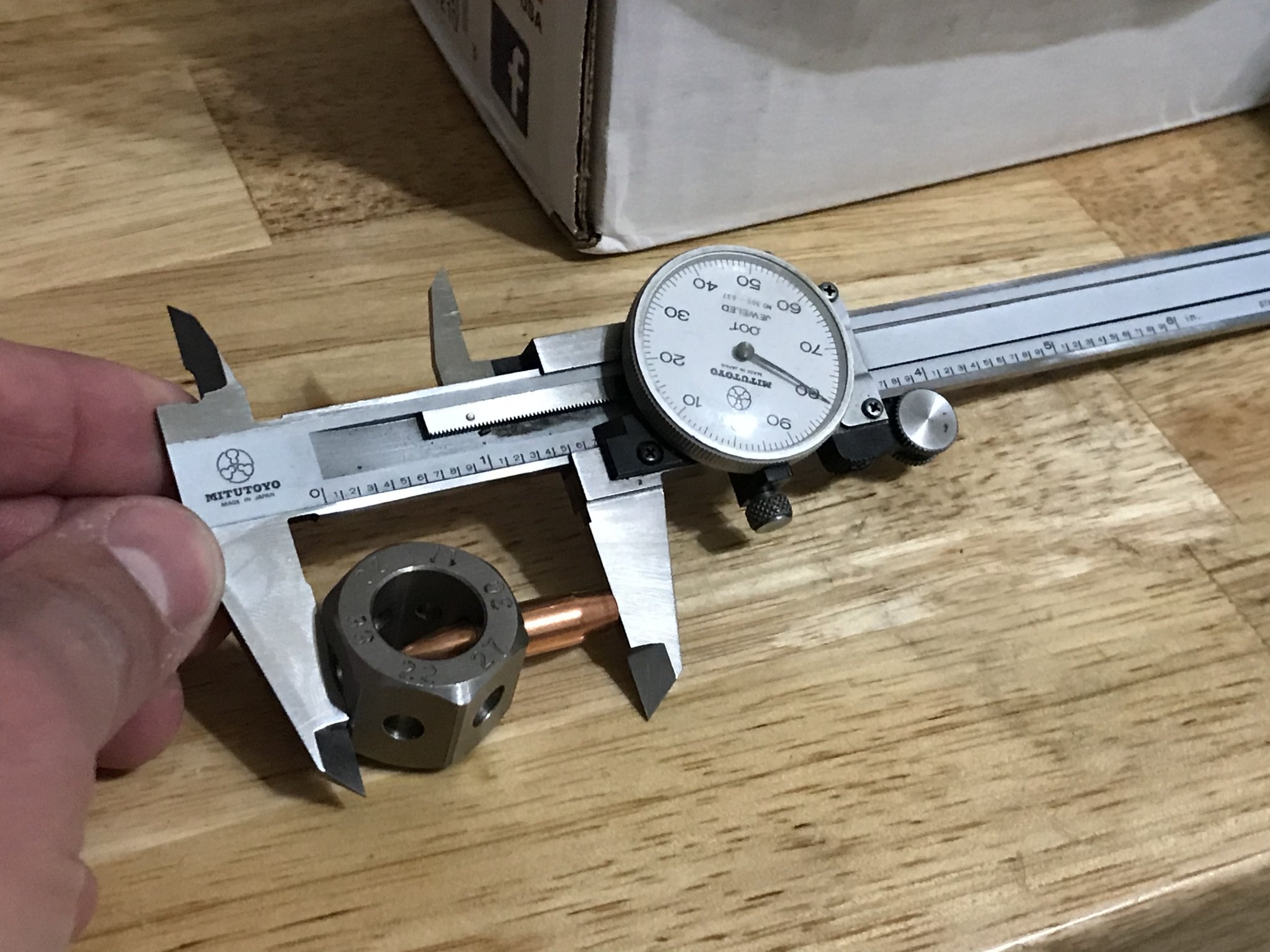

Step two: Grab your box of bullets and measure the bullet base to ogive (just the bullet not the loaded round - you’ll do that later)
Step Three: group all the bullets based on their measurements into 3-6 “buckets” ... record the measurement for each bullet and the group mean and put them in the buckets (I use old 100 count bullet boxes) This is called Ogive sorting and will save you time later in the process. My task for today so figured I’d take a pic).
Generally I try to shoot for a tolerance of .004 (ie a bullet from the same bucket, when seated into the case, will have a jump that varies by no more than .004 in either direction from the bucket’s mean.

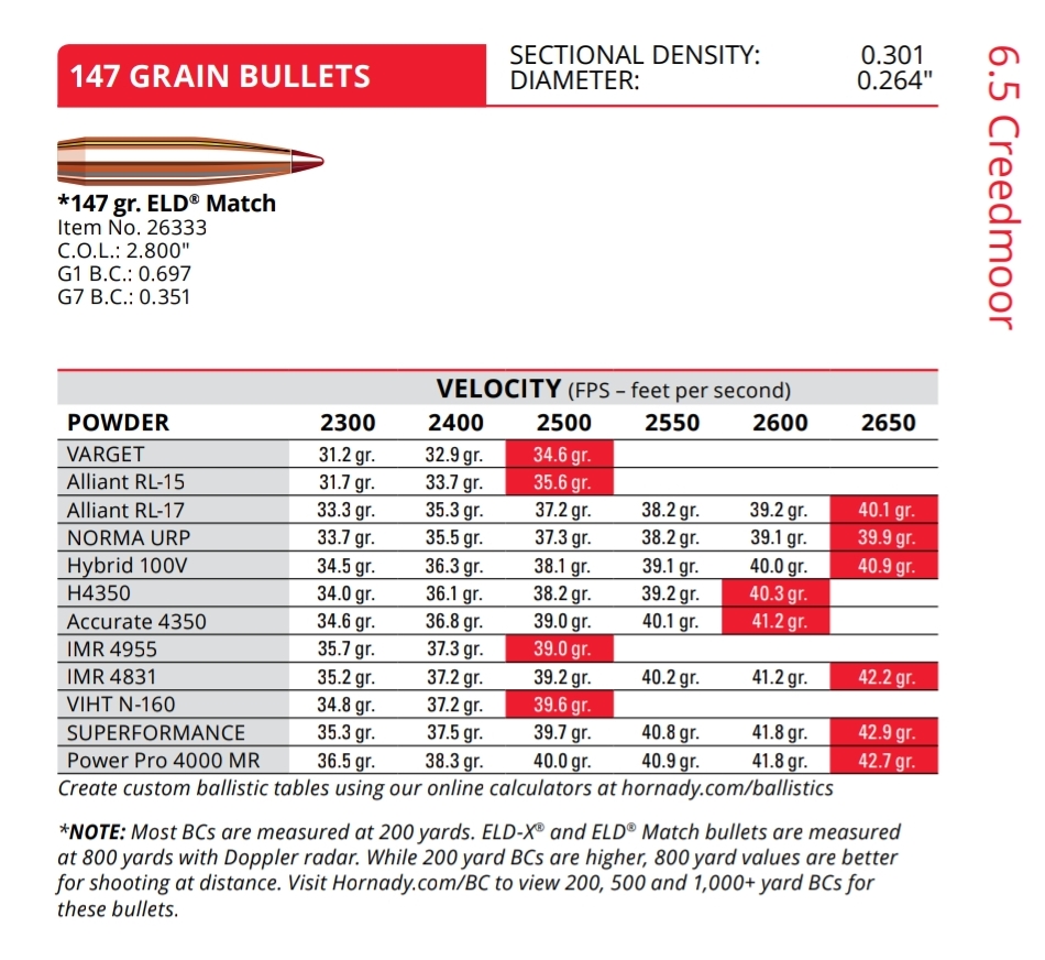

So how the hell did i get SOOOOOO much pressure that it completely extruded the brass into the ejector hole,, thats a BOATLOAD of pressure, and i had to PRY that SOB off the bolt face. was the charge I used 43.5 grain of Varget to push HORNADY 147 gn ELD Match
43.5 grains of Varget under a 147 is excessive.

All other questions are irrelevant. 43.5gr of Varget was clearly WAY too much powder and pressure that ruptured that case. Even the best brass wouldn't hold up to that. I'm wondering how the OP even got that much powder in a 6.5 Creedmoor case.

If that's not a typo then there it is right there. Even if you meant 43.5 of H4350 even that's a hot load with a 140 for a gas gun. It's hot for a bolt gun. And you used a FASTER powder and HEAVIER bullet.

Guys I want to THANK everyone for their input on this and upon pulling these remaining rounds and weighing the charges I think it's clear here ,,,,, WHERE I utterly FUCKED UP. I'm grateful I still have my face in tact . No clue where or HOW I got that number but This will NEVER happen again .. I'm just glad I didn't hurt my gun ,,, got over 2 grand in to it ,lol Gorgeous AR-10 be a shame to fuck it up due to stupidity . Thanks again Gents ya'll were a HUGE help .
