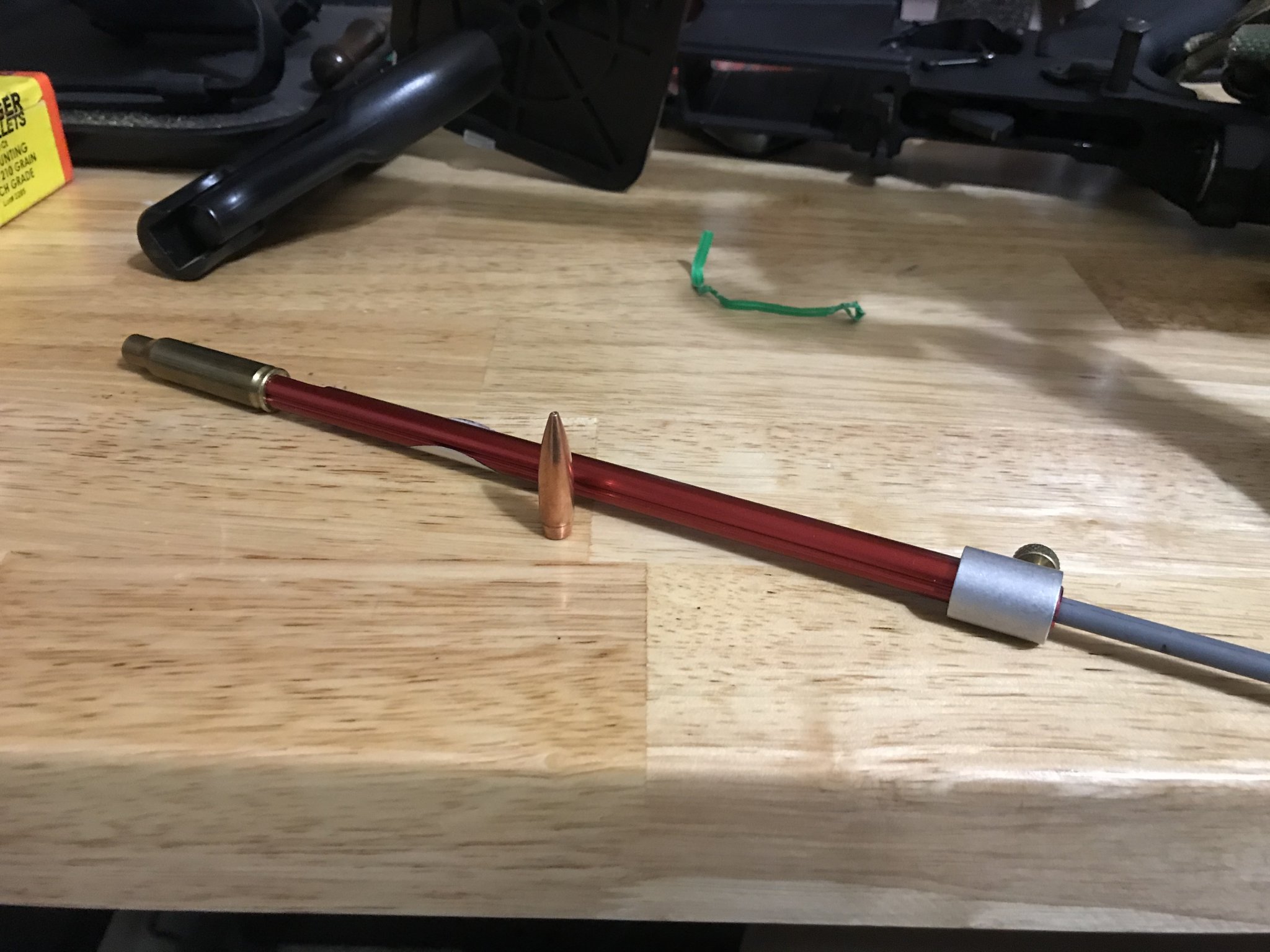

Step one: acquire the Hornady oal gauge and the modified case corresponding to your cartridge (6.5 creedmoor; $20 or so)
Step 2: Screw the modified case onto the threaded end of the OAL gauge and insert one of your bullets from any one of the Ogive sorted “buckets”

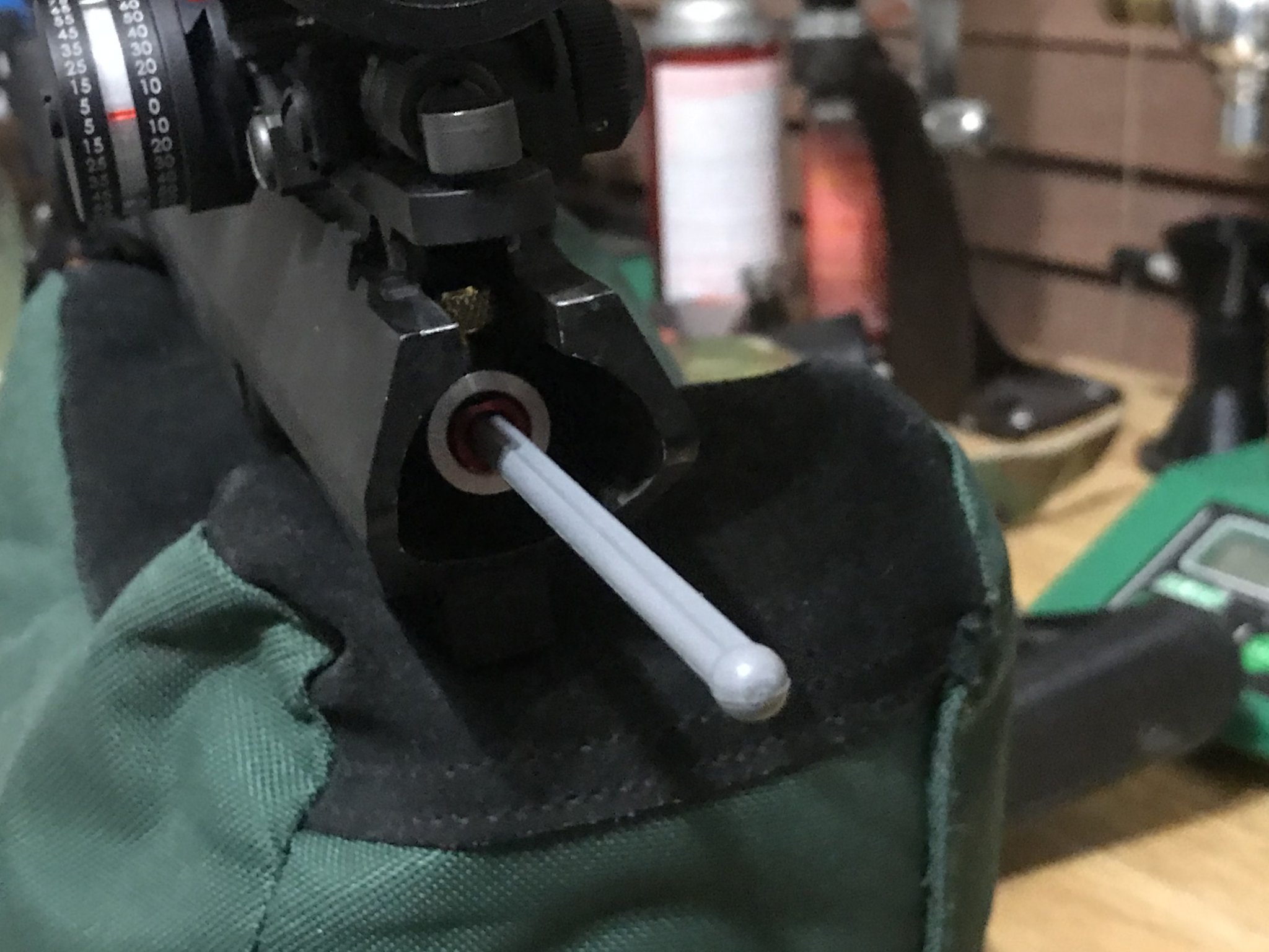

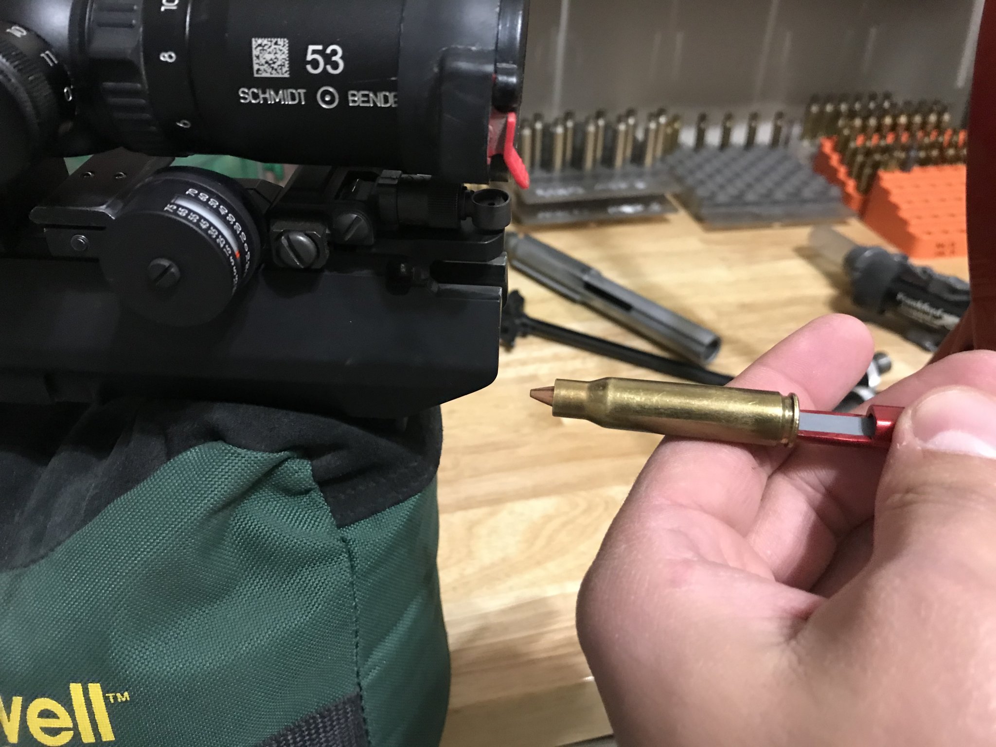

Step Three: Insert the assembly case-first into the rifle (I’m showing this on my SR25 so as to show how to do this on a semi)
Use the plunger rod (gray) to force the bullet to the lands then tighten the knurled retaining screw.

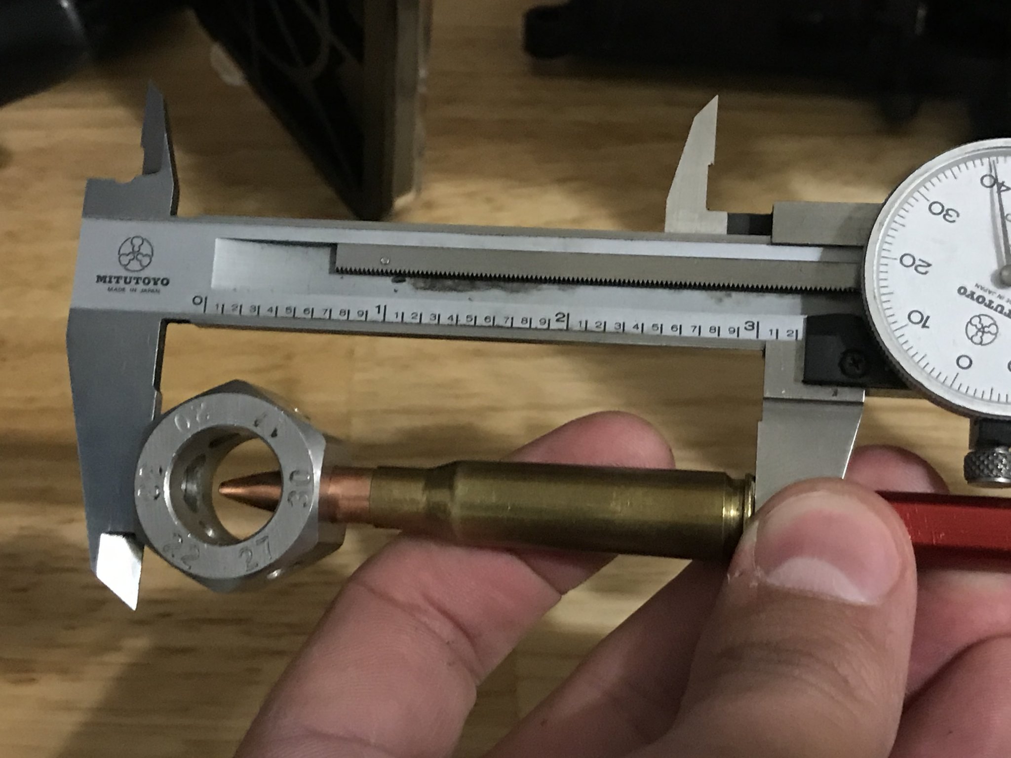

Step 4: Measure the case head to Ogive with the oal gauge, your bullet comparator using your dial calipers.
Record this number. Repeat the above steps a couple times with the same bullet to be sure your measurements are consistent.
Step Five: Set your bullet seating die on a dummy round such that the case head to Ogive measurement is the same - this is the jam length for those bullets with that same bullet base to ogive length recorded during Ogive sorting done in the previous steps.
Step Six: Adjust your seating die so that the bullet is seated based on the amount of jump you want. For semis, I typically use .030 jump if I can get it without running out of room in the mag...in the gun above, I’m jumping .055” as that’s the closest I can get before I run out of room in the magazine.

nn8734. How do you tighten the knurled knob when its inside your upper like that?
I have the Hornady and the same problem. The damn thing isnt long enough for my LaRue. Instead of tightening it into the "hole" that its made to screw into; I have to hang that knurled knob off the back and even then I can barely reach it to tighten it down. It probably fits an AR15 just fine but I dont load for AR15. I found 3 off the shelf ammos that shoot sub MOA plus I get plinking 556 for 10 cents a round. Ae 223, M193 and others. Couldn't even even come CLOSE reloading for those prices.
Good question, should have mentioned it in the post. I use a small flat head screwdriver and gently “turn” it until tight. I always repeat the process a couple times to ensure I’m getting the same result.

OK I looked. NOPE. I dont have a screw driver slot. However I did measure it and the OD of the guide rod is .370". I just need to make a longer collar that will stick out farther. The back end of which will have a smaller ID to closer match the pushrod. Simple.
Goes to look at mine and see if I didnt notice the screw driver slot. BRB.
There isn’t a slot but the knurling on the screw will allow the screwdriver blade to grip it enough to enable you to tighten it sufficiently. It will be a bit awkward at first but you will get the hang of it...
