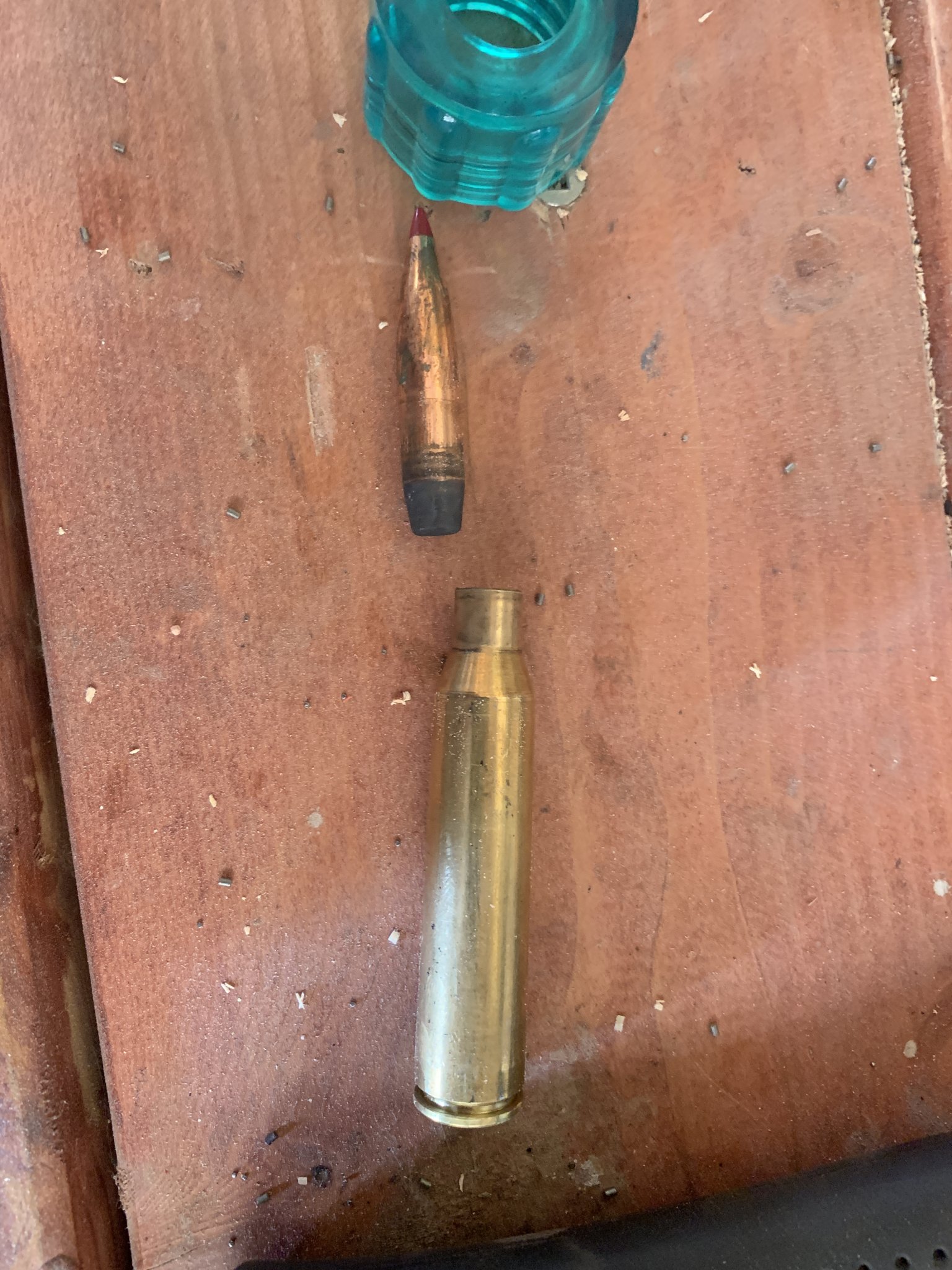

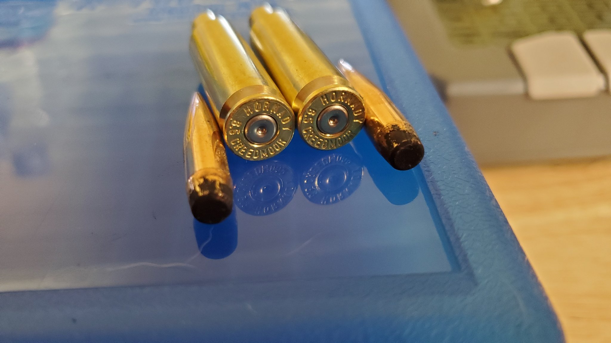

    Fast forward to this afternoon and this happens again. Press the trigger I hear a click but bullet doesn't fire. This time I was smart enough to take the cartridges home with me and try to pull the bullet with the bullet-puller hammer.
    **Pictures of bullets and primers below**
    I was very nervous that maybe my friend was right and I did forget to put powder in it. And, by the coloring of the bullets I pulled it looks like there was "something" in the cartridge to discolor the bullets as they were seated. Is that primer dust or powder dust...

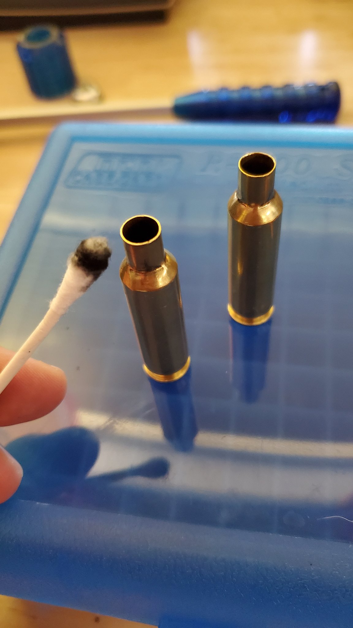

    When you opened the cartridge ... what was inside? Was there a bunch of "gook" that would indicate residually burned powder, or was it basically empty? If residual ... I'd worry about powder quality that "fizzled" but didn't actually explode. If nothing (empty cartridge) ... I'd suspect you forgot the powder. Just thinking out loud ...

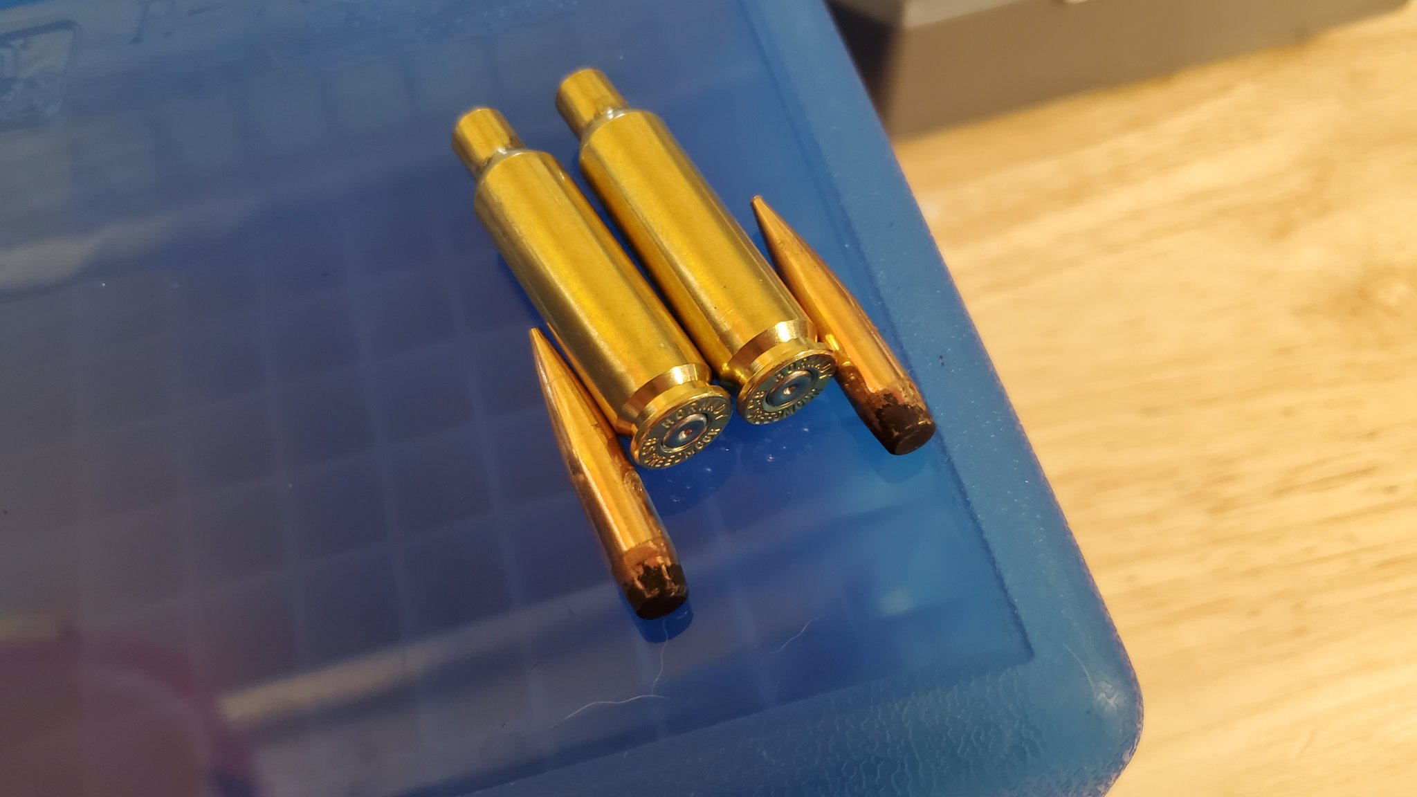

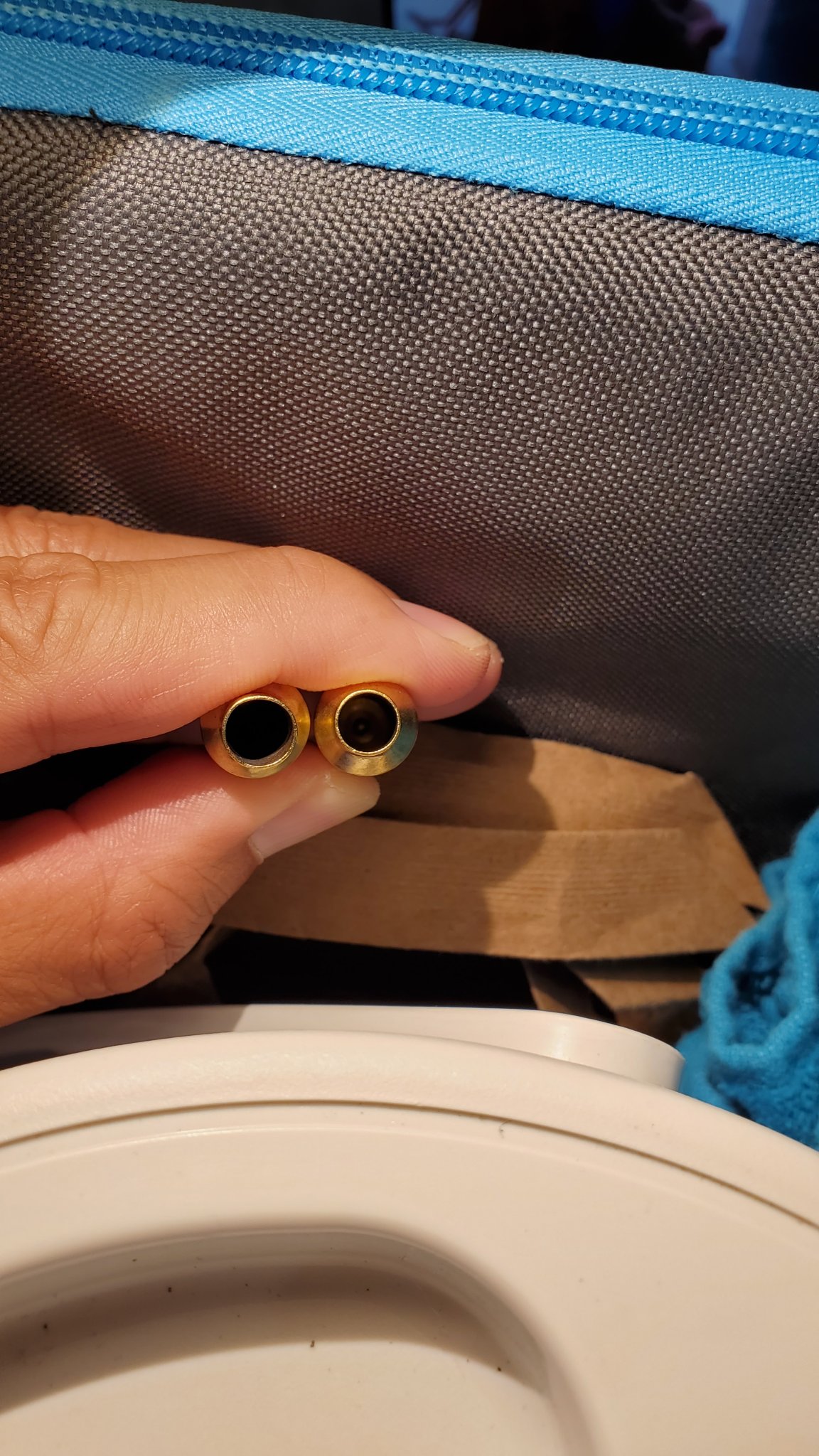

    The cartridge on the right is a primed, unfired round i am about to reload. You can see the clean yellow brass inside. The cartridge on the left was one of the problem rounds. Its dark inside and you can see the powder residue i swabbed from the brass walls on the cotton swab.
    Definitely could be primer powder popping. Not only is that just embarrassing because it means I didn't load the cartridge, but it's somewhat puzzling because that primer hole is so small in these cartridges.

    No powder in those cases.

    Since the bullet never left the case, you hear nothing. The black residual is from the primer igniting. Has happened to me once or twice. Be thankful the primer didn't jam the bullet into the lands.

    that residue looks to me like primer pop with no powder. It happened to me recently and I am lucky as hell because the bullet jammed the throat. I thought back in my reloading and I had spilt a case then got a double, so somehow I wound up skipping one. That is all it takes. I try to eyeball each one before seating but I seat as I go instead of waiting to fill 100 cases then seat.
