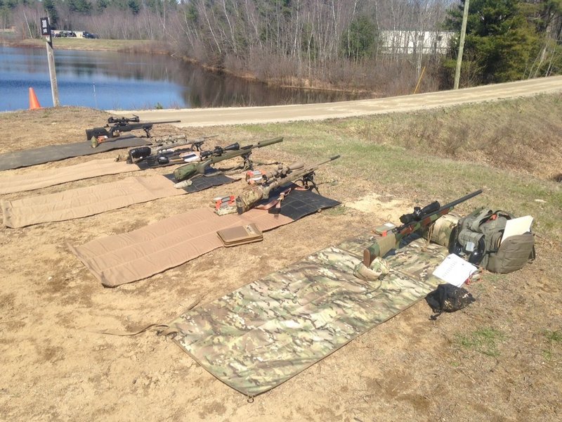

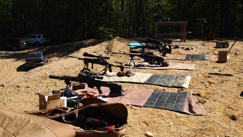

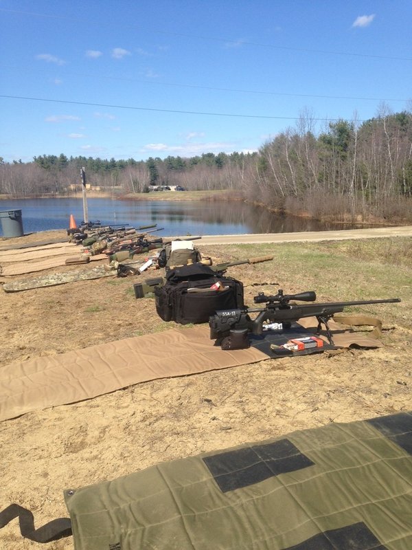

Some pictures from Sig Academy...
image1_zpsiwxwqnbq.jpgimage2_zpss2cq7sp9.jpgP5197451_zpsyo4bkh4s.jpgP5197452_zpsm79kotmc.jpg

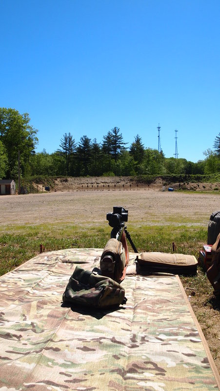

Here is some .308 at 300 yards Im shooting.
I know what the end result will be but Im comparing semi auto .308 vs bolt rifle .308 and Ill probably vary the ranges depending on iron sights or scope..
Just some self pleasure to give me a purpose while at the range.....

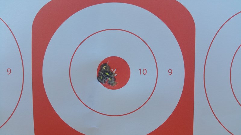

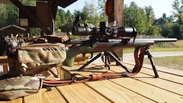

Yesterday I shot 15 one shot groups at a 1/2 inch circle at 100 yards using 175 grain FGMM. My sighters are top right......

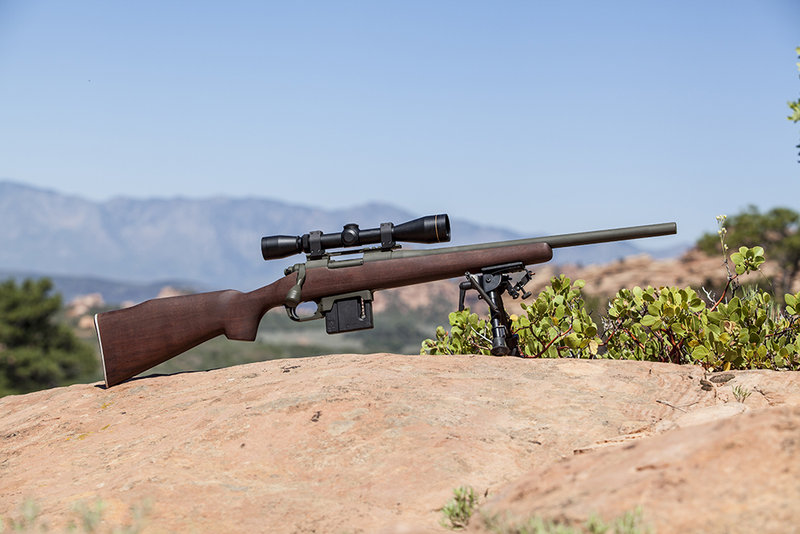

The rifle....

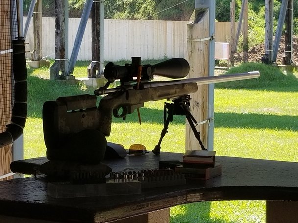

Playing with seating depth on Sunday. 100yds with my AI AEIII. Load details on the picture. People in adjacent lanes were shooting pistols, so lots of scatter shots on my target from them or from hits on adjacent steel. But I was happy with the results and knew when I pulled a shot due to rushing.
The rifle....
