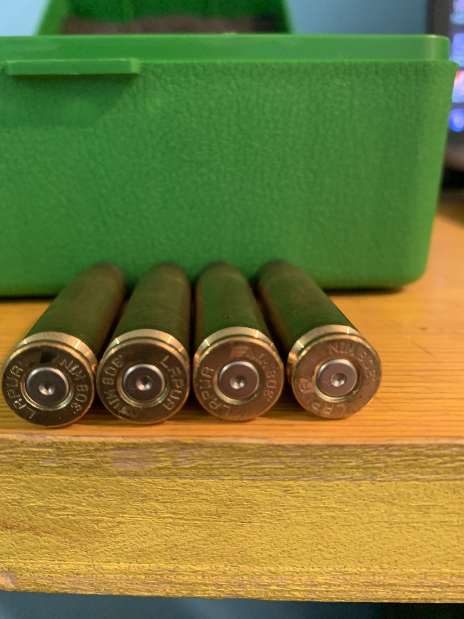

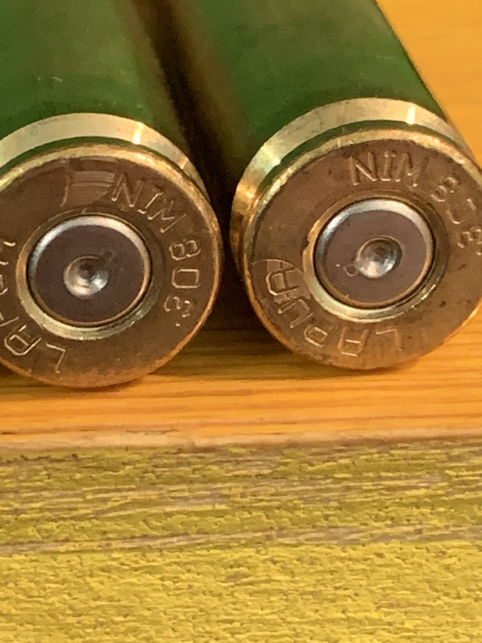

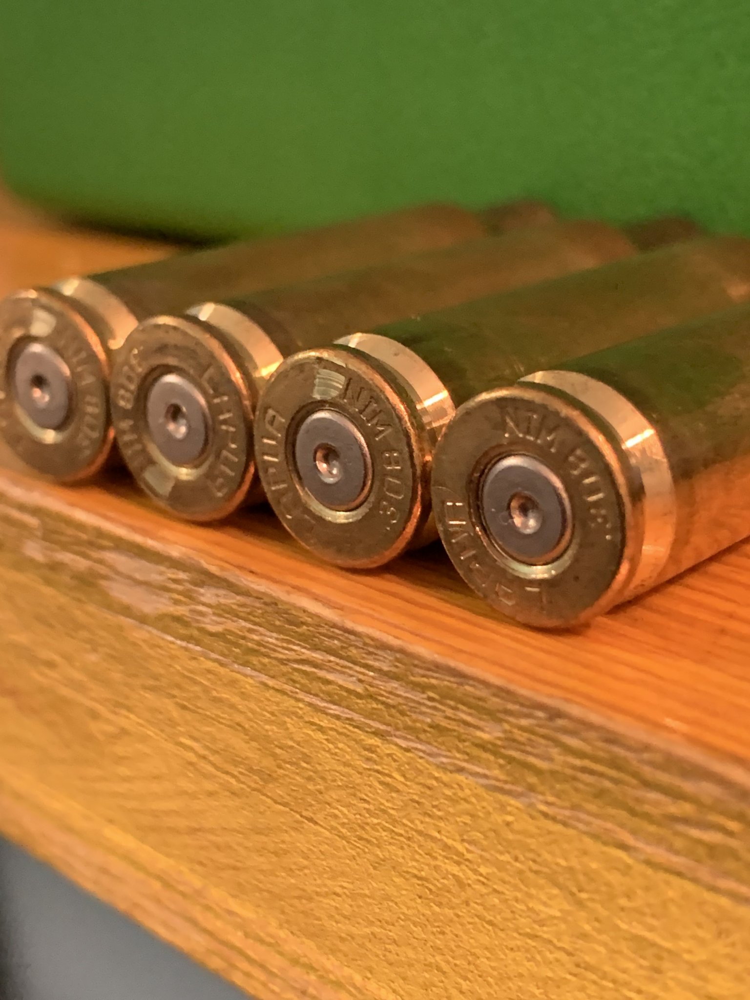

Hello
I have problem with marks on my lapua cases on 308 win, no stiff bolt on action or other signs of overpressure. I have around 800m/s with 175gr lapua scenar L bullets, N140 powder, 28inch barrel length. I have the same problems with factory ammo, more on pictures.

Looks like extractor swipe. It is not uncommon to see. Being no gunsmith I cannot tell you why some rifles do that when not as a sign of pressure but I suspect it is a mechanical condition and not pressure if it also exhibits with factory ammo

@dkamen2 The tip of the ejector leaves that mark as the bolt is rotated during opening. Why do you think it's a problem?
The tip of the ejector is leaving that mark? I've never heard of the tip leaving a mark. That looks like a pressure problem to me.
Looks like a classic half moon from overpressure of brass that flowed into the ejector hole. Pressure was high enough to push brass pretty far into the ejector pin hole on most of the brass. The bright smears are from when the bolt rotated past the locking lugs, before it hit the extraction cam. The bolt rotates but the brass does not because it is still stuck in the chamber before primary extraction. The rotating bolt scrapes the high spot in the brass that was pushed into the ejection hole. The smear doesn't always happen, and it looks like a couple were over pressure but didn't get the smear. At least, that's what I've seen. But, on my Nucleus action with mechanical extractor, the brass gets pushed into a slot, which then smears it if it were pushed in far enough.

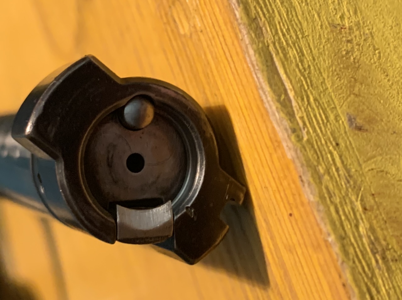

Try removing the ejector and check for burrs on both the ejector and the bore edge it fits in. Had a similar issue with a 700 Remington. After removing a very small burr problem solved.
I polish the whole surface a couple of days ago, but i did not see any bumps on surface. I must fire couple bullets and i will see if its beter

Did you polish before or after it left the marks?
Does the half moon stand higher than the rest of the brass? Looks like at least one shows a half moon without the smear. Others show part of the mark without the smear. Using your fingernail is it higher?
half moon is not higher then brass
If the moon shape on the brass matches the ejector on the bolt face that should point you in the right direction. Overpressure-possibly. Dirty chamber -also possible. I’ve had “slippery” brass show over pressure signs, both nickel plated as well as oil on the chamber wall.
The moon shape on brasses is the same as ejector
This is a curious thing.
Have you done anything to your chamber? Does the ejector have a burr? How much did you take off when you polished the bolt face? Why did you polish the bolt face?

No i didn t do anything to my chamber, this is happens from the beginning when i buy new rifle. I polish bolt face just because i saw if there was any bad surface or somethink like that.
The marks are definitely not from the pin itself.
Something is causing brass to flow into the ejection hole and then it is getting scraped before primary extraction starts.

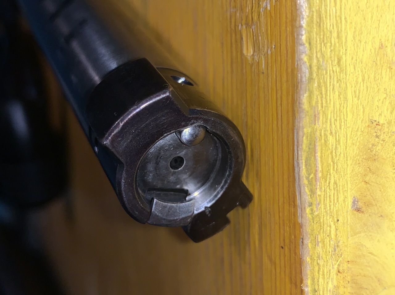

It doesnt really look like pressure pushing material into the hole. more like there is a bur or sharp edge on one side of the ejector hole scraping on extraction.
If it were me I would take the ejector out and hit the hole edges with something like 320 sand paper or small abrasive stone.
Easy enough to do. I assumed there was no no burr after he polished the bolt face. But, I can imagine how a burr could do that.
