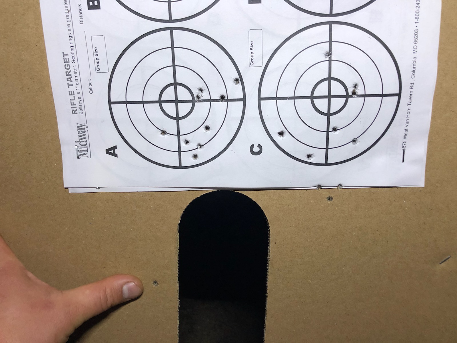

2 groups at 200 yards with the Eley outlaw. both 10 shotgroups. The dropped shot on the left sounded different.
This groups well enough that I should be able to hit almost all the targets at the small match I go to that goes out to just under 200 yards.
"If I do my part" My part is the hard part.
This was dialed at 6.2 mil. Maybe could come up .1 based on the right target and I was hitting slightly low on a 6 inch steel plate.
Now what to do next month? Do I just buy a pile of this or do I try Eley club or some SK next?
