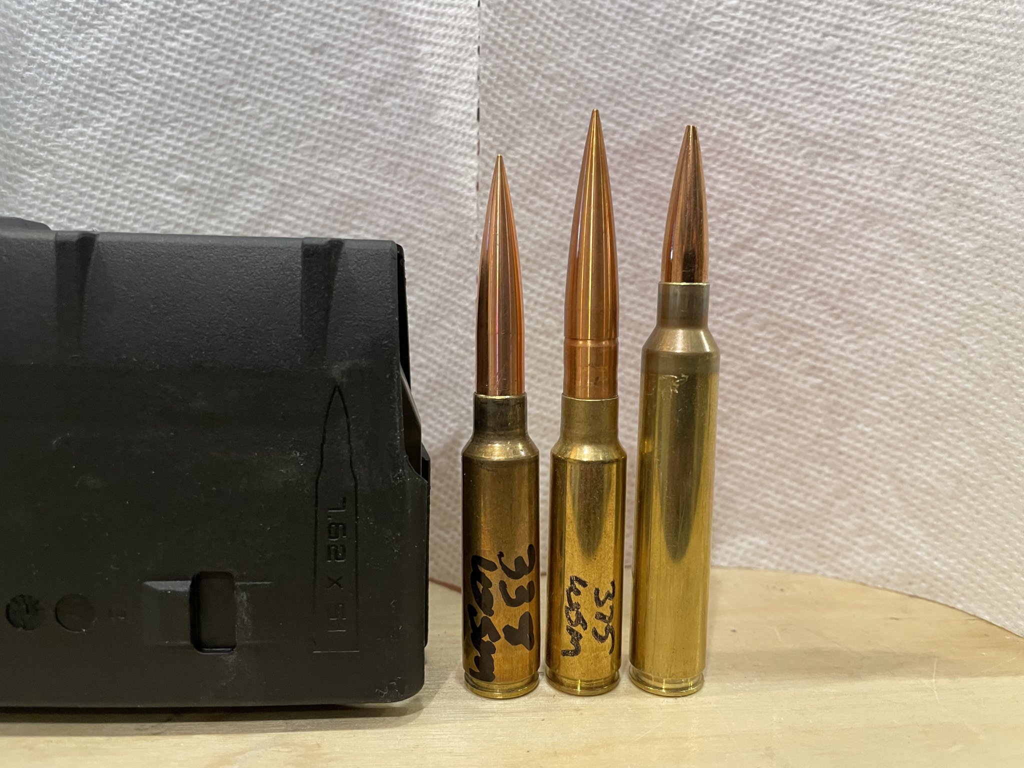

308 P-mag next to a mocked up 338 WSM case, with a Lehigh 338 257 grain … 3.63” COAL, that’s with the bullet barely sitting in the mouth of the case
Next is a piece of WSM brass backed up to 375 WSM, with a .375 353 Lehigh barely sitting in the case mouth 3.94" COAL
On the right is a 300 RUM with a 215 in it.
I’m pretty sure a 4.0” COAL is not going to work in a AR10 😁

OK… I’ll play along…
Here’s where you are going wrong
The typical AR10 mag has a max COAL of ~ 2.8”
That greatly limits the High BC bullets you want to use in the 338 RCM or 338 WSM
The seating depth of these long high BC bullets, seats the bullets WAY too deep into the case.
Which in turn eats up, or decreases the amount of powder, that you can fit into the case…
So then in turn the less powder the slower the velocity.
The “light” (130 grain) version of the 338 250 Berger you want to produce, will not fit into a 338 RCM/WSM case, while fitting into a AR10/LR308 magazine…
The bearing surface of the longer 250 Berger has to get pushed so far into the case to fit the mag…that the bearing surface no longer even touches the case neck…
The 250 Berger literally falls into the case, when you try to seat it to 2.8” (uh…I’ve tried it)
I’m giving you an A+ for curiousity…(seriously)
But you need to break out the micrometer, and have a little more knowledge of mag length limits, powders and reloading before you venture out into the AR10 world on SH…

You’re still not dealing with magazine length or bearing surface for a high bc bullet…. To get to your velocity requirement your bullet will have to be light-and what light bullet in those calibers has a high enough bc to be accurate at 2k yards?
Will the bullet fly past a mile? Yes but can you hit the broad side of a barn with it at that distance? Not to mention the energy levels would be very anemic.
