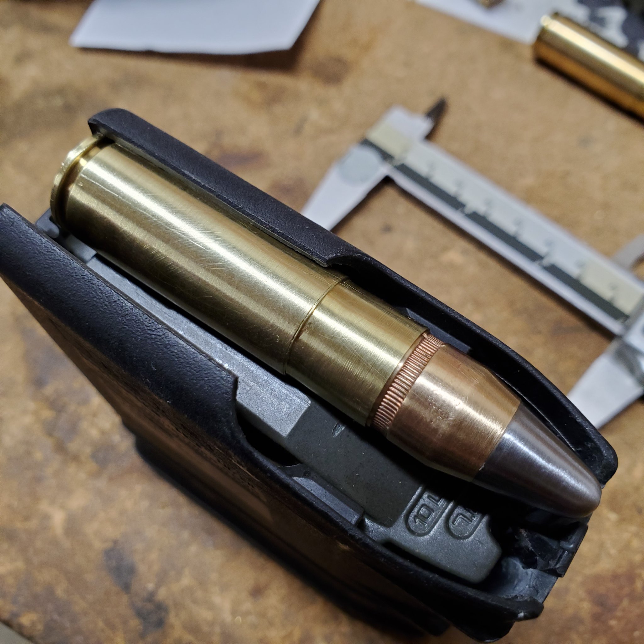

So here it is 510 whisper brass, can be purchased but expensive...(needs head turned and KAK 300 WSM bolt )with 550 gr bullet in 308 magazine, now all ya need is the barrel blank, reamer, barrel extension, opened ejection port, and a lathe to put it together. Single load the long 750 gr bullets, and you're good to go...

Ok, that 510 is interesting. I've still been leaning 45 Raptor, but finding a barrel that's not custom ordered or around $700 right now isn't panning out.
The 45 Rapter AR 10 is available for $315 16" 1-20 twist Satern Barrels, plug and play AR 10...but the twist rate is for lighter bullets, to 395 gr.
The 510 Whisper 10 twist barrel I have ordered will handle the 1002 gr the standard 50BMG barrel is 1-15 twist...but it has to be totally machined, chambered, etc as it's just a rifled blank. SSK has single shots available in a variety of calibers and their 510 Whisper, dies, and expensive factory brass.

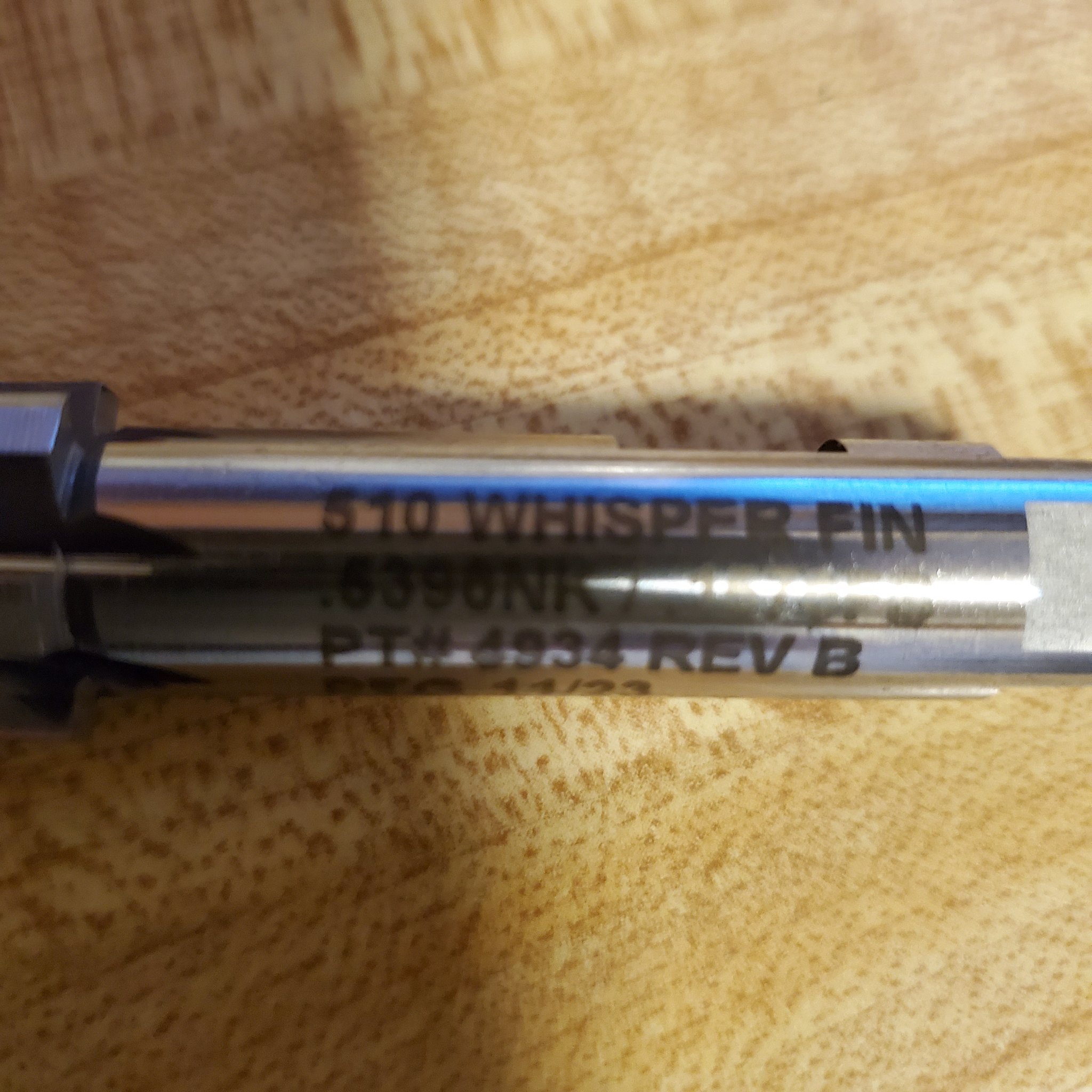

The 510 whisper reamer arrived from PT&G, a custom reamer in less than 30 days.... excellent job by Dave kiff and the people who work there. There has been quite a bit of negative on this site from time to to time but both reamers were here before the barrels. May have another 30 days or more on the barrels. Should be a fun winters project.
