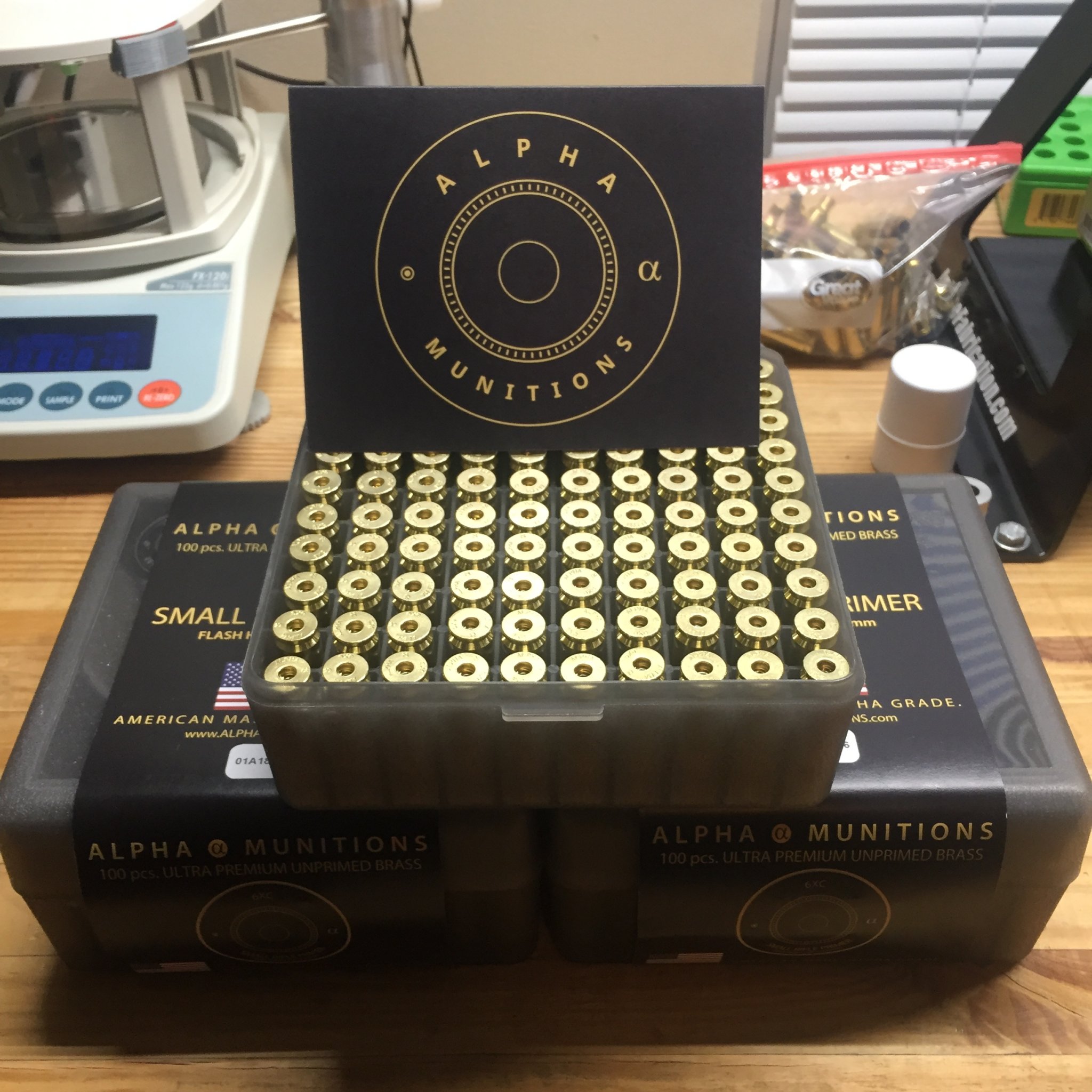

Until recently (last year or so) it was a lack of options in brass, I think. That's been resolved, though, and I am seeing more shooters picking up a 6XC to play with.
Hopefully this solves the brass issue with 6XC
