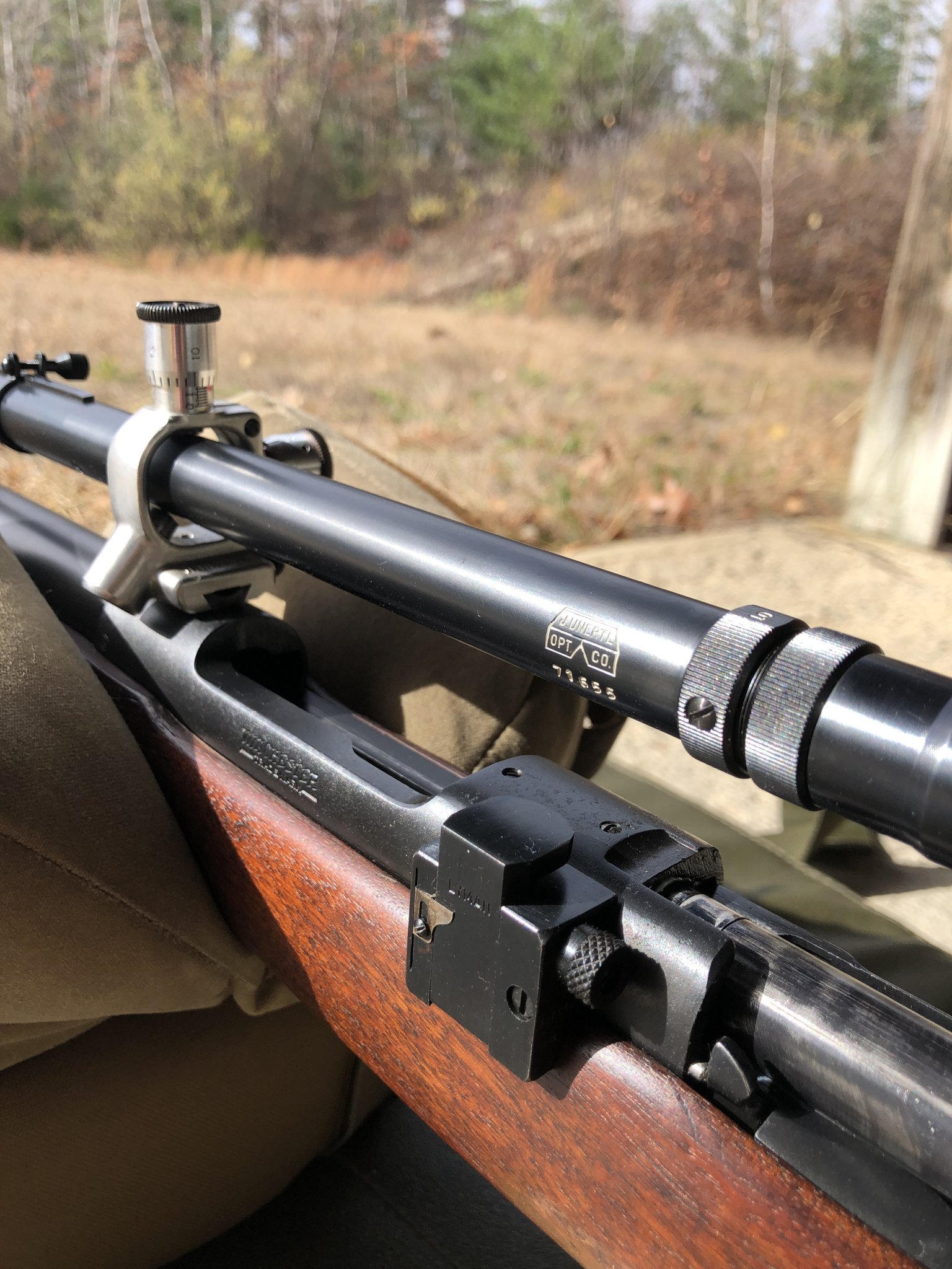

His third match all 200 yd. reduced. This is his first scoping all his own shots. He needs to get a little tighter, but he's improving well for 11 years old.

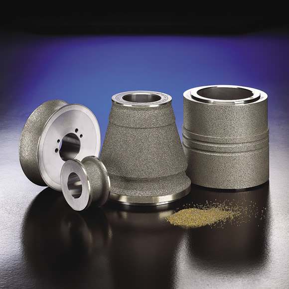

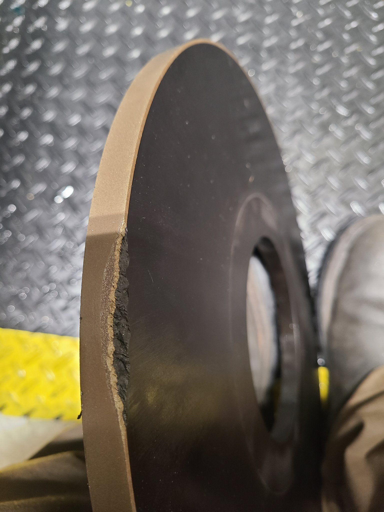

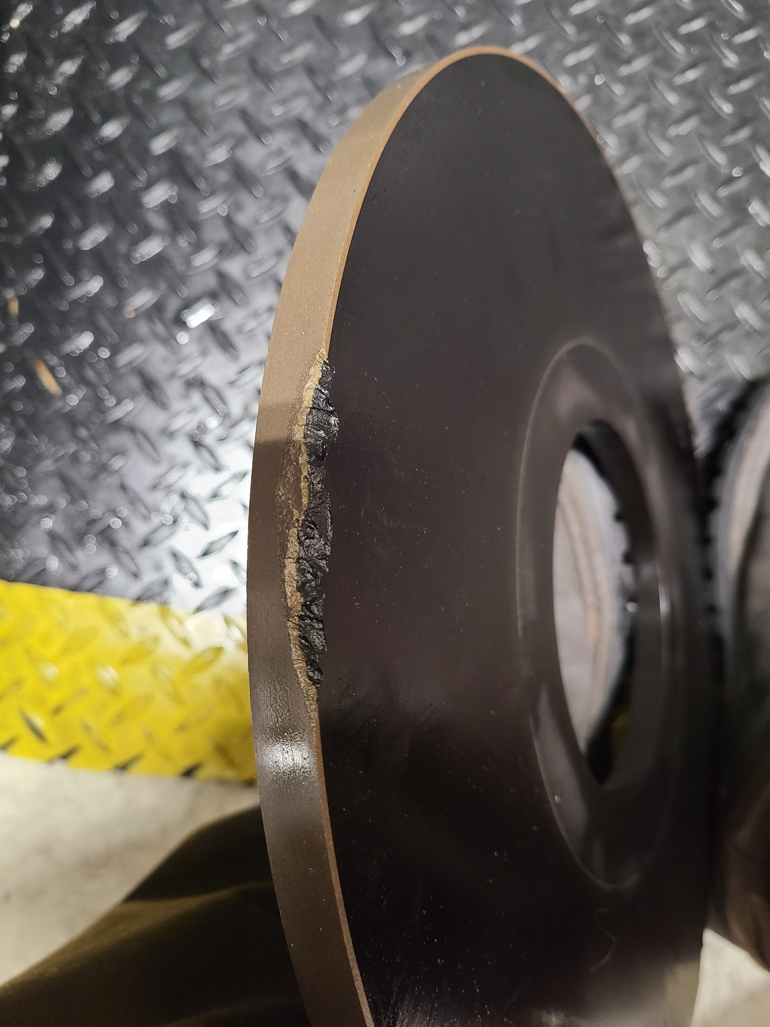

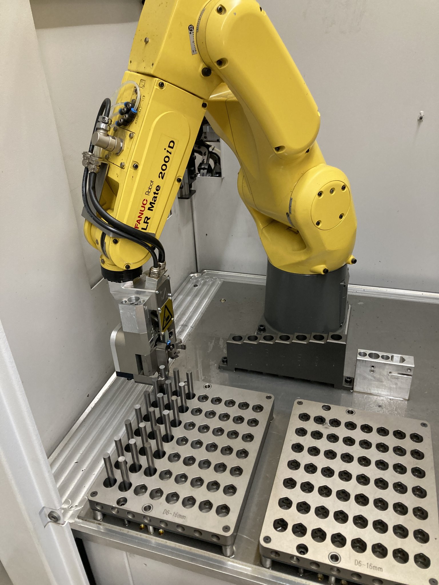

Never a good day at work when you come in to see that somebody dropped an arbor with a part into your spinning 1/2" wide 16" diameter diamond wheel taking a couple chunks out.
Took the time to check that the whole machine is aligned (it wasn't. 0.0005" over 3.7") and realign it (slightly less than 0.0001" over the same). Then got to dress in the new wheel. Took from 0700 to 1330 to start setting up on my first part.
View attachment 7996962Never a good day at work when you come in to see that somebody dropped an arbor with a part into your spinning 1/2" wide 16" diameter diamond wheel taking a couple chunks out.
I hate when that happens!
Cnc od grinder?
Cnc od grinder?
Yep. Aerospace machinist. 1986 Sheffield grinder last rebuilt 2002. It does straight wheels and crush form grinding wheels. It's replacement, a Studer s41, is being quoted to go along with the s41 we already have. The new one will have diamond form dressers vs the carbide ones we have now. Radiuses on the forms should last in years vs less than 100 partsish.
Internet picture.
The wheel takes on the shape of the roll and transfers to the part. Having taper off makes getting parts in size hard especially when you're running +-0.0002" on some parts. In inconel.
