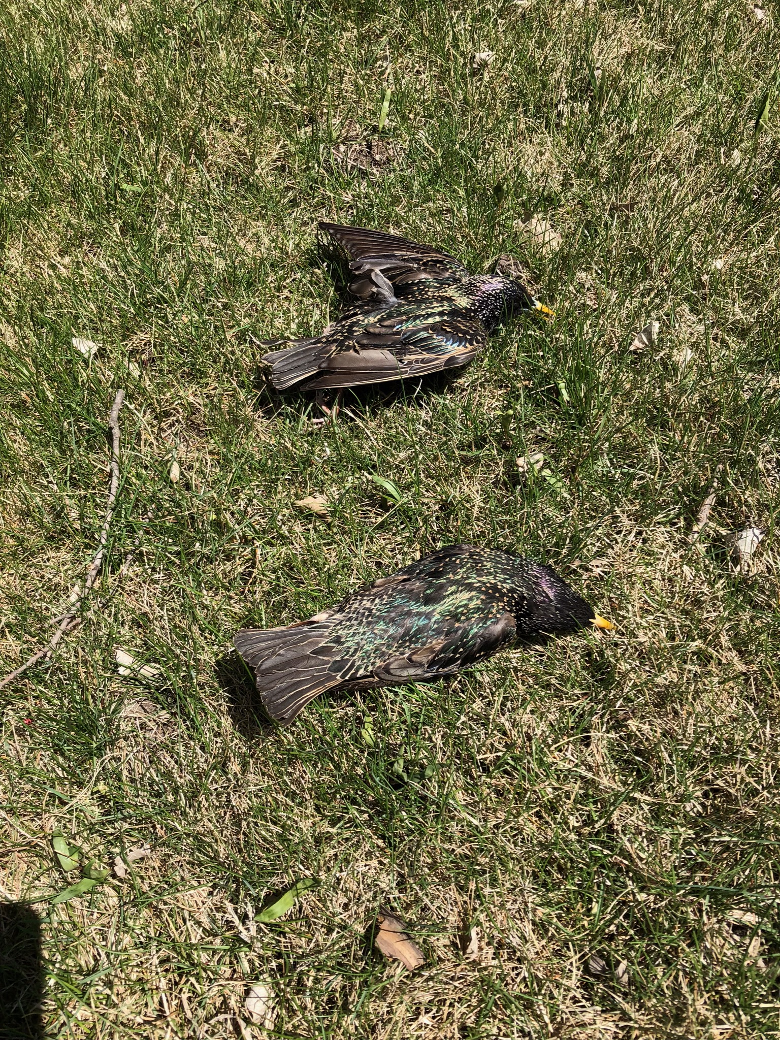

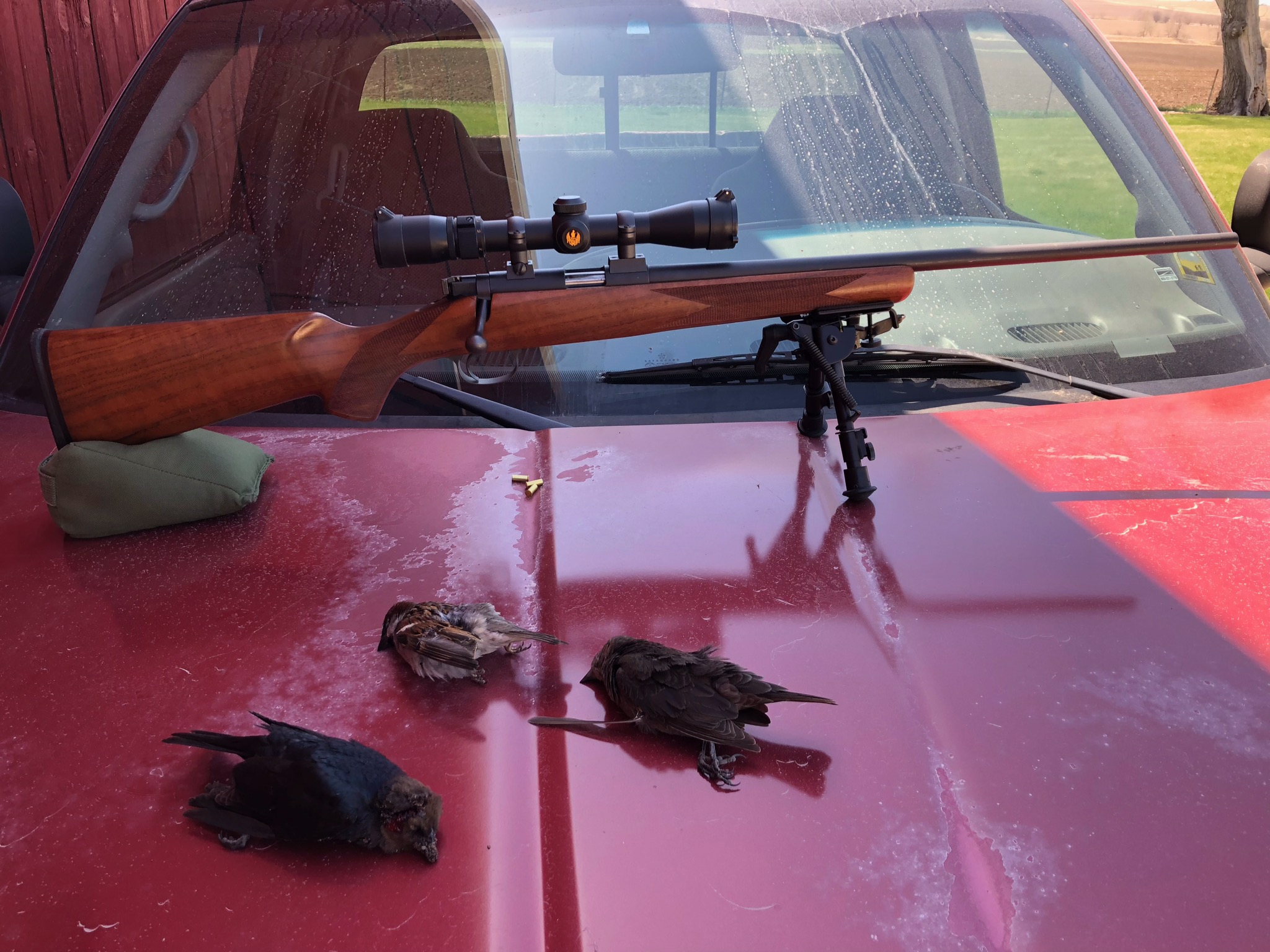

Spring has arrived and along with it the undesirable bird species. Starlings, cow birds, sparrows, etc... Alternative position practice the way I see it. From the shadows, bedroom windows, kitchen windows, you name it. Couple pics from yesterday and today, including the lunchtime daily double.
View attachment 6899219View attachment 6899220
They look so peaceful. :cry:
Nice job Mr. Nichols. :D

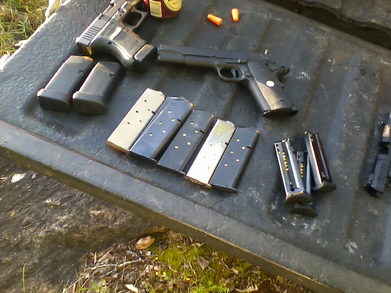

I was looking for info on 1911 mags recently. @Mike 556 says send me your info and I'll send you some mags. I send my info fully expecting him to SWAT me, cause I'm an asshole and probably deserve it... No SWAT, but 6 mags show up. Big Thank You Sir!

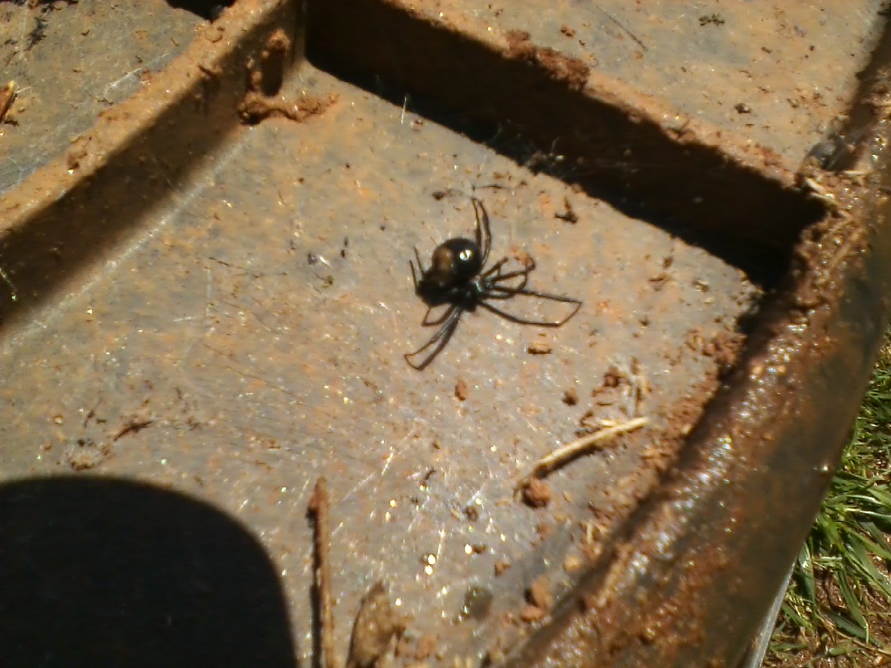

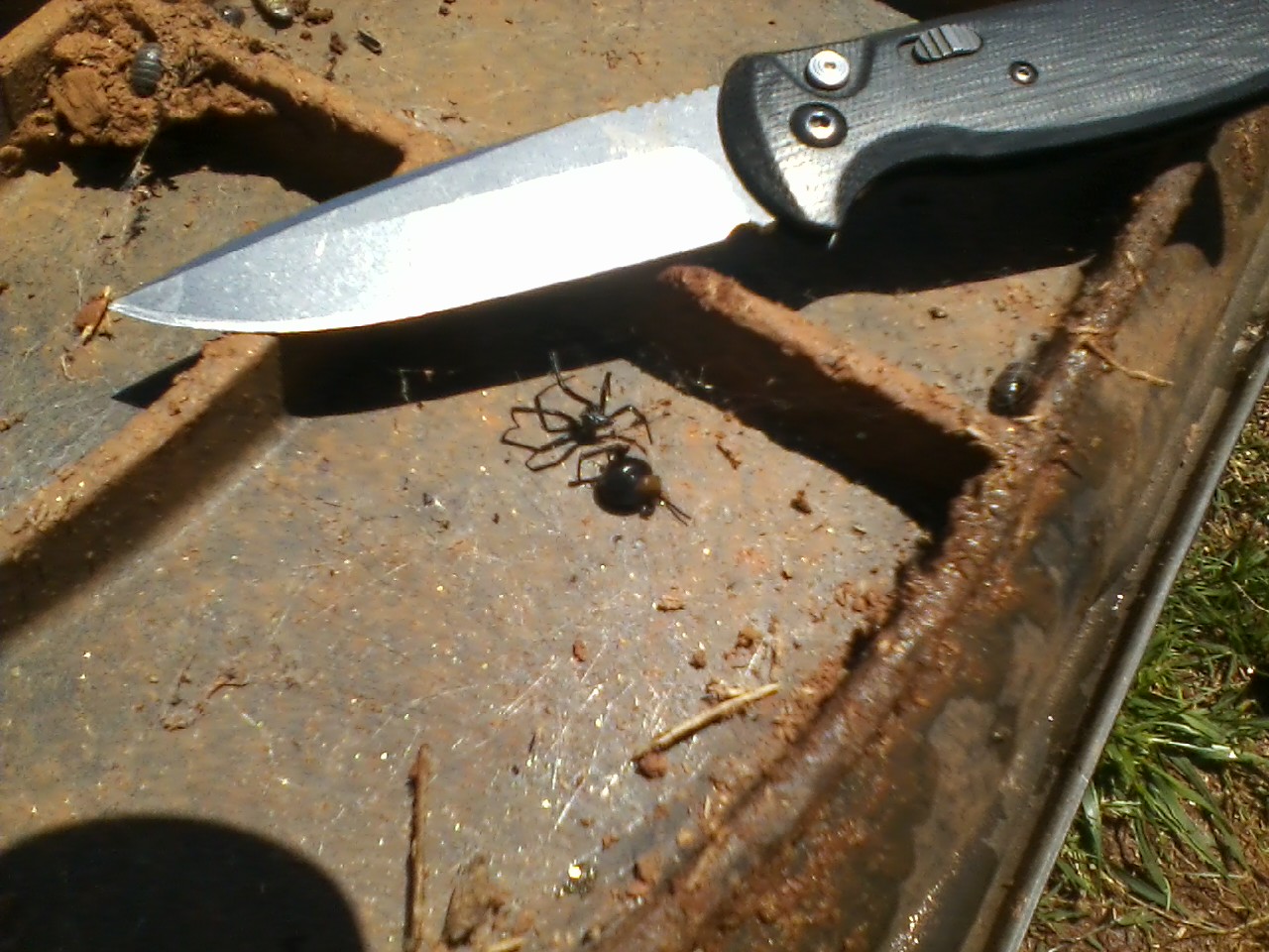

Spent a good bit of yesterday doing maintenance. Stapling where needed, straitening gates, washing out tanks.
If you flip over a tank, flat rock or piece of wood around here, it's going to have one of these bitches under it.

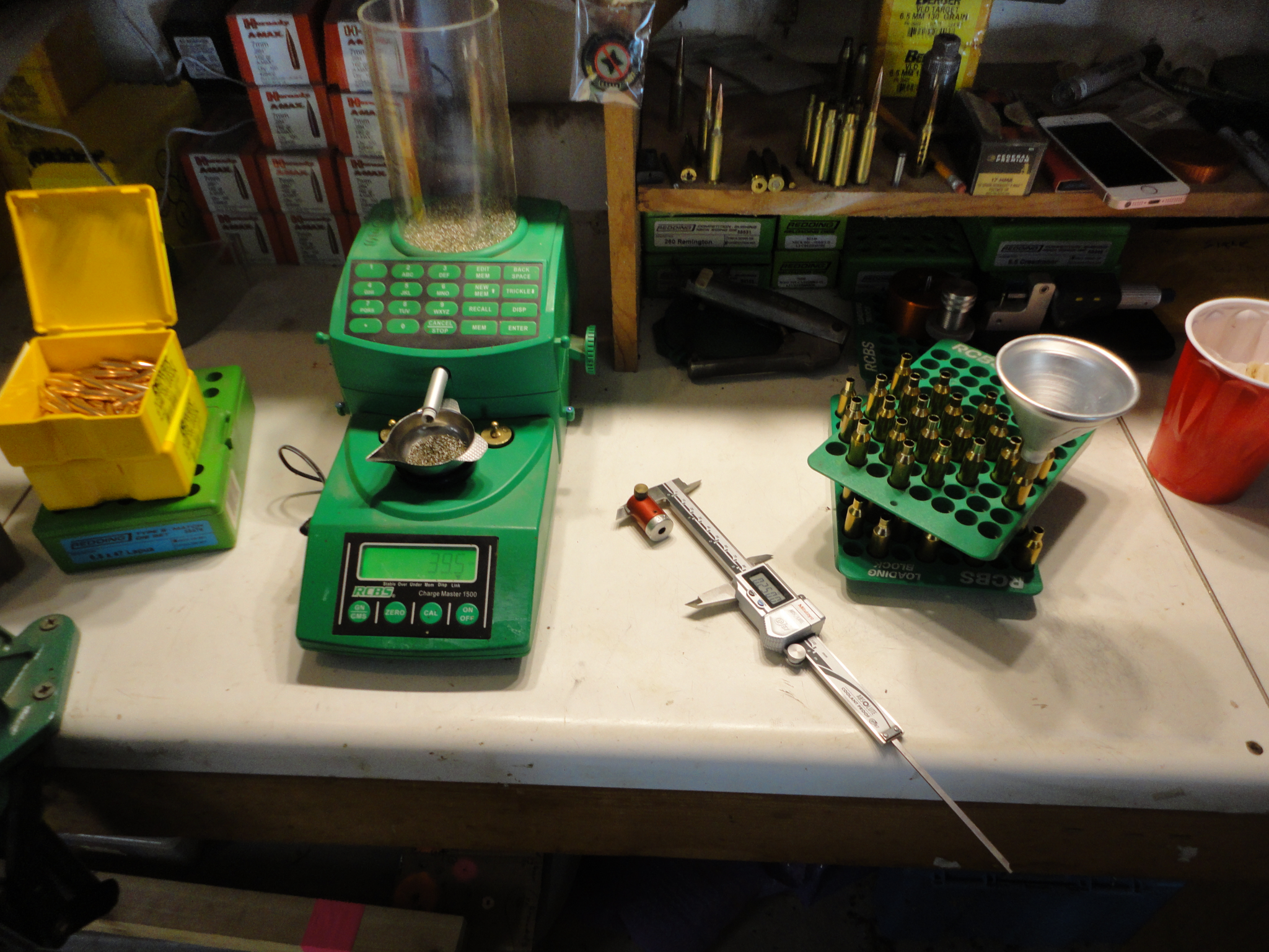

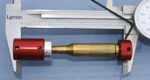

Using a comparator measures off the ogive for increased measuring accuracy.
The "metplats" are usually plus or minus .002 or .003.
I bought this set a while back, Hornady makes a decent one.

Yep, OAL variations suck less by measuring the way that R is doing it. Your seating die seats on the ogive (or close to it), not the bullet tip. Much better way to go.

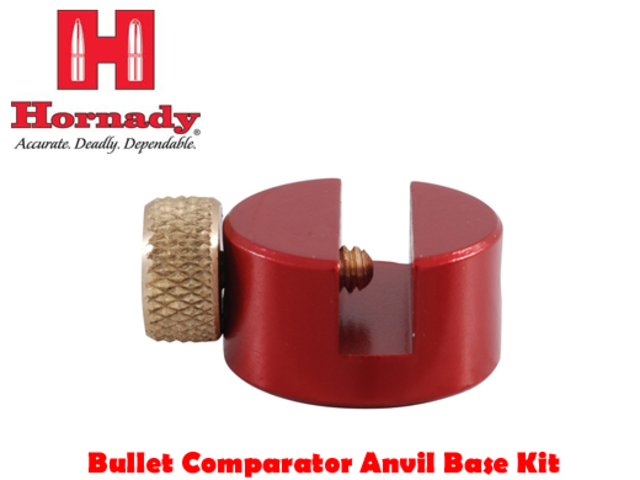

You're killing me, but thanks for the info. :LOL: The Anvil. I started using it some years ago and like it.
I've not used the anvil. Are they recessed for the primer?
lol NO!!! Who measures CBTO with a primer in? lmfao You guys are killing me. And remember, it's a Hornady product. ;) I don't think I've measured off the meplat since the 70's. :unsure: But that's got nothing to do with the Anvil. :)
WTF. Nobody at Hornady could figure out a recess for the primer would allow accurate measurements of cartridge headspace without needing to de-prime first. That’s dumb ass hell for a group of otherwise talented people.
Most brass I've ever dealt with the primers are about .003 under flush on the head.
The above were measured with primers installed.
R
You're funny today. But ONLY today. :LOL:
R
And there ya have it. "If", as we know, the primer is seated correctly "without" crushing the anvil of the primer, hee hee hee there's ANVIL again. Anyhow, you guys already know.
I can see the Anvil from Hornadybeing used with their headspace gauge for after firing. A lot of guns leave part of the primer sticking up after firing. For BTO it wouldn't be needed

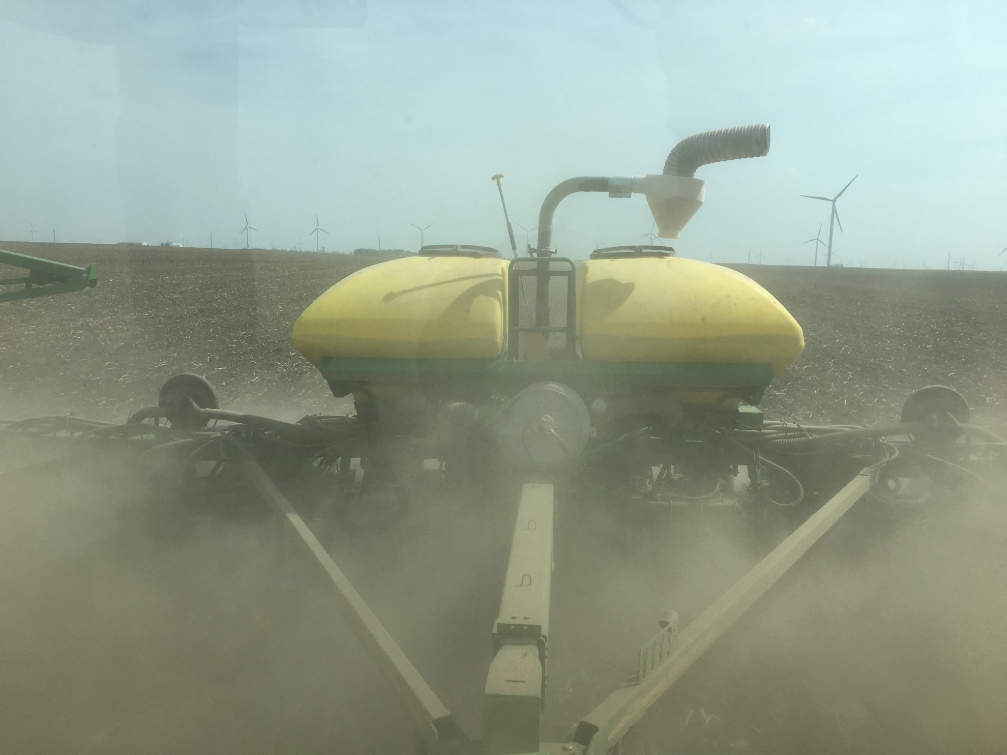

Trying to finish planting beans so I can get back to my regular schedule of dicking off.
When I was young i would get pissed when spring rolled around the farmers show up with a corn planter rather than a bean drill. I wanted all bean fields around me to shoot ground hogs. How dare they plant corn!
