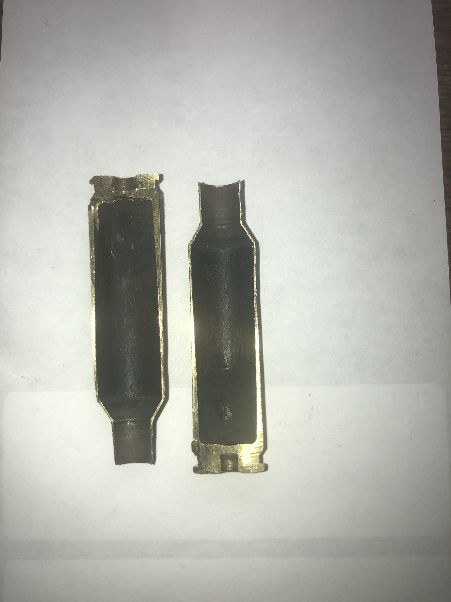

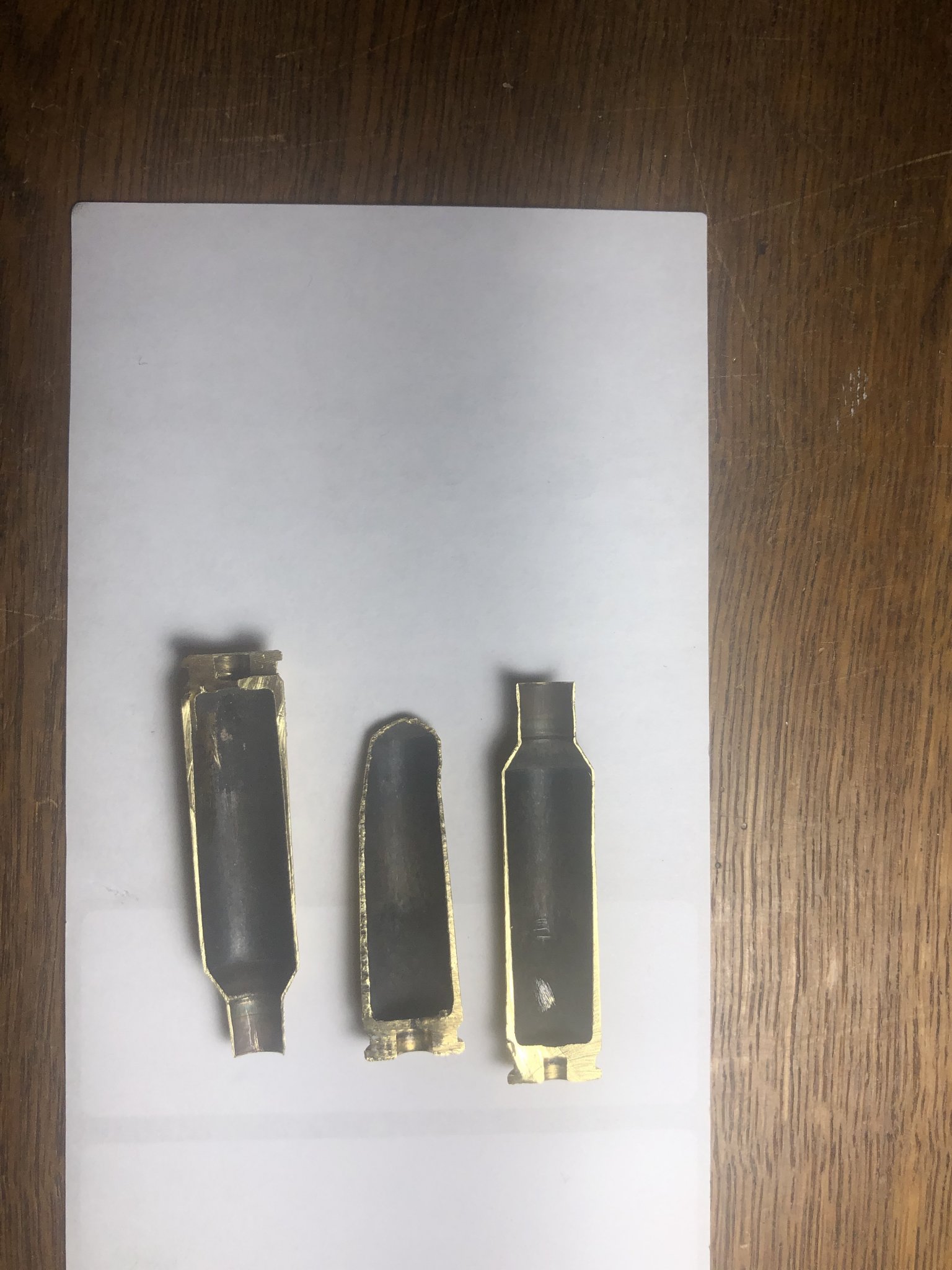

Have reloaded one of the first Lapua 6.5 Creedmoor batches and got 24x reloads so far. Primer pockets are still tight. SRP brass. Cut two open cases with a Dremel tool. No sign of head separation. Brass was neck turned and of course as per the K&M instructions i intentionally cut a little into the shoulder to avoid future donuts. That “negative” (inverted) ring eventually moves to just beyond the neck shoulder junction, so on the neck, making the brass thinner where the neck connects with the shoulder. Is this a problem? Enough reason to retire the brass? It was mostly neck sized via an LE Wilson hand die. Used a Redding Type S for FL sizing every 4 shots.
Either when I see just one leaked primer (I hate bolt face pitting so I have a 0 tolerance policy for loose primer pockets), or the ring of death starts to get deep around the web.
I do exactly what you did and cross section a case if my modified dental pick isnt sure how deep the stretching is getting.

Not sure if you can see that in the photo, but there is a carbon deposit on the first 0.4” of the case (above the head). I wonder if this affects internal case volume? Scraped it off in two places and if i have to guess, i would say 1 to 2 thou in thickness. Rest of the case has minimal carbon deposits. Sharp boundary between the two. The thick part is soft and flaky. Mostly used H4350.
I have stopped ultrasonic cleaning over a year ago due to high SD causing accuracy problems probably due to ‘bullet weld’, if that is indeed the correct term. Result was highly variable neck tension if i seat long, wait 3 weeks and then reseat. So now i use a tumbler. Media is a mix of corn cob and walnut. Bought it untreated, but i added a teaspoon of mineral spirits to suppress the white dust (which also seems to dissolve carbon, so outside if now very shiny, inside still has carbon in the neck - which i believe is desirable). And a small amount of Nushine car wax.
Should i worry about this? Did not notice a speed difference. But ambient temperature here in Texas varies a lot, so i probably would have blamed that. Pretty sure 30 minutes in the ultrasonic cleaner (i realize that is very long!) will surely take care of that, but then i have to worry about neck tension again.

OK, came up with a plan: Weigh the dirty-on-the-inside case on the FX120 down to 0.02 grain, clean the heck out of it in the ultrasonic cleaner, for an hour if need be, dry it and then weigh it again. Since the outside is already shiny clean, i can assume that all the weight loss is from removing carbon from the inside of the case. Will wipe the outside with alcohol to make sure there is no mineral spirits clinging to it. Take an average diameter of the case halfway up, and do the calc to determine average thickness of carbon layer.... Get density of powdered carbon from a materials table. Should work! If less than 0.5 thou, i am not going to worry about it...
Could possibly clean the inside of the case and get all that flaky carbon out with a bigger nylon brush installed in the Lyman case prep tool.... or maybe my OCD is kicking in!

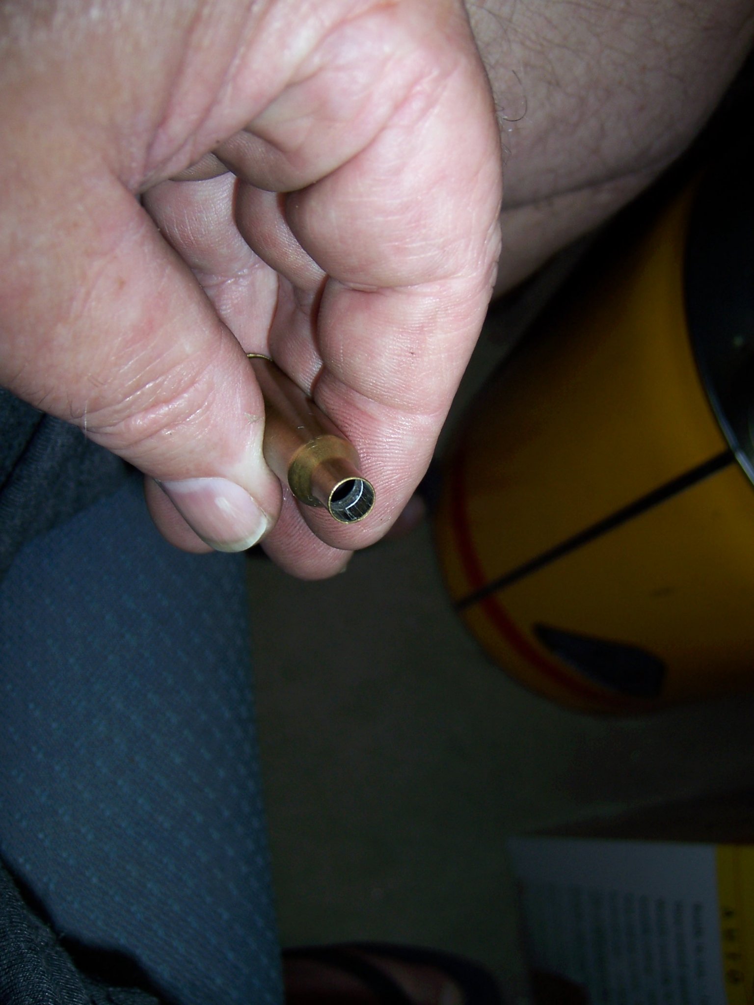

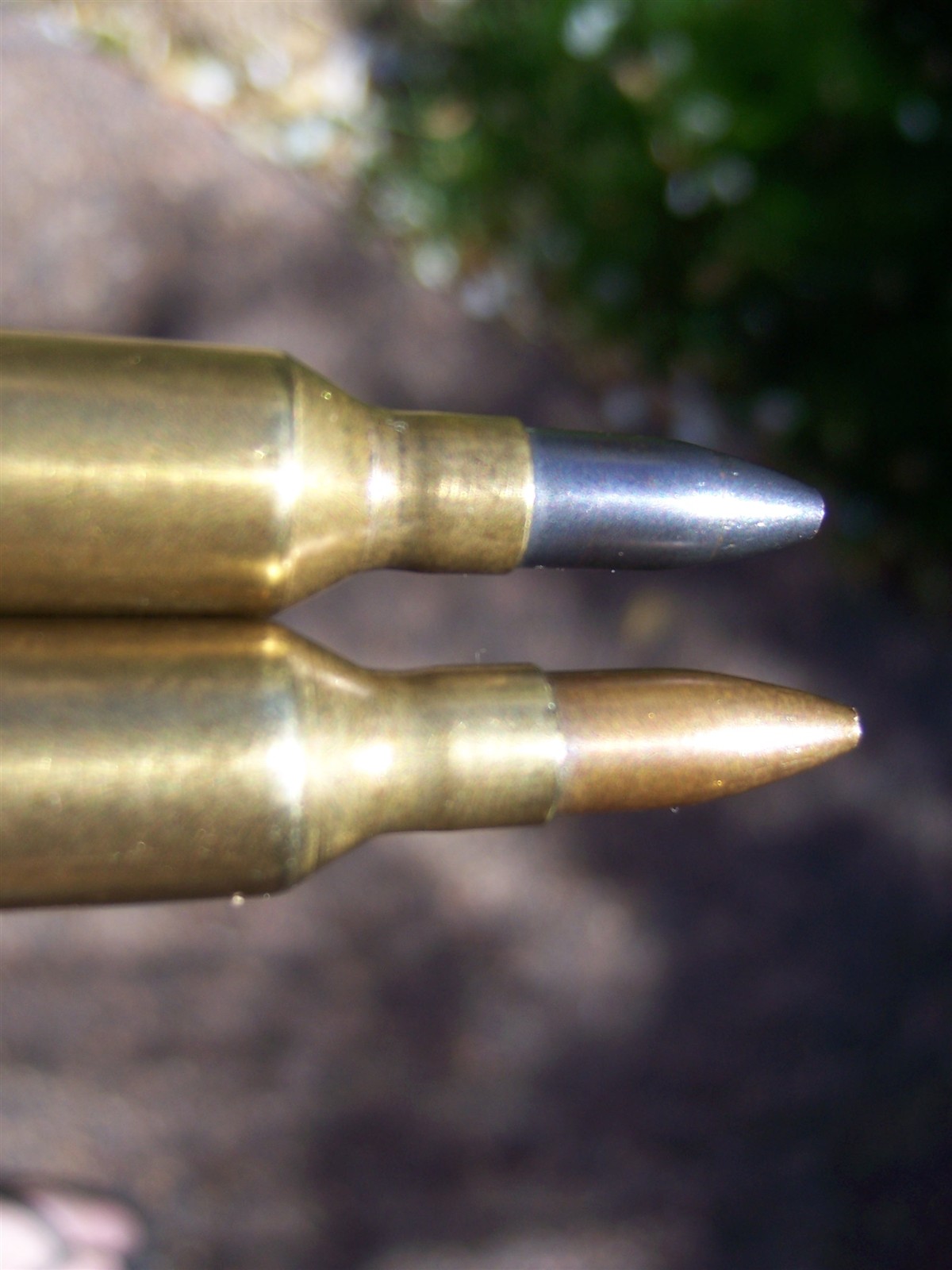

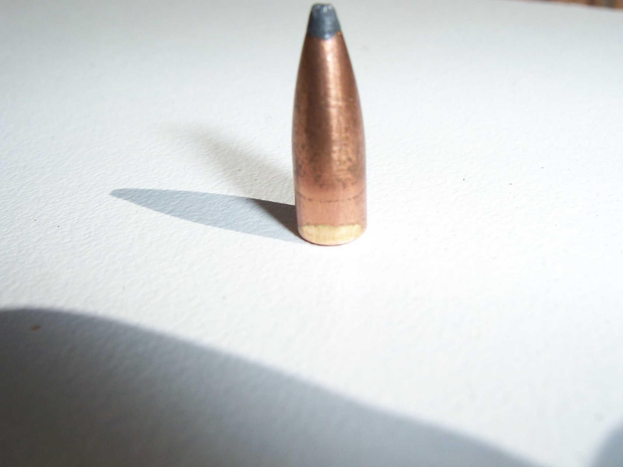

Are you using a caustic solution in your Ultrasonic cleaner because if you use anything like that it will harden the brass anything like ammonia also . Use an organic acid solution . like orange juice .
Carbon inside the necks is not good and contributes to neck weld because it is slightly corrosive and gritty ,
After some time loaded the neck starts to shrink due to the stress corrosion of brass . This higher neck tension in some cases will fuse parts of the bullet jacket to the case neck . The effects are higly variable and only a few in batch might do that over years . However variations in neck tension start from day 1 in any loaded ammo and get worse as time goes on . I did a 10 year trial of different ammo loaded and stored for 10 years . The one single most obvious finding was that moly coating fights neck weld and every mollied bullet fired and pulled fine . Bare inside necks suffered a few fused necks in parts of the bullet usually right at the base edge and varying neck tension , dirty necks were not welding as much but neck tension was very high . I also deduced that air and moisture in the air enters into the case neck down beside the bullet increasing electrolytic action and the ultimate negative changes . You can see the shrunk necks and the pressure is pushing the bullets out of the case . These are reloads so better sealed military ammo would last better and factory ammo with sealer in the necks would also . The Military fire off or sell their ammo at about 7 years . That's a 10 year old moly bullet that with a bit of a wipe looks like it's brand new . Accuracy could not be properly tested because I was just plain scared to fire some . However I did take 20 moly rounds to the range and they shot normally but doubled the normal group size and had a few spit necks . After that I did not want to fire anymore .

The bulge in your cases look scary, must have been very high neck tension. If i understood you correctly, they were not looking like that at the time you loaded them? So the necks actually shrunk in size over many years?
What is the ideal way to avoid bullet weld? Apply a bitumen liquid to the bullet, like the military ammo?
The ammo was normal neck shape when loaded . This is an extreme case over 10 years but it does show that this kind of thing is going on to some degree in all brass . A proper moly coating showed quite clearly that it fought neck weld and high neck tensions . This test was mainly done to test Moly coating performance for my Moly coating process . Most shooters are not going to leave their precision loaded ammo in a box for 10 years . A few things that make the problem worse . Old harder brass to start with . Projectile not sealed so air can penetrate over time . No coating on the bullet . If you use new brass with nice soft necks , moly coat the bullet and seal around the mouth edge of the case and bullet with a thin edge of some kind of lacqer then the effects would not be as dramatic .
However the fact that the case neck is under stress ( tension ) from the seated bullet means that stress corrosion will start to some degree at some point and that hardens and shrinks the brass mainly in a radial direction . Carbon inside the neck does seem to fight actual electrolytic adhesion of the two metals , bullet and case neck . but it holds on harder because of it's gritty nature giving higher neck tension than moly coated bullets so it's a yes and no answer .

The 7,62x39 is an interesting subject. Common as the breeze, it's found in a lot of places.
But it's actually two calibers, literally; and I prefer the less common one, with the .308 bore.
I had bought a Savage 10FCM Scout 7,62x39 quite some time ago, before the current Savage Scout replaced it. Intending to do a barrel replacement to a PPC chambering; I paused to do some rudimentary load development using the .308 V-Max, since the Savage employs the .308 bore.
That was the end of the PPC project right there.
The x39 case and the 110 V-Max are made for each other, and were probably the subconscious lead-in to my current relationship with the 6.5 Grendel.
