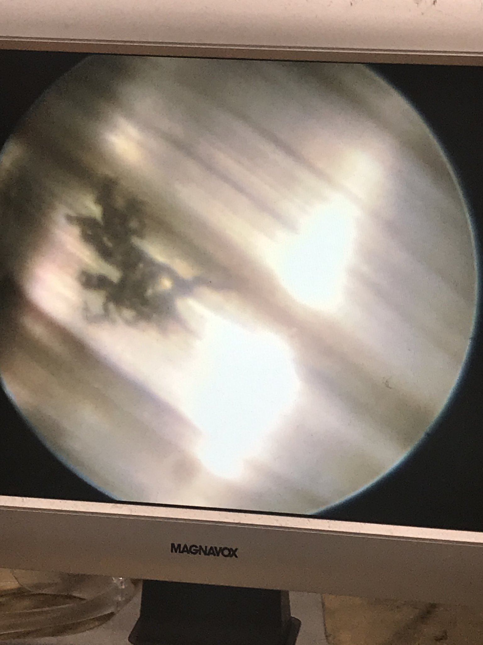

Also don't put your gun away dirty for any extended period of time. Yes the barrel might be stainless steel but it is not surgical steel. It will corrode/pit from the fouling in the bore (copper and powder) and will react with the moisture in the air etc...and I will guarantee that it will corrode/pit. For some it happens faster than others....but it will happen.
See picture attached....Brady here put 22 rounds on his AR a few months ago and put it away dirty. This is what happened....and it's in random spots thru out the length of the barrel.
Later, Frank
Bartlein Barrels
