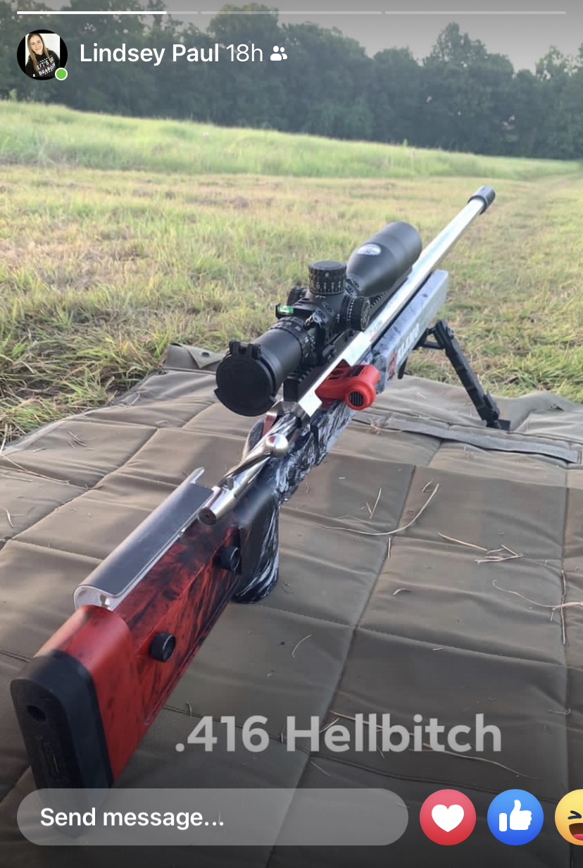

Guess the Tx shooters are bucking the trend…
  • Wow
Reactions: BCX and coldboreAU
