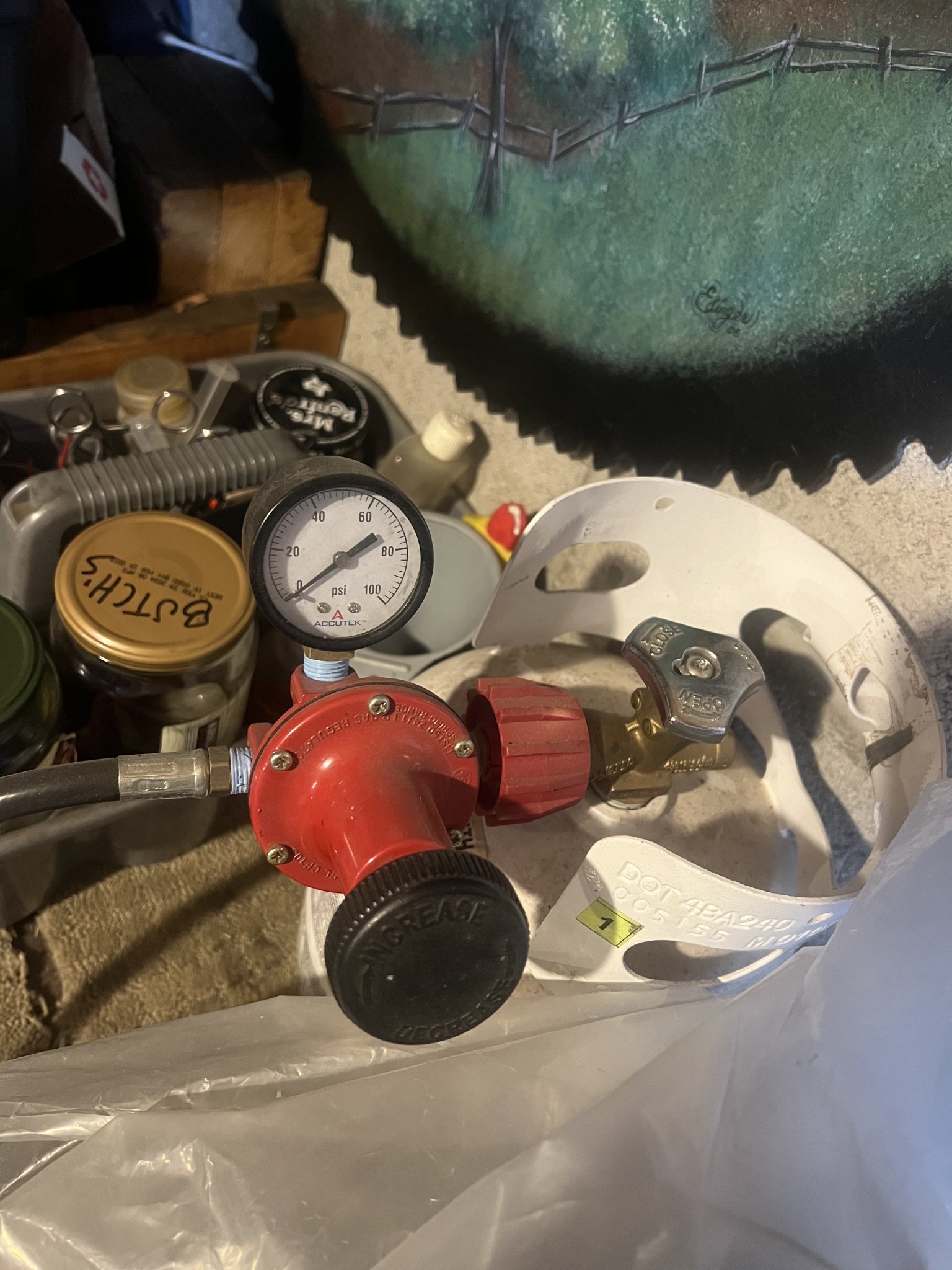

What Regulator do you recommend? My Bernzomatic UL2317 pencil flame torches wouldn't light with a 20PSI Reg it apparently wasn't enough to force the torches check valve open.
I got this one from a barbecue supply store in Texas. I probably paid too much but it is high-quality. If you’re handy with these things, you could splice one together yourself or have the local propane shop do it

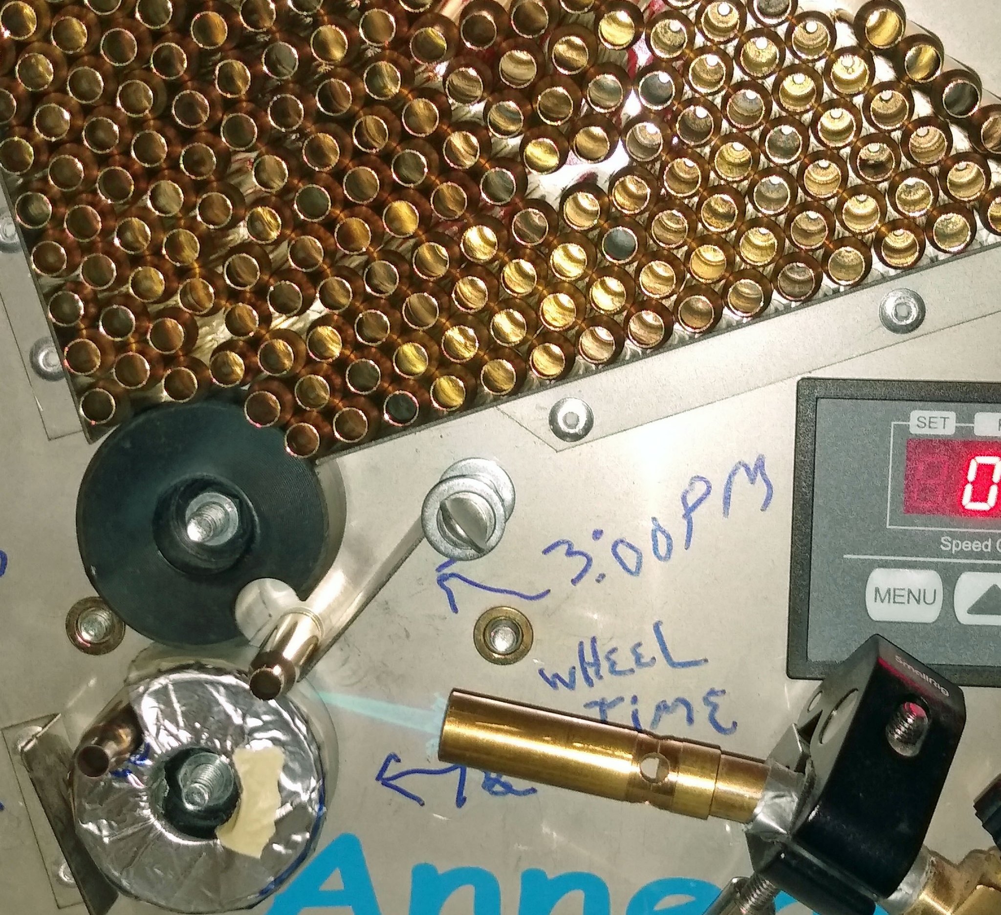

No auto feed
This is just my experience and opinion.
IMO you need a machine to get a consistent anneal... those that use a handheld drill method..... I'm sorry but the location of the flame and consistent time in the flame isn't consistent... machine will get you that consistent anneal.
I've used annealers with hoppers and got tired of swapping out parts and by the time I fiddled around with swapping parts and filling a hopper WITH bridging issues and brass not spinning correctly, I was already well into annealing with the EP 2.0 annealer. Especially if you're like me and usually reload 100pcs or less (most hopper annealers usually can't hold more than that anyway depending on size of case). Having a hopper doesn't make it a faster process. If it takes XYZ time to flame base anneal XYZ brass, then having a hopper is just something you need to fill up and then start the process of annealing. Not like you can fill up a hopper and go mow the yard while you have an open flame. You still need to watch the process. If it takes 5 to 6 seconds to flame base anneal XYZ case with a single torch then it still takes 5 to 6 seconds to anneal XYZ case regardless if it has a hopper or not. Just for example..100 anneals at about ~6 seconds each is 600 seconds. 600 divided by 60 seconds is 10 minutes which is a drop in the reloading time bucket IMO. You're still handing each pc of brass.
If you need to pick up the brass and manually orientate the brass in the right direction and fill up a hopper and then change out parts to go from cartridge to cartridge then IMO it doesnt really matter if its single feed or has a hopper, and I'll take the speed of the EP 2.0 change over from cartridge to cartridge that can go from 5.7x28 (down to about 1" inch long which is hard for a lot of annealers) /17hornet size casings to 50 bmg, rim or no rim it doesn't matter, and adjust in seconds without having to add or remove any parts. Very very small footprint also. Pure KISS method.
Now,,,,,,,, if the annealer had a case feeder where you don't need to orientate the brass manually and the machine can orientate and feed the brass for you where you're throwing in handfuls of brass,,,, then that's a whole different story but to get a case feeder (not a hopper = big difference), and can adjust from 5.7 to 50bmg on the case feeder too = cost money and would be very complex... once again just keep it simple stupid IMO.
As a side note, I wouldn't want my torch head mounted... for the sole reason of going from cartridge to different cartridge size. It's fast and easy. Move it, leave it, and forget it...
For someone that has used both,,,, it's my experience and hopefully this helps & why the EP 2.0 doesn't have a hopper = IMO it is really not needed and I'll take the ease of adjusting from different size casings with no extra parts / no tools needed. I just found myself not using my annealer with a hopper & kept on using my OG 1.0 DIY annealer = the EP 2.0 just made it adjustable with no tools needed.

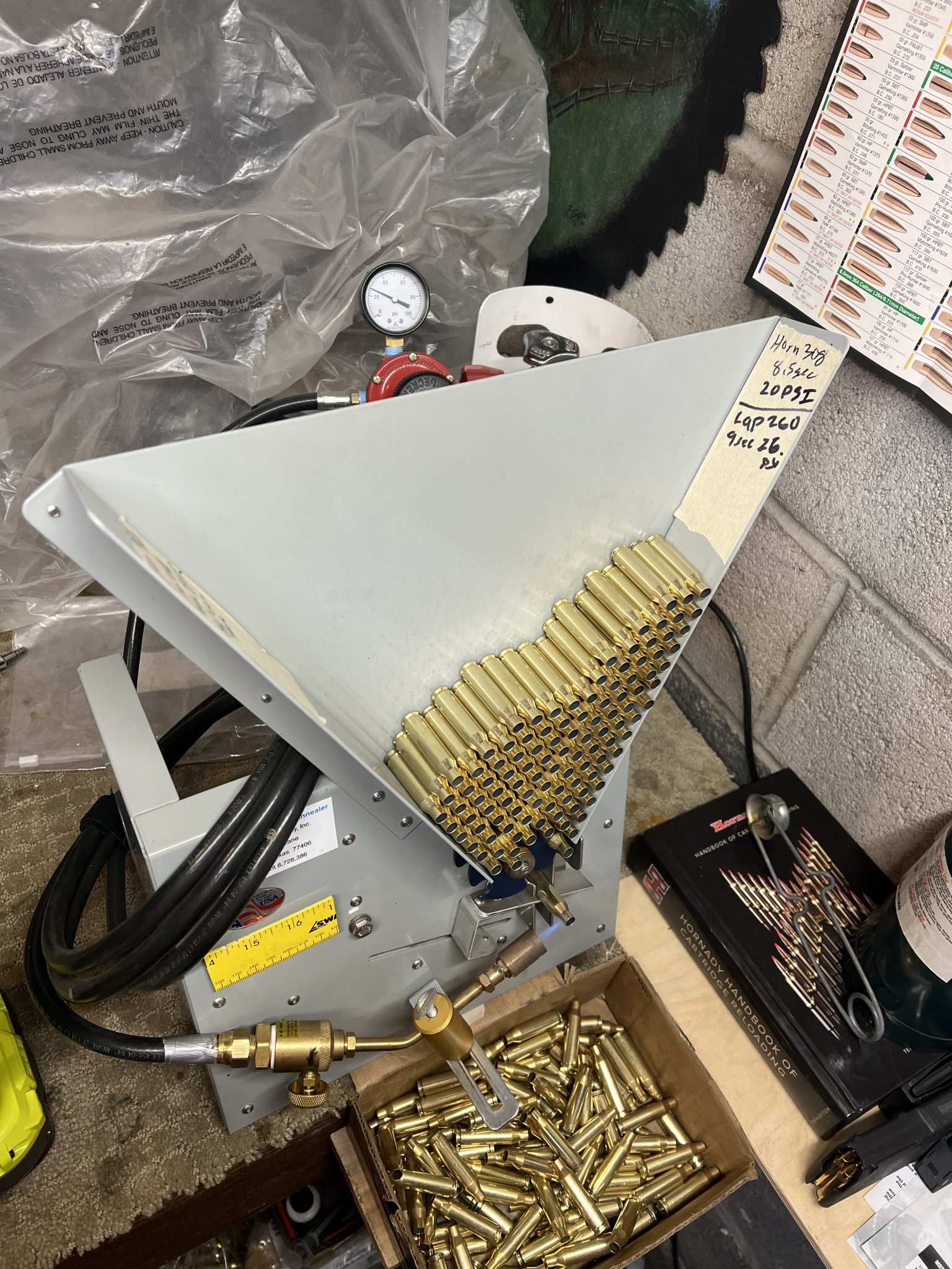

I have the Giraud with a massive hopper. I load it with several hundred 223 or 308 and let it rip.
Not only faster/easier but saves me the mental torture of doing volume by hand

One thing I figured out yesterday by accident that should have been obvious much sooner, is that with my Giraud and the regulator, I can change the pressure and leave the dwelltime the same to account for differences in brass. For example, my 308 Hornady brass was 8.5 seconds at 3/4 of an inch torch head from neck and 20 psi. For a Lapua 260 case, that was going to be like a 14 second dwelltime so I turned up the PSI to 26, and it took the dual time right down to nine seconds.
So I think from now on, I am going to shoot for an eight second dwelltime and just adjust the PSI for whatever case I’m annealing
At some point, the torch probably maxes out, but I haven’t experimented to find out what PSI that is yet

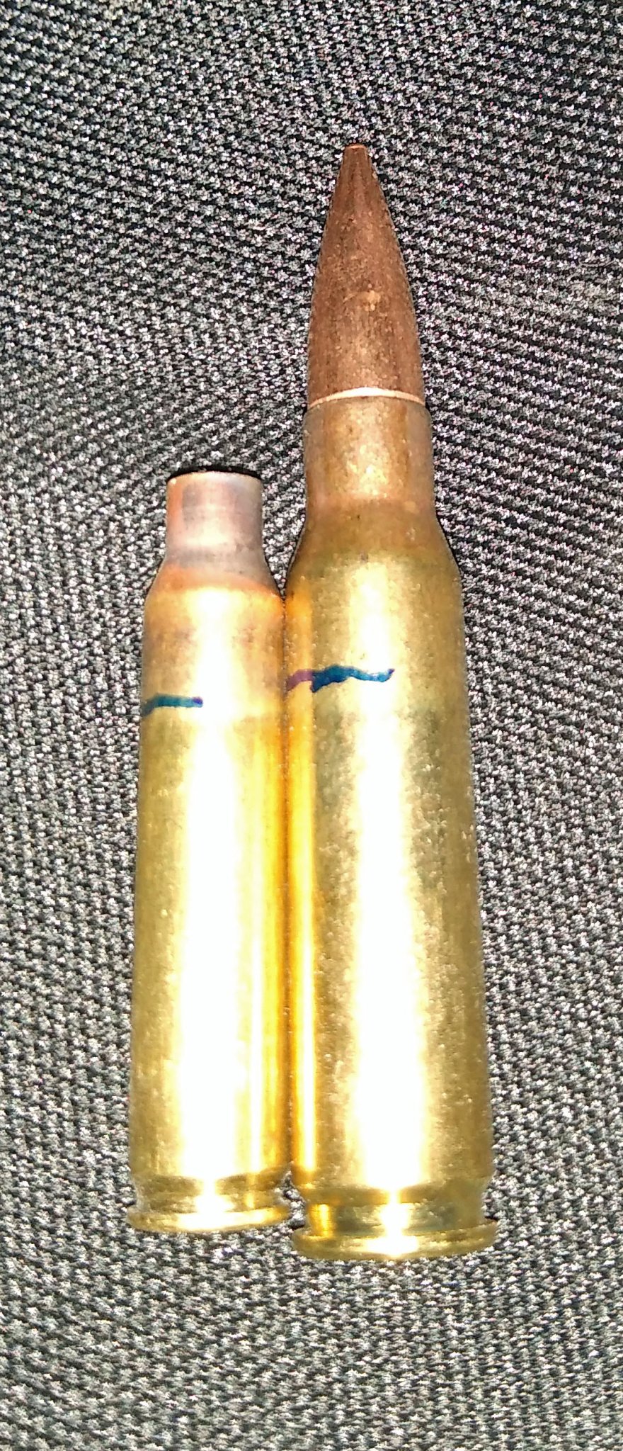

The hottest portion of the flame is 1/16- 3/32" in front of the inner blue cone , are you getting any brass discoloration at all ?.
It's hard to see and I'm wondering if any of your shoulders are benefiting whatsoever , as the flame is mid throat on necks .
Not trying to criticize just helpful . Photo attached is Lapua Factory Brass ,which has been polished after partial annealing and you can clearly see where I pen ink marked and above is still discolored . From neck mouth down 0.510- 0.5680" is visibly discolored .
Here's a link that shows what brass should look like after partial annealing . Here's a video showing an actual case being partial annealed ,using their induction heater . " Note the color of the brass prior and after partial annealing takes place :

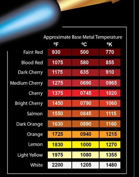

I borrowed this video from a poster here on the Hide ; Cherry Red ,His words and observations . Exactly why I don't run an induction anneal-er ,can't reliably feed it so it self runs . Otherwise You bet ya quick precise enough .

Using a larger tank and distant regulator does two things, it keeps the gas in the tank from warming up and changing during your session, and it also keeps the regulator out of that heat.

YES & YES provided the brass neck and shoulder get 1200-1300 Deg., F or as they turn orange to Red ,that's ALL that's required .

Sorry for the dumb newb question but, regarding hitting target temp….. can I just use a digital infrared temp gun to know if my flame and dwell time is where I want it?
Wow, lots of good info here. I’ve been reloading for about 10 years with mostly LC, Fed or Win (all once fired factory loads). Have always wondered about annealing but the juice didn’t seem worth the squeeze, especially with low grade brass, considering I get repeatable practical accuracy out of a batch to almost 10 firings (never pushing them too hard). Put the first “money” into new 6ARC Starline and 308/6.5 Peterson brass over the holidays and want to get as much out of them as possible. AMP is out of the question as a matter of value proposition for me so it will be flame.
I have a digital infrared temp gun and NO . . . it just not reliable when your dealing with the flame and the case neck temperature at the same time.
Because you can get a decent idea of the metal's temperature by it's color when it's really hot, the best method is looking for the red glow in a darkened room. Look for when the neck turns red and after about 1 or 2 seconds, then have the case drop out of the flame. The case will cool off quickly due to it being a thin metal. Heating it to over 1,000°F (note 650°C that's recommended = 1200°F) for just a couple seconds will give you good results.
Here's a color chart that can give you a good idea of temperatures based on color:

What Secondofangle2 said .
Flame will read on digital thermometer Not brass ,so don't waste any effort .
Depending upon which flame anneal-er You purchase , many are time-able . So depending upon what caliber You're doing time varies .
Object is pointing flame from the shoulder too Neck ( IF possible ) IF it's a Bench source it's not as cases carousel between two torch flames .
What You or anyone else wants to see is ,your Case neck glow orange dull red and it's Good to Go . Full red gets close to melting point ,so avoid that by pinpointing the flames mid neck on carousel anneal-er seems to work well .

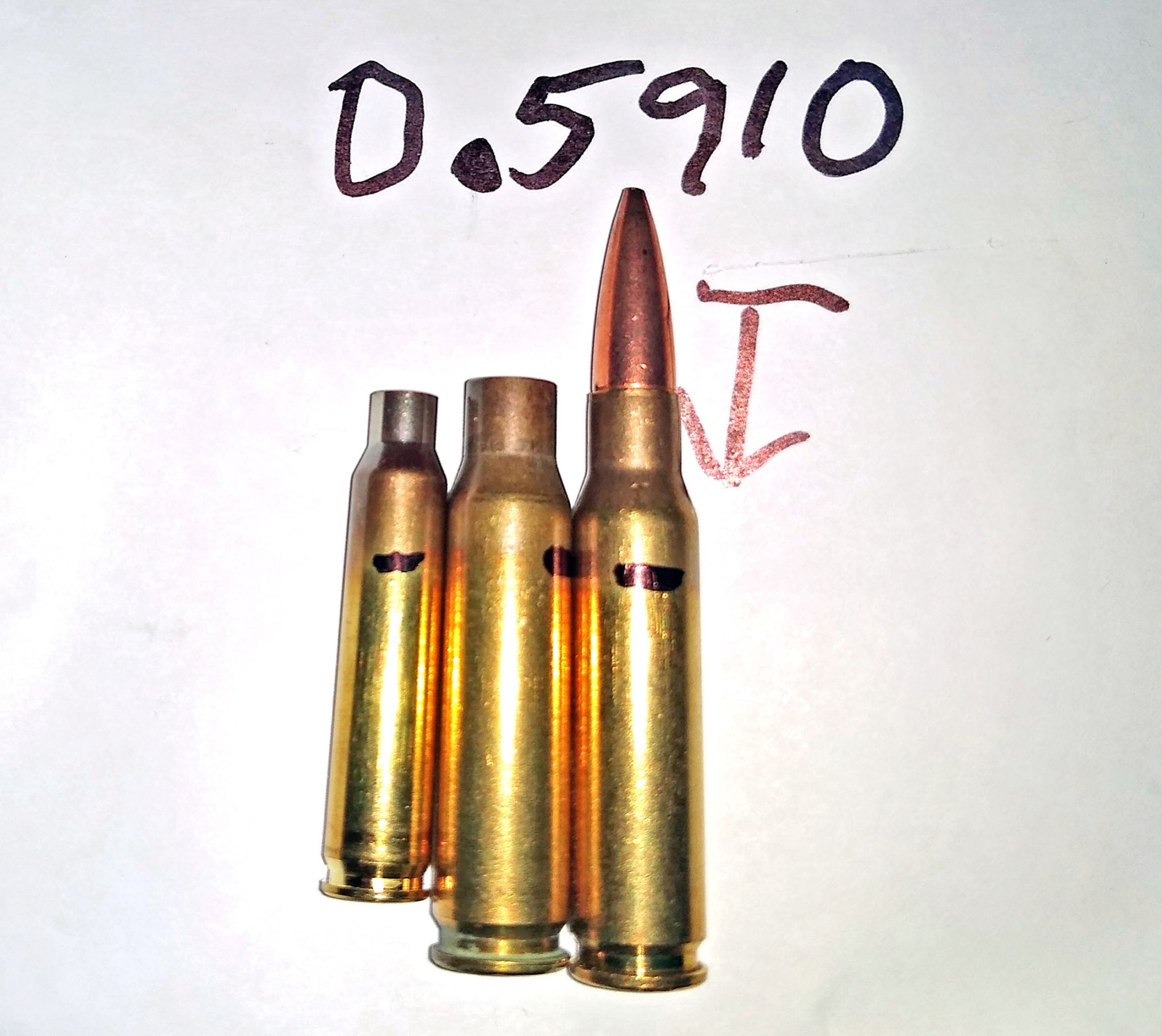

Photo below shows #6 cases I annealed after a light polish and one case is factory Lapua , the witness or heat registration discoloration measured from the mouth of the neck down is 0.591" .
I've more than proved it too myself as to the benefit of partial annealing ,by reloading M2- 30.Cal. 1942-43 LC & SL brass over #50 times and not losing a single case or splitting a neck . Brass becomes thinner and although I'm sure cases can go further ,Mine Won't as I like My Garands and don't want case head separation .
MY 6.5 Aero Precision build also has benefited from partial annealing . Must be something to that 0.591" measurement ,because FN Belgium .308 circa 1967 also measures as close as I can measure to that also . I modified an Anneleez for hands free semi auto volume work and it suits MY purposes .
**I just ran mine and MY timer setup actually drops case necks out dull Red but I time it when case flashes orange color ,there's a slight lag in rotating out of flame ( at least to my eyes ) before going full red and dropping into the container .
Brass melts at 930 C or 1710 F.
