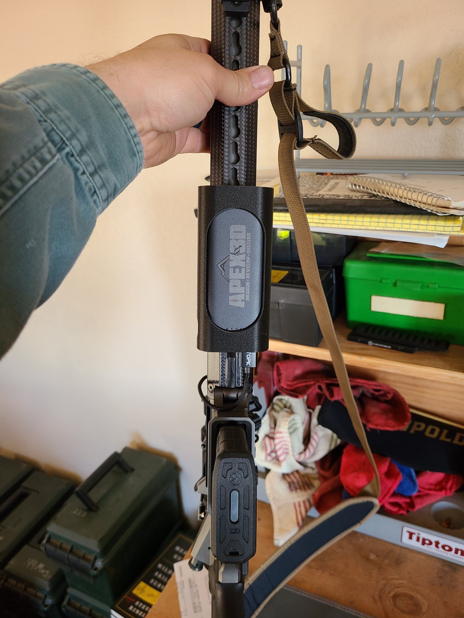

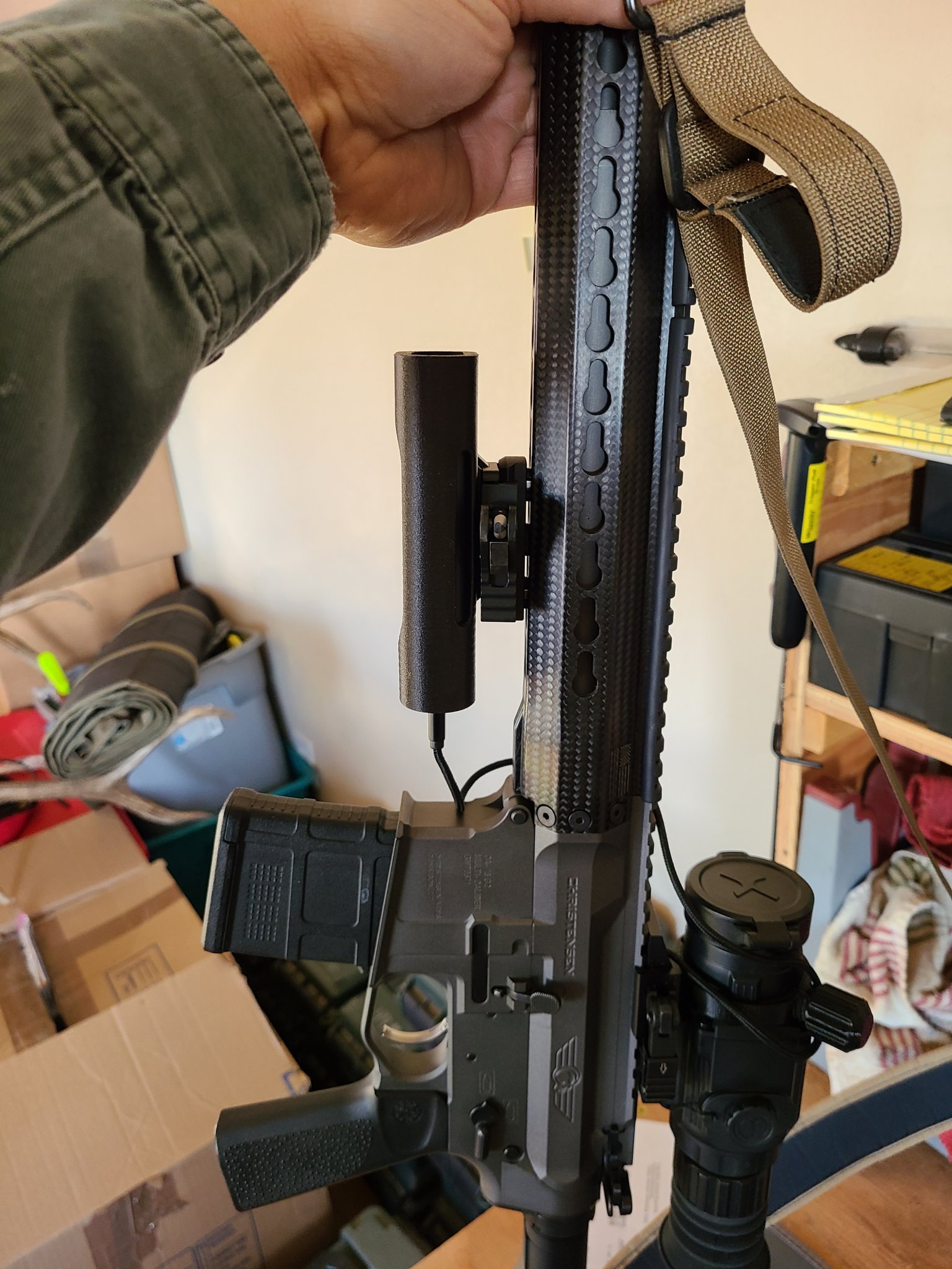

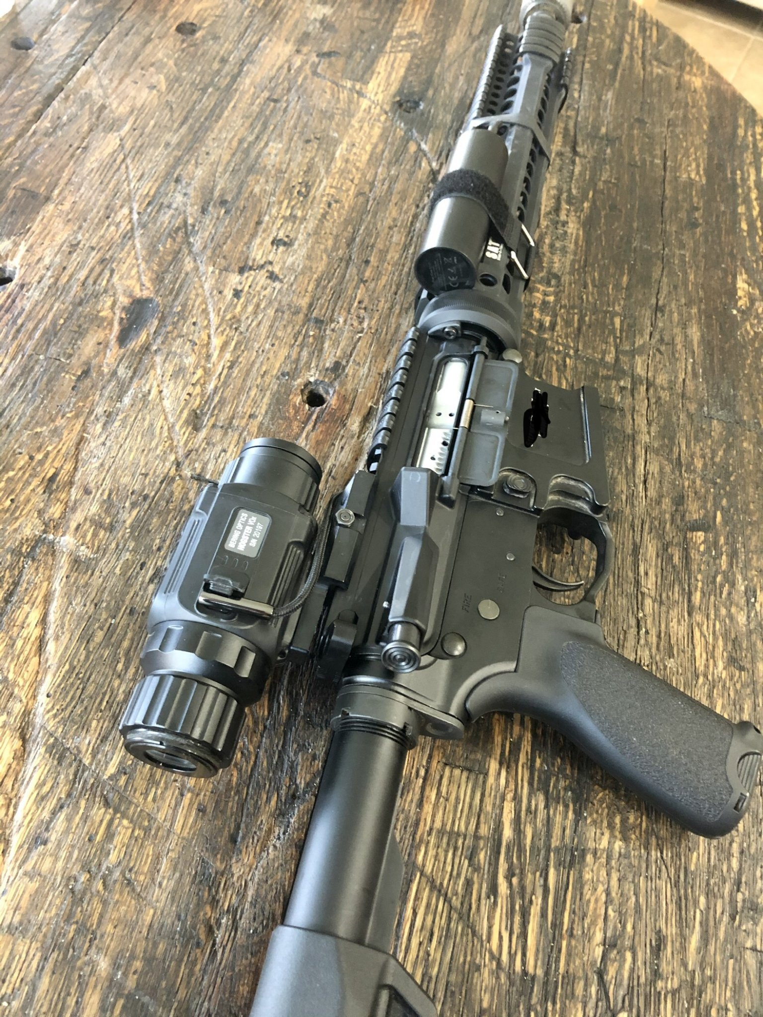

Might as well just get yourself a 5k Anker external battery. They’re dirt cheap, run the scope forever, and are low profile and easy to mount just about anywhere.
Sykes.... what are the dimensions of that battery. Not listed on site. Have a TRB on order but this may fot the rails better(limited space). I see they're backordered too. Thanks.
4.75"x2.25" and with the picatinny mount it sits 1.75" away from the handguard

I have used rechargeable 123s on a R35 when used as a scanner. However, I would highly recommend using a voltage meter and making sure the rechargeable batteries you are using are not providing a higher voltage than expected (3.7V). When using it as a rifle scope, I would recommend a 5v battery pack. I personally like the Anker style batteries. They are tested to extreme low temps. Many other brands seem to have difficulties in colder weather.
I have used the 5000 mAh Ankers you have mentioned. They are good but depending on how cold it is and the power consumed, they don't always last an entire night. I typically use the 6700 mAh or 10000 mAh. Of course, Anker makes much larger packs but you don't need to be lugging around a boat anchor on your guns. The 6700 mAh is what is in the Night Goggles/TNVC TRB. The 6700 mAh have been available on Amazon forever, but they don't seem to be at the moment. I have never used an Anker battery that hasn't been good.
As for what you are asking on voltage, the Hogsters use either standard CR123s which should be 3.0v. They also accept rechargeable CR123s which are 3.7v. There is a setting in the Hogster menu to set which internal style battery you are using. However, they also allow a 5V battery pack. The pack is connected to the Hogsters via the USB C port. It recognizes there is a 5V battery pack, and it switches over to battery pack power when connected. It doesn't have to be an Anker. However, as I mentioned earlier I have seen some power supply issues in cold weather with other brands/
