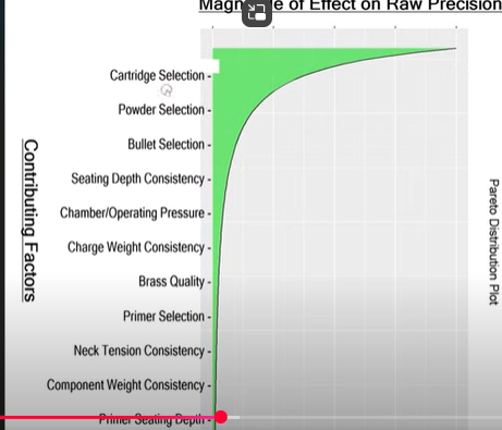

Little Crow Gunworks had this graph to show what he thought what level of importance each factor is in precision.
There are some cartridges and even bullet type that are more efficient for precision.
Some other minutae was not included, such as neck turning to ensure concentricity.
And this is assuming the shooter can replicate the same motions and recoil response.
