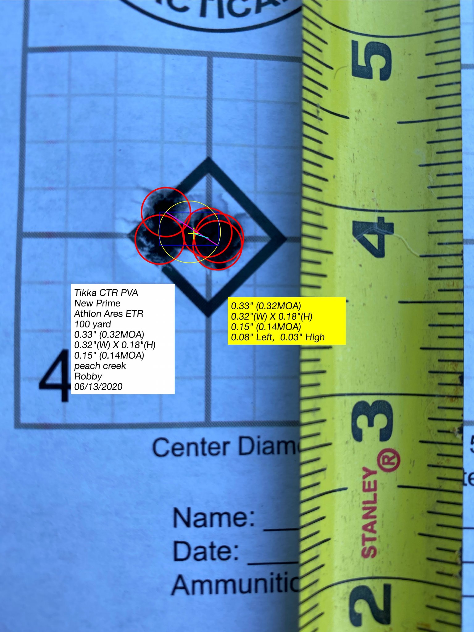

So semi new guy here. About a year ago I put on a PVA button 6.5 shouldered prefit on my Tikka. Bought during one of his sales and had it in my hands in less than 3 weeks. I am not a great shot but during first range trip I shot a 5 shot group that went .33 at 100.
Now I have not done it again as it was mostly good barrel a bad lucky shooter. PVA was great to deal with.
I can typically shoot .5 to .75 groups with it. That is about as good as I can shoot.
