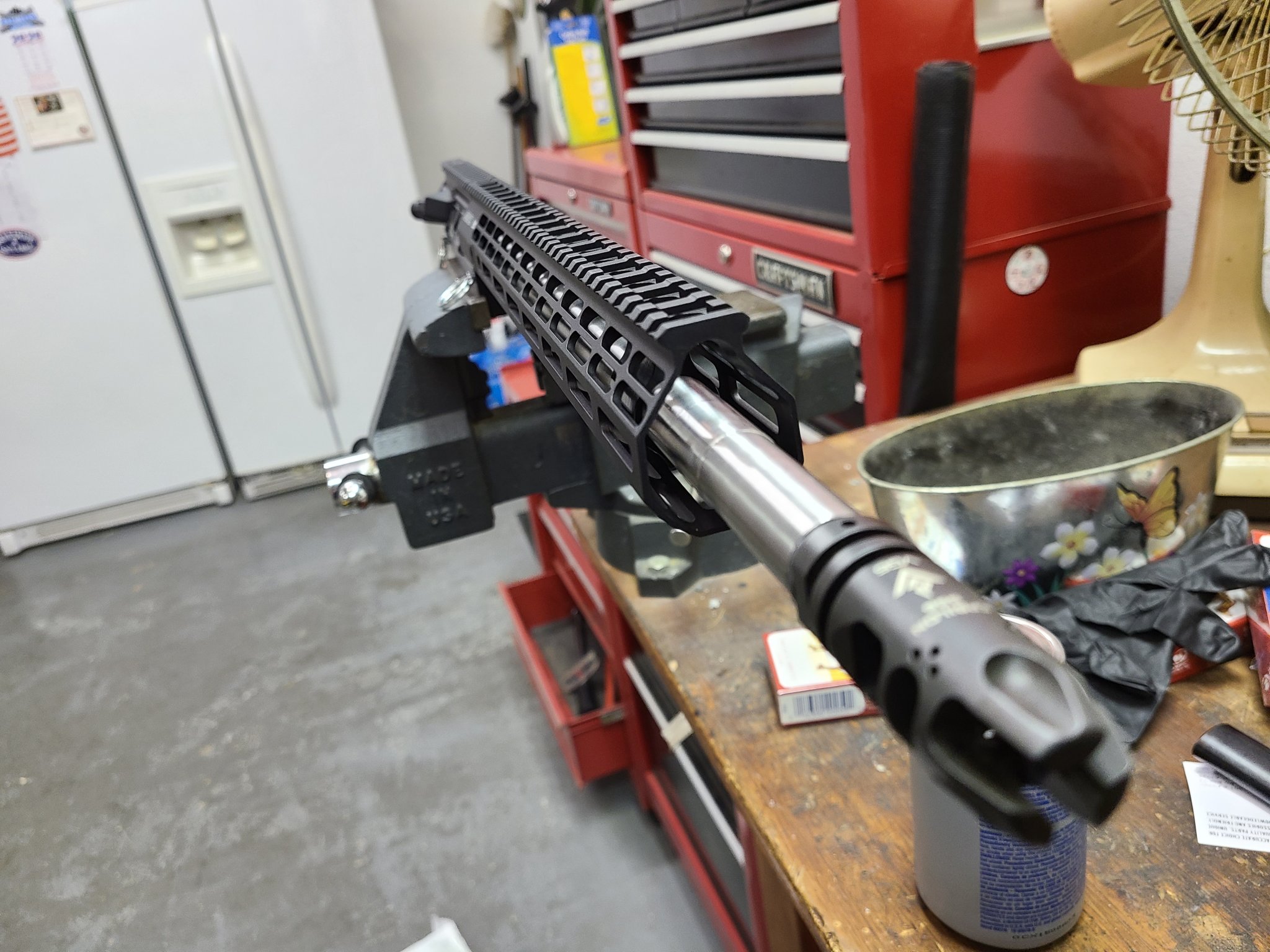

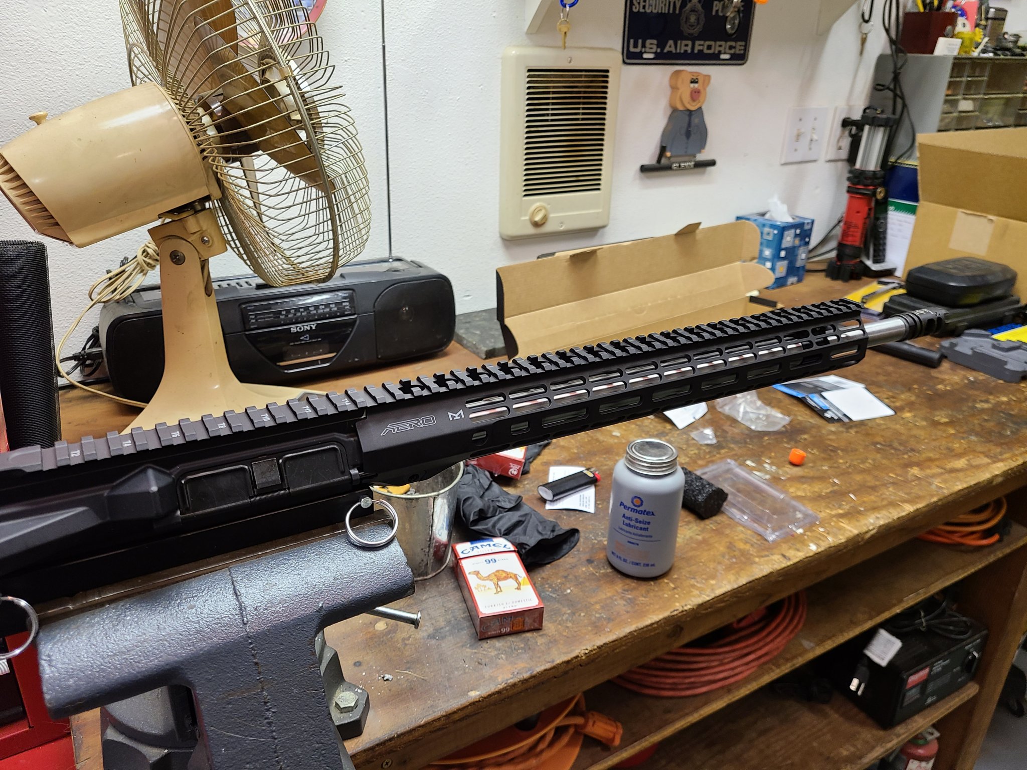

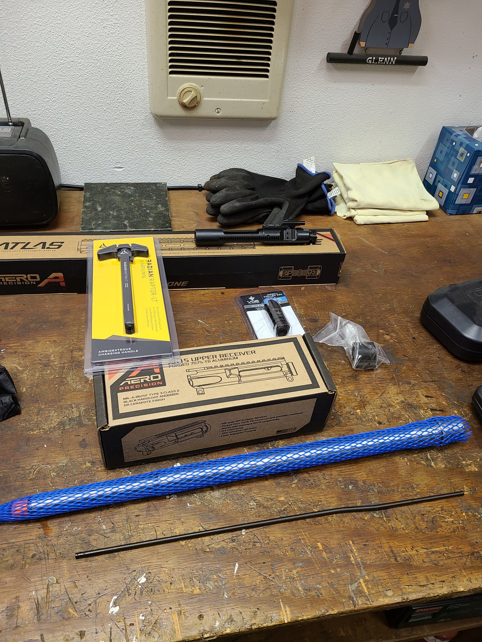

I'm using a Colt upper, and the barrel fit is fairly loose. Not a lot of play but, the barrel slides in with no resistance...should that be a major concern, or should I just send it in with Loctite, torque it down, and drive on?
Regarding the Aero upper, my guess is it will be a tighter fit than my Colt. My last build was a 11.5" Rosco barrel in an Aero upper, and I had the barrel in the freezer for an hour before it would go in.

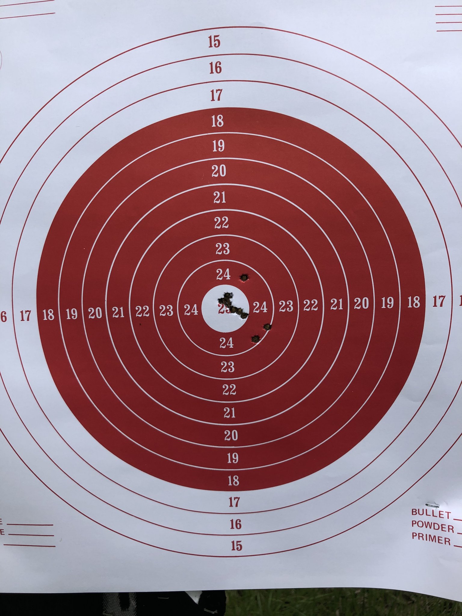

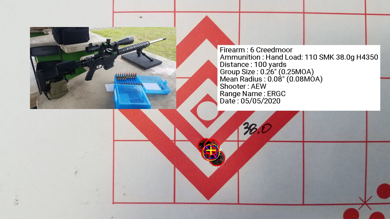

Fired my first rounds through a WOA 24" chambered in .20 Practical yesterday. I haven't gotten into real load development yet, I just wanted to get an idea of pressure, function and get it sighted in. If this is an indicator of WOA quality, I'll be doing an 18" SPR .223/5.56 in the future.
Nice group...100 yards?
Reactions: TACC
I have an 18” WOA barrel and matching bolt being shipped to me with a midlength gas system. This will be almost exclusively be shot suppressed unless doing load development thanks to my magnetospeed sporter. Do I need an adjustable gas block or is it more of a convenience? Suppressor is deadair nomad.
Yes, @100. I haven't played with seating depth or tweaking the powder charge other than a half-assed OCW looking for pressure. Not much load data other than internet and a single Hornady pdf. I'm thinking there is more potential here.
A friend has done 2 WOA 20 Tacticals and they are hammers.
