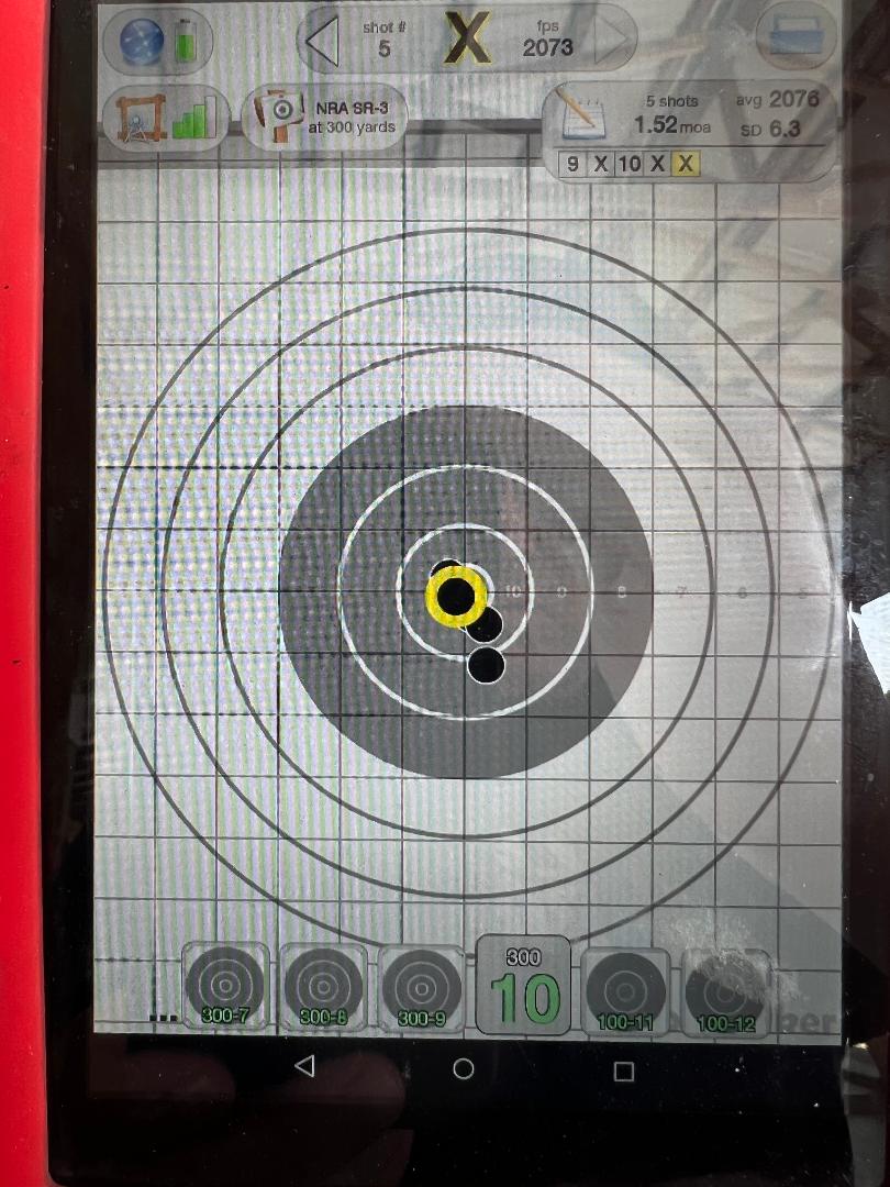

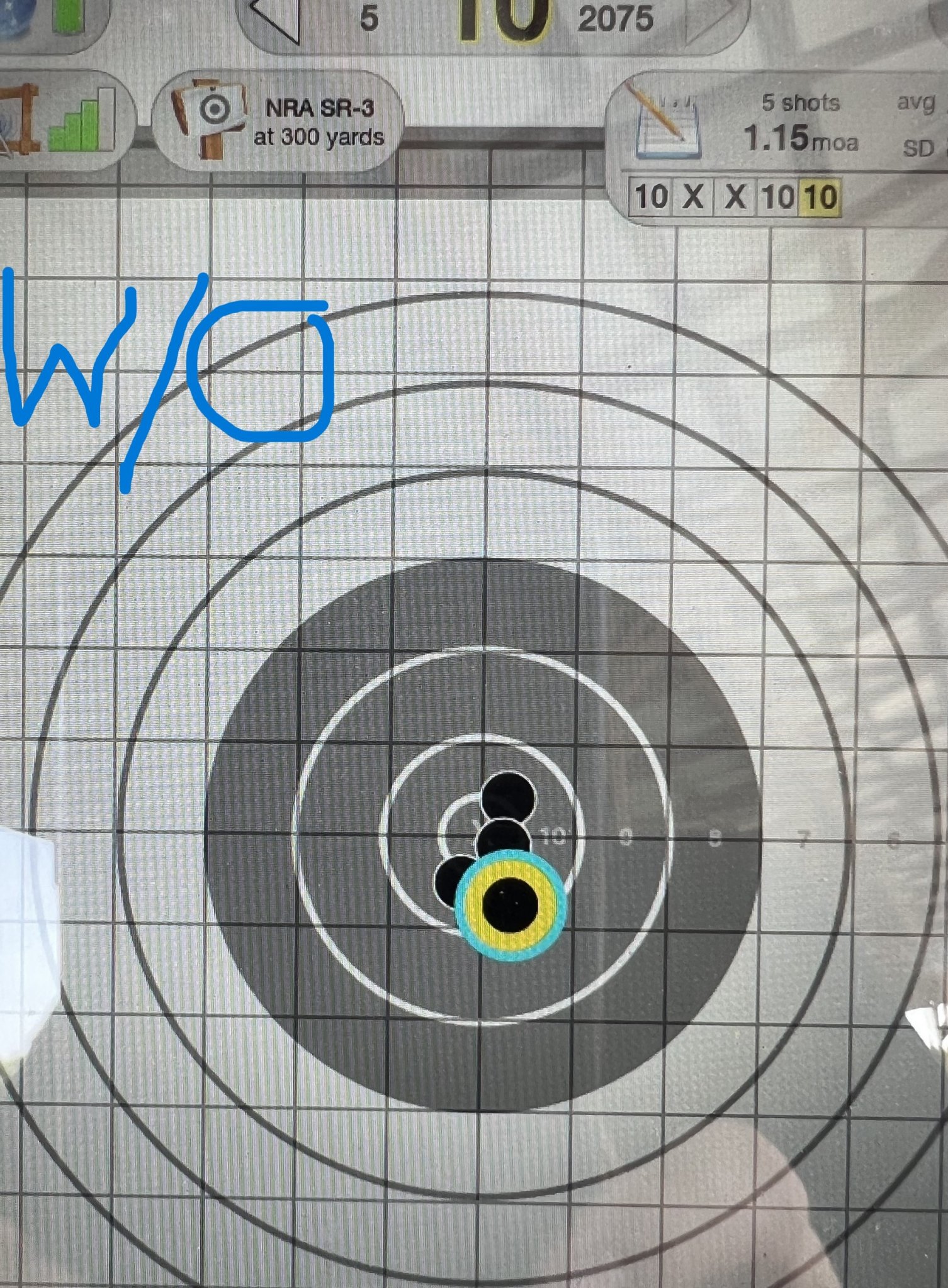

I've had a very similar experience with my 20 inch WOA varmint barrel. Loaded 69smk and 73eldM in Lapua brass, TAC and CCI#41 primers. Tried from min-max OCW tests 2 times. Would shoot about 1moa at best. Then loaded up 55gr Hornady SP with H335 in win brass with CCI#41 from 21.8-24.5gr and all were sub moa most .5 and under. Just bought a 24 inch WOA barrel, when it gets here I'm going to try the 69SMK again, and if it doesn't shoot I'll go try the lower grain bullets
