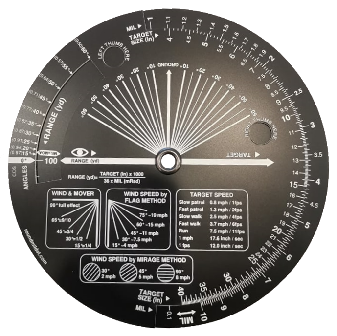

Please recommend me people who do good reviews on sniping equipment? I have made a slide ruler for fast distance calculation (roundmildot.com) and I would like to get it tested and reviewed.

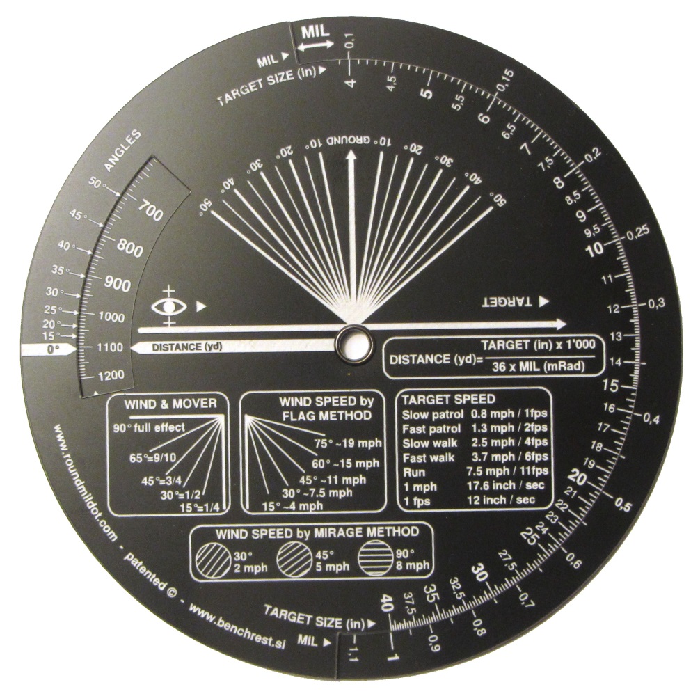

A small review on the item in question.
For the background, I’ve always preferred and trained with the so-called analogue solutions. Be it map and compass, or ranging with reticles and calculating from there. I didn’t even have a Kestrel for a very long time. Well yes, I have finally acquired the helpers (GPS, laser rangefinder and a kestrel) and these do help, but the habits are still there to use these as supplements. I shoot some precision rigs myself, but also train the designated marksmen. In short, I like it simple and functional
Which brings me to the Round Mildot. I have some previous experience with it as I’ve played with a few over the last couple of years. I like that it is simple to use and mostly takes away the need to use a pocket calculator. Because it is faster this way or when it’s cold outside I don’t have to worry about something freezing. So I was quite eager to see the latest iteration of it. And will share my thoughts here. I do look at it as a part of a bigger system, supporting my needs and deeds, not as a purpose by itself.
Right now I have a couple at hand. The one pictured by Mattias here is in imperial measurement system, inches and yards. But there are others as well (purpose-designed for the weapons systems we use in here). The new ones, aimed at the international market, are printed in black&white. With the text very nicely engraved (or however it is actually made), meaning I don’t have to worry about the letters erasing away while wearing this thing in my pocket or something.
What I first noticed is the layout and quality. It is not too big, I’d say quite handy in size (11,5 cm in diameter). It is also printed nicely, as already mentioned, so I would expect it to last a little longer and survive more bumps and scratches. It has most of the things I need on the field on it.
A picture says more than a thousand words they say. But I will comment a little. Its primary function is to replace the table of target sizes in both in/mils and corresponding ranges. And while doing that it also offers corrected ranges for shooting up- or downhill, all in same window. I can use it to estimate the angles as well without having to rely on another gadget.
It provides basic data on wind and mover speed and related effects. The wind rose on it is a more refined one, something like the Lowlight put up in the wind angle thread (in Advanced marksmanship). I like it, I preach it.
What it doesn’t offer are exact clicks and hold values. I would say it is better that way as it keeps things simpler. I’m accustomed to my weapon system anyway and have my own dope for clicks.
What it does offer - a firing solution. It gives me the necessary data for my rifle’s ballistics so that I could decide the needed clicks or holds to the best of my ability.

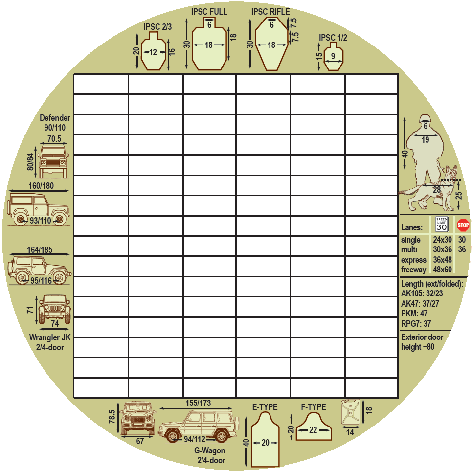

The new version of the Round MilDot calculator is finally out: https://roundmildot.com/product/roundmildot-us-imperial-calculator-with-dope-card-sticker-a-grade/
This calculator has nothing printed on the back side: the back side is white. It comes instead with 10 back-side stickers where you can write your personal DOPE card information. If you change the ammo or the sticker wears off, you can just use a next sticker.
The sticker also has exact measures of most common targets (IPSC ja IDPA) and other objects like cars, weapons and traffic signs. I am not 100% sure if the traffic signs sizes are all the same in all states, but they should be correct in most cases.
I also added thumb slots to the front of the calculator for better grip - this is especially useful while working with gloves.
I had a bit of trouble in finding the balance between all the suggestions I received on how to make the calculator better - I hope the new version is a good compromise and will be well received.
If you find any mistakes or have good suggestions how to make it even better please e-mail me: [email protected]
