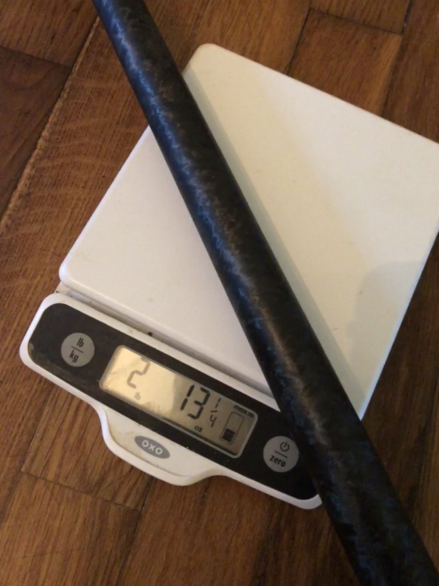

Should be a hair lighter after the smith work.
