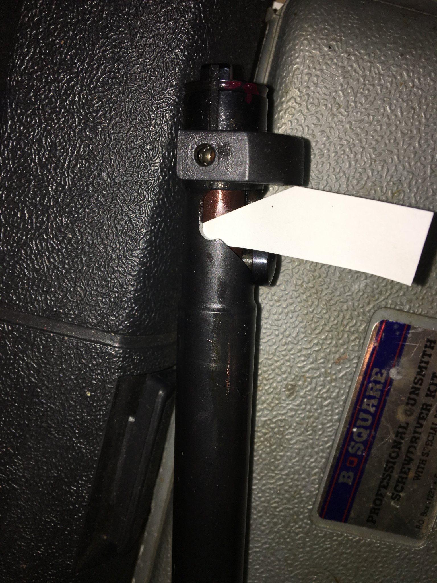

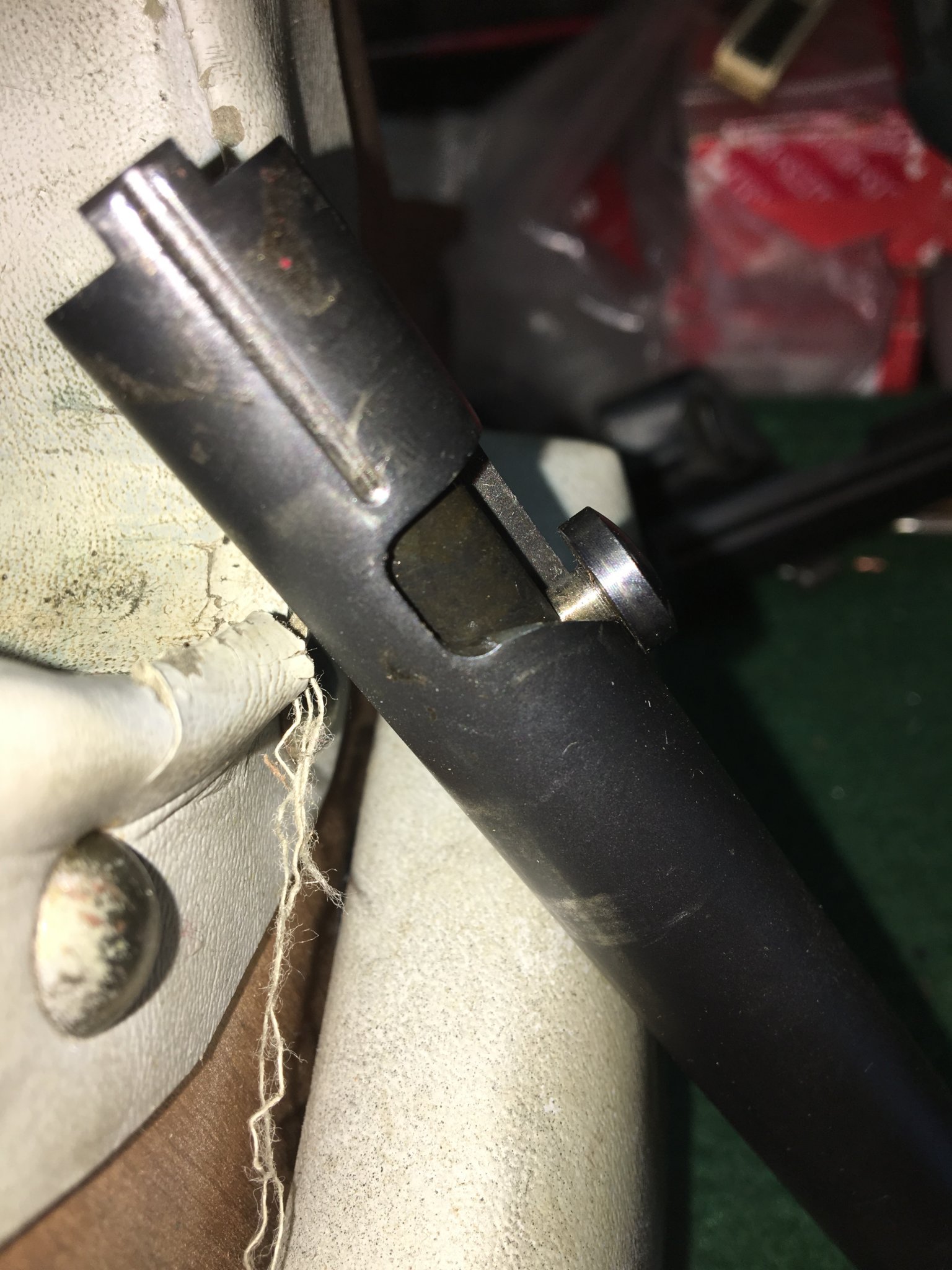

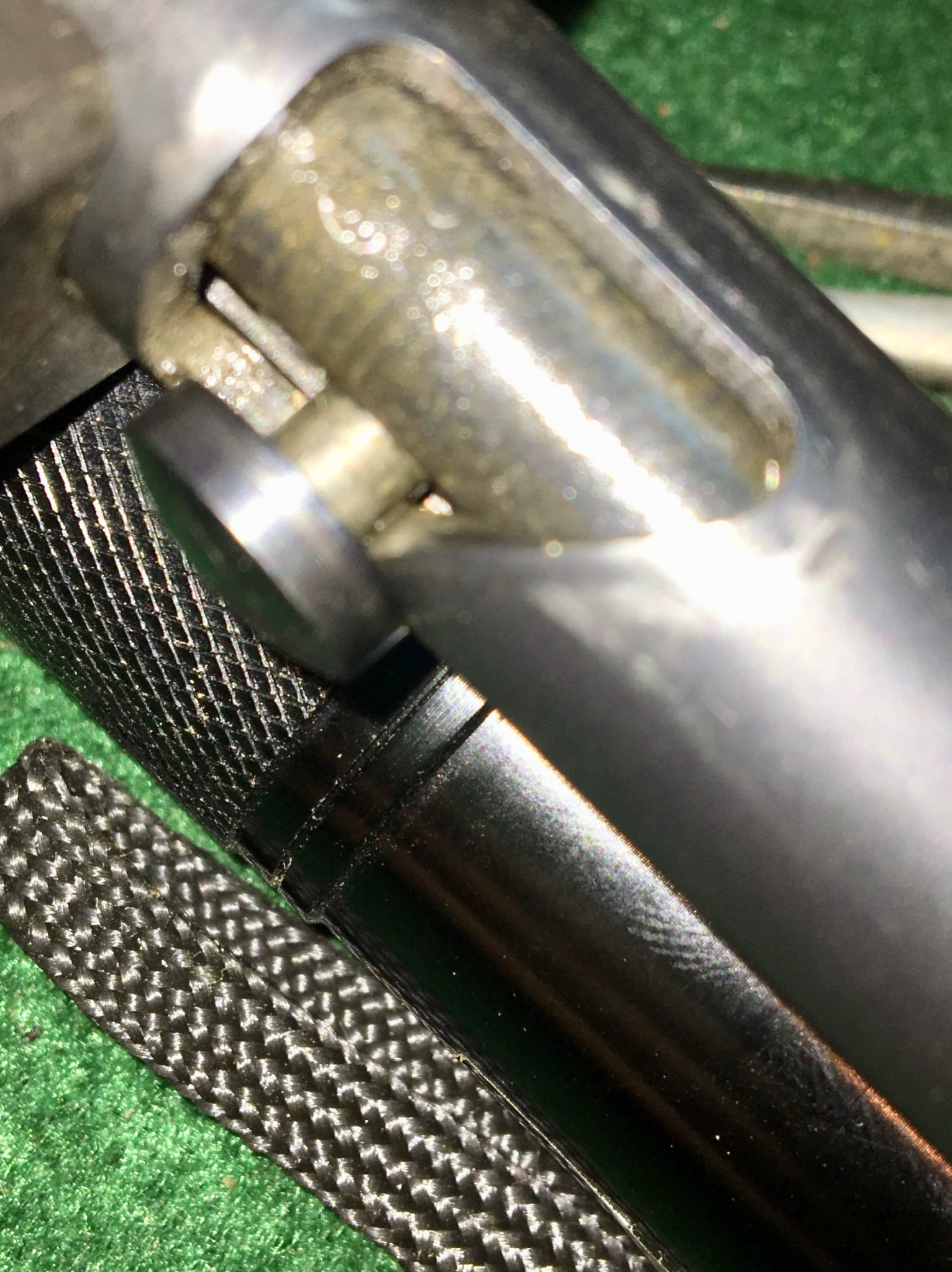

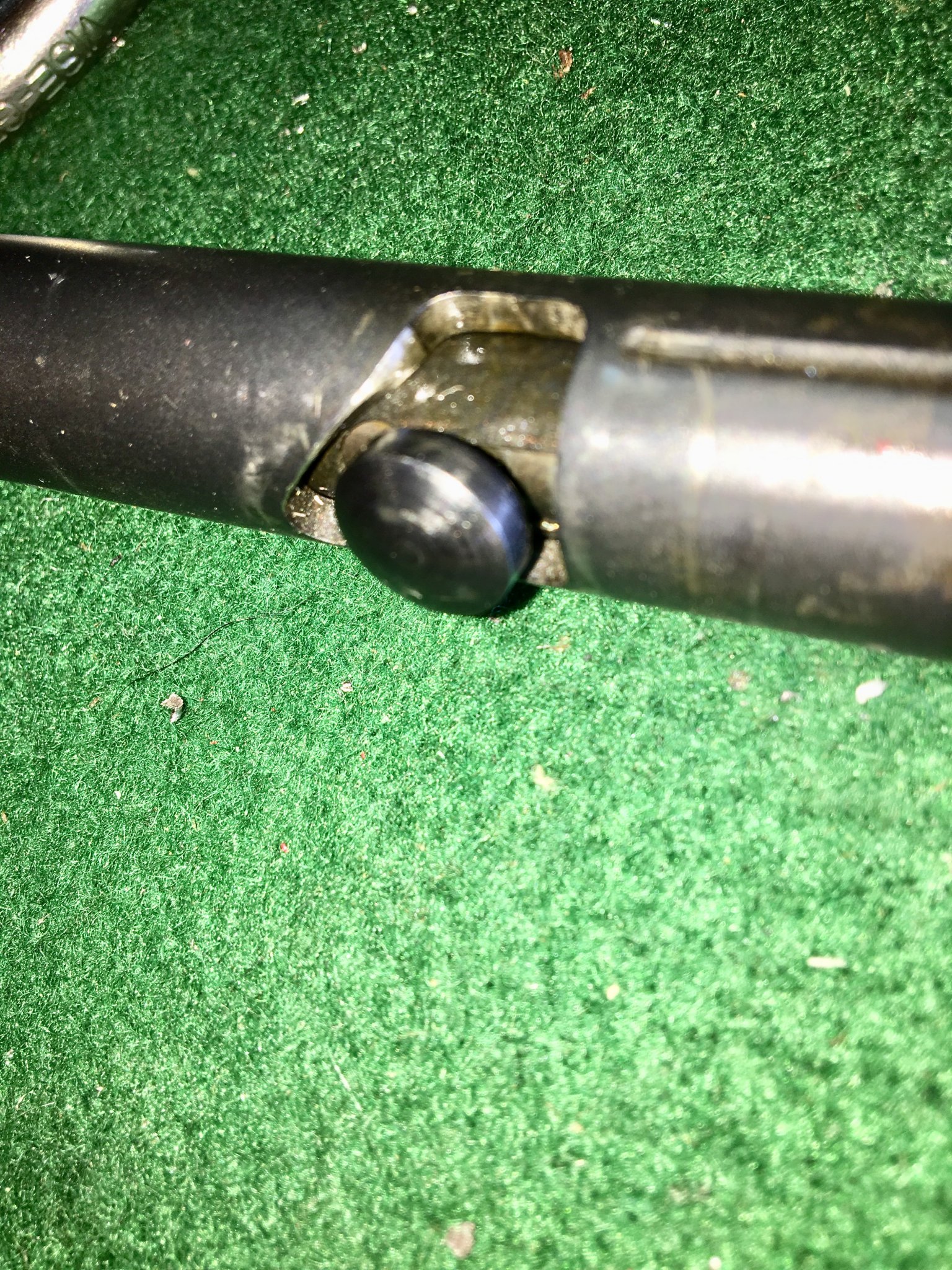

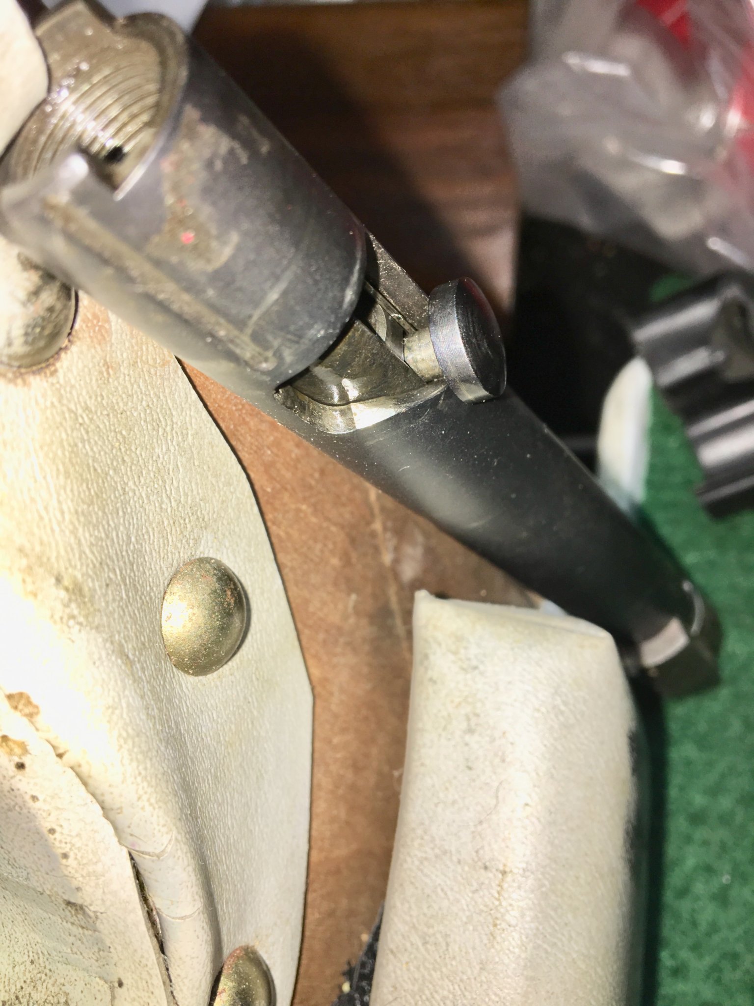

here is some pics for those shooting cheep guns to make the bolt lift very smooth and easy.
the first pic is an unaltered one. you can see the raised point right where it should be level.
sorry the pics got jumbled the scond one is the unaltered one
the first one is it leveled off creating a smooth easy bolt lift
the rest are just more pics of the mod
oh while your at it check your firing pin protrusion, it should be .060" if its not adjust it.
