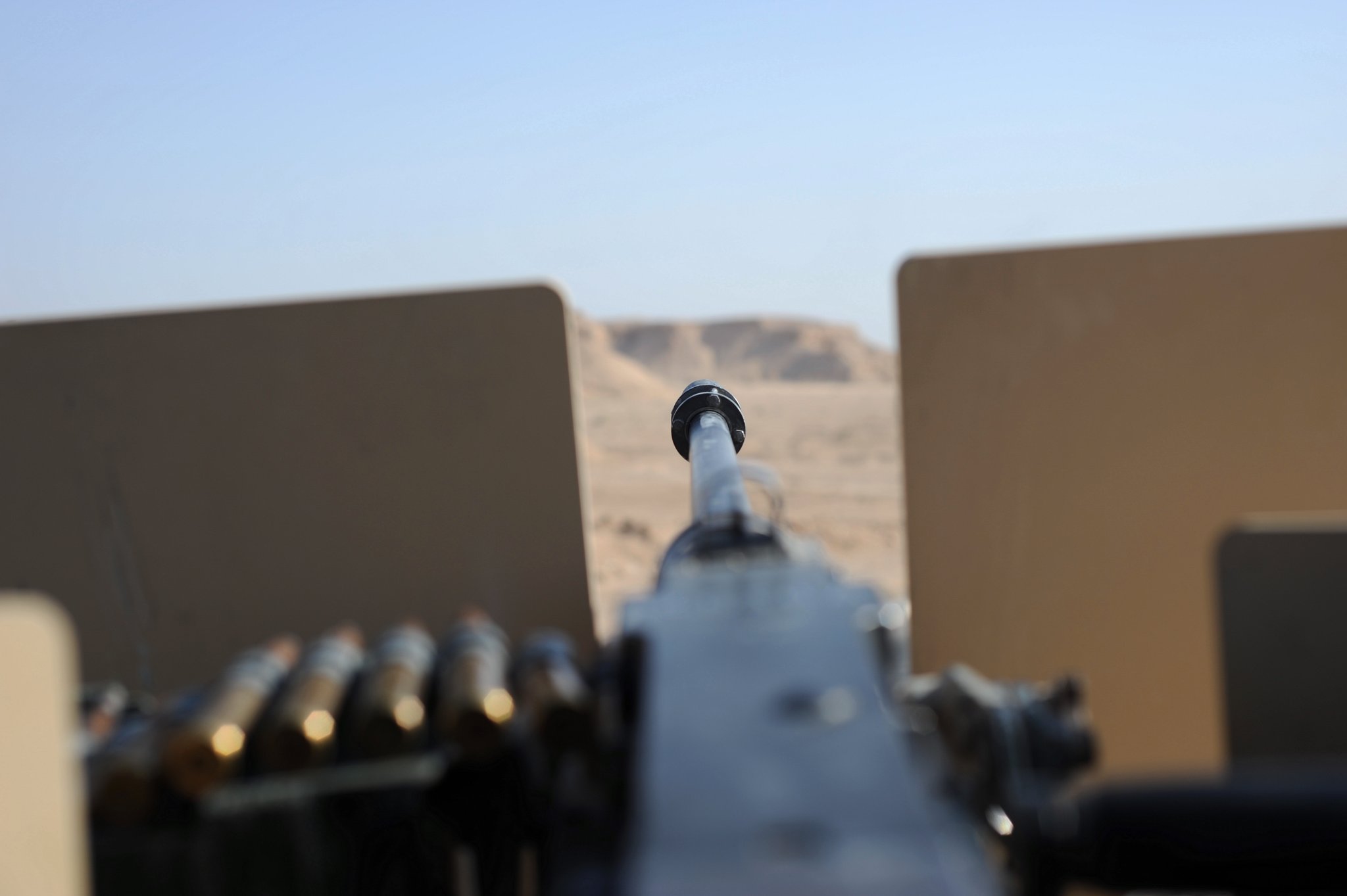

Rifles Only Accuracy Podcast season one episode 4 @ about the 24min mark.
Very good information straight from Leupold rep.
Parralax set at 150 the max you can be off at 300 is 1/2 the distance of the objective.
Once you get past the hyper focal distance (light beam is straight) the parallax becomes a focus knob.
WWT, my friend. You introduced a concept into this discussion and I think we need to put it in context.
The hyperfocal (one word) distance is a long-understood concept in photography that applies to riflescopes also, of course, but needs to be applied properly. Even in photographic circles, when we discuss the concept of hyperfocal distance, there is always a little bit of discussion on how best to a) calculate it and b) use it.
The hyperfocal distance is the focus setting on a lens that will have the greatest depth of field for your picture (or application). For example, let's say you want to take a focused picture of a car fairly close to you and have the mountains in the background also be in focus. If you focus on the car, the mountains will be out of focus, or at least not as sharp as you would like. The trick is to focus past the car and yet still have the car focused crisply enough for your purposes. As you focus further out, the mountains come into better focus to the point where the car and the mountains are clear enough for your purposes.
Here's a good link for a calculator and some examples:
It's a similar concept with a riflescope except that the only control you have is the side focus. No aperture, no shutter, no ISO. But with a riflescope you don't change that from picture to picture, you set you side focus to the distance where the depth of field covers the near and far distance at the level of sharpness that you find acceptable. Let me introduce once again, my friend circle of confusion. This is the guy who signals you that the sharpness of the object in the picture is good enough. Most camera manufacturers and hyperfocal distance calculator use a CoC of .03mm, I prefer to use a CoC value of .02 for my pictures and for my riflescopes on precision rifles. Boy, are we ever getting pedantic here. I can easily calculate the hyperfocal distance for any camera lens, but doing the same for a riflescope is not easy because the manufacturers do not provide the information we need to do that. I keep thinking that I could develop a hyperfocal calculator for riflescopes using the main tube inner diameter, the objective lens diameter and (the tricky part) the focal length of the objective part. Maybe I can derive that from the dimensions of the scope or perhaps just the base magnification and make assumptions about the eyepiece focal length.
Anyway, I digress, and of course, someone will post a link to such a calculator. Anyway. If you want to figure out he hyperfocal distance of your riflescope, the best way would be to set up some targets or objects at various distance with "infinity" in the background like a mountain. Then at low power, use the side focus to find a setting where the nearest object you would usually expect to see clearly, is in acceptable enough focus and the "infinity" background is also in acceptable (to you) focus. Now comes the fun part. Start zooming in. Of course the field of view will quickly reduce but you can point the scope at the near and then the far object, without touching the side focus. The zooming action is essentially decreasing the CoC value in our concept here. As you zoom in on the image the focus becomes more critical and it's up to you to decide what is acceptable to you and at what magnification.
If you have a side focus knob, you should remember or mark the position of the knob that provides the best hyperfocal distance for you, or perhaps just a crisp picture at 100 to 130 yards.

A camera lens is essentially the equivalent of the objective lens portion of a riflescope with the first focal plane acting as the film or the sensor. The other two parts of the riflescope; the erector assembly and the eyepiece assembly are the added lens elements in the riflescope.
The way I was trying to use the calculators was to try to guess the focal length and the aperture of the objective lens group. In a silly attempt to equivalence the two, I figured the bottom mag (1X) was what the focal length of the objective was providing. You should remember that the magnification of a riflescope is calculated by dividing the focal length of the objective by the focal length of the eyepiece giving the minimum magnification, then times the erector ratio for the maximum mag.
With an LPVO, we are talking about a 1X mag, the equivalent in a 35mm sensor is 50mm lens. But the "sensor" size is really the ID of the main tube. Anyway, I used 50mm as the 35mm equivalent because that's what I grew up with and tried to figure out what the aperture was, I looked at f/5.6 and f/8 as possibilities. And then my head really started throbbing....
The numbers I was getting showed a WIDE DOF at various hyperfocal distances. So I grabbed the 1-10X24 and started checking out the numbers and that's when I wrote up my post above. The SWAG numbers were trending towards what I was seeing.
I'm still thinking about figuring out a hyperfocal calculator for a riflescope but the throbbing pain in my head has to end first.
