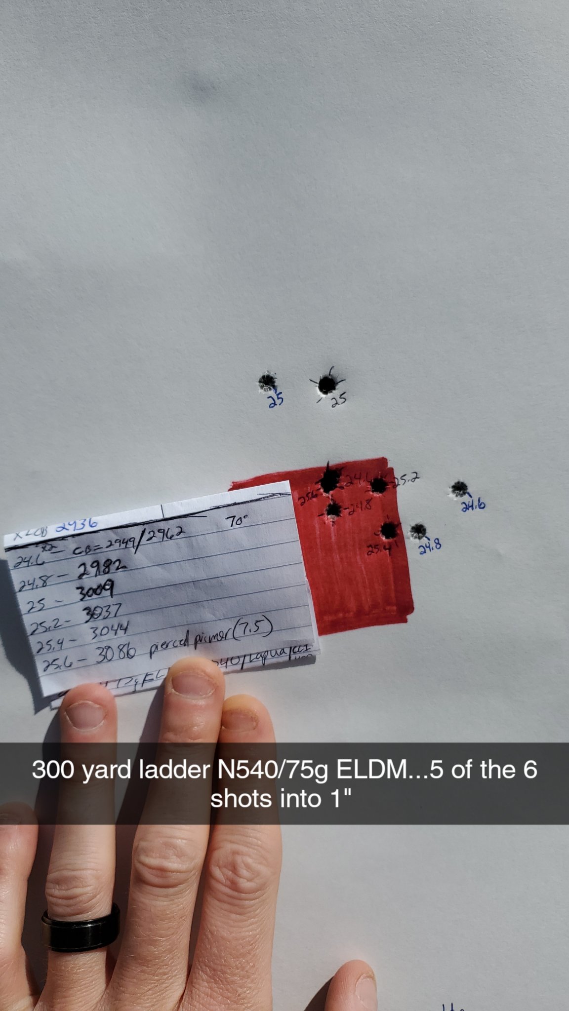

So just finished up the 300 yard ladder with N540/75g ELDM. 5 of the 6 shots went into 1"
I think the rifle and myself is going to love this combo. Gonna go buy the last 2 or 3# they have and start load development...
Did pierce another primer at 25.6 at 3086fps. Using Rem 7.5s this time around. Probably a little warm...But it still shoots. For some reason it keeps throwing the 25g charge high, but at least it's consistent haha.
The black ink markings is from today...blue ink was from a few days ago (and stopped at 25g due to pierced primer with CCI 400)before he cut the chamber deeper...
Probably going to start around the 24.6-24.8 mark at around 2975fps...

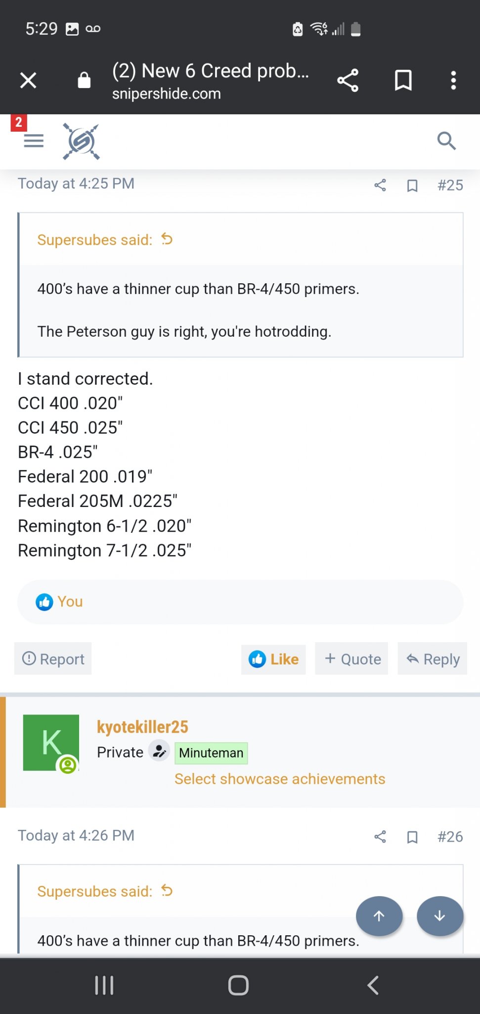

I thought 7.5s, 450s, and BR4s all had the same cup thickness at .025"?
BR4 and 450 I think are the same thickness cup, not sure about the 7.5's. Aren't you shooting a 75gr or 77gr bullet?
From all my research from several sources, the 7.5s are the same thickness as the 450s and BR4s at .025"

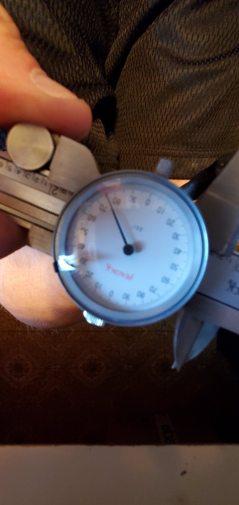

Measure it with calipers and see how big it is.
Should be .062" max

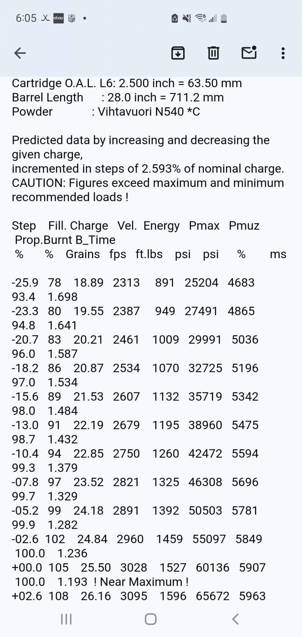

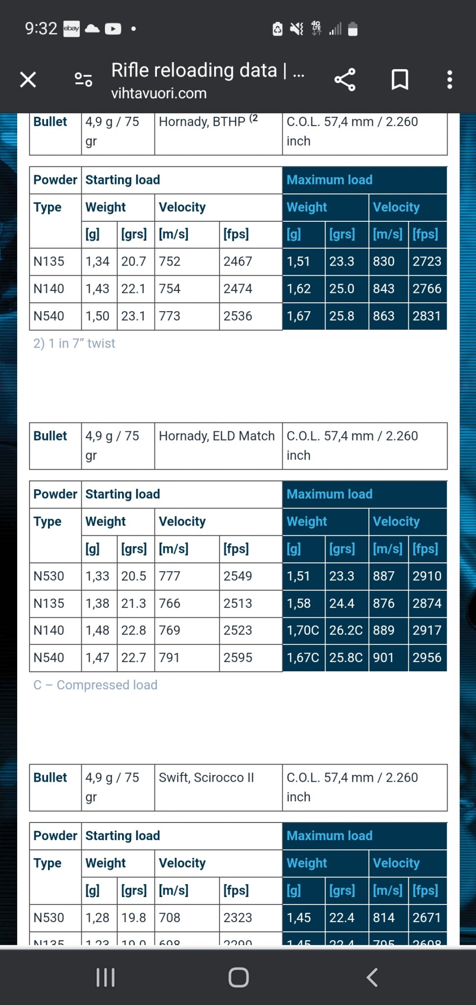

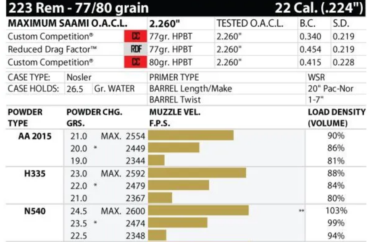

Book max speed on n540 with a 75 gr is around 2,600 MV

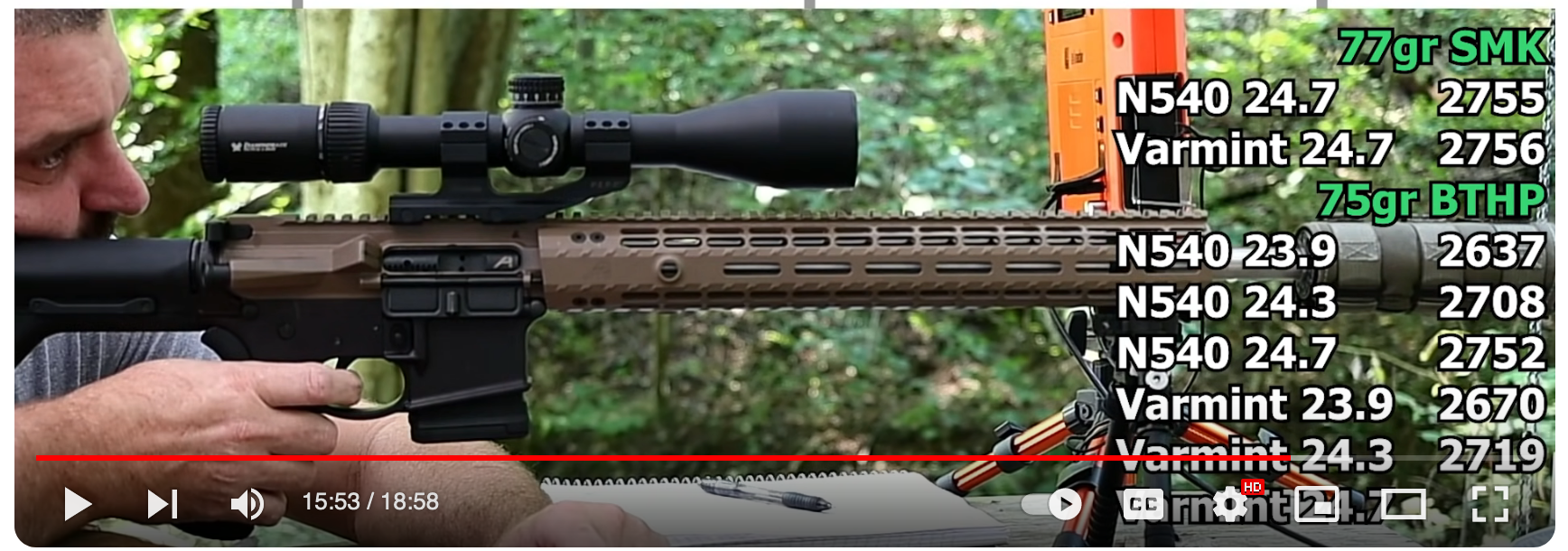

Because that's fucking AR data and a 20" bbl...
Go to vihtavouris website or plug it in QL...And get back to me...
This is a 223 Wylde bolt rifle with a 28" barrel. And I have it set up to 2.510" to the lands...
Per quickload...
Per vihtavouri...
Still say 2600???

VV is telling you 2,950 is max,
QL is telling you 3,050 is "near max" !!!!!
And here you are 3,100 +
Looks like => you are getting pressure signs
I have no doubt longer coal, pointier eldm
and 8in bbl etc gives you some leeway,
Great! And I said that was a ladder test. Which is a pressure/velocity check. Also said I wasn't going to load around there. You're reading comprehension skills are quite garbage...

Also my firing pin measures .076" that's probably a big reason why I'm piercing primers right?
I'm getting 1.458" on the fired cases on my comparator...so a .003" difference.
