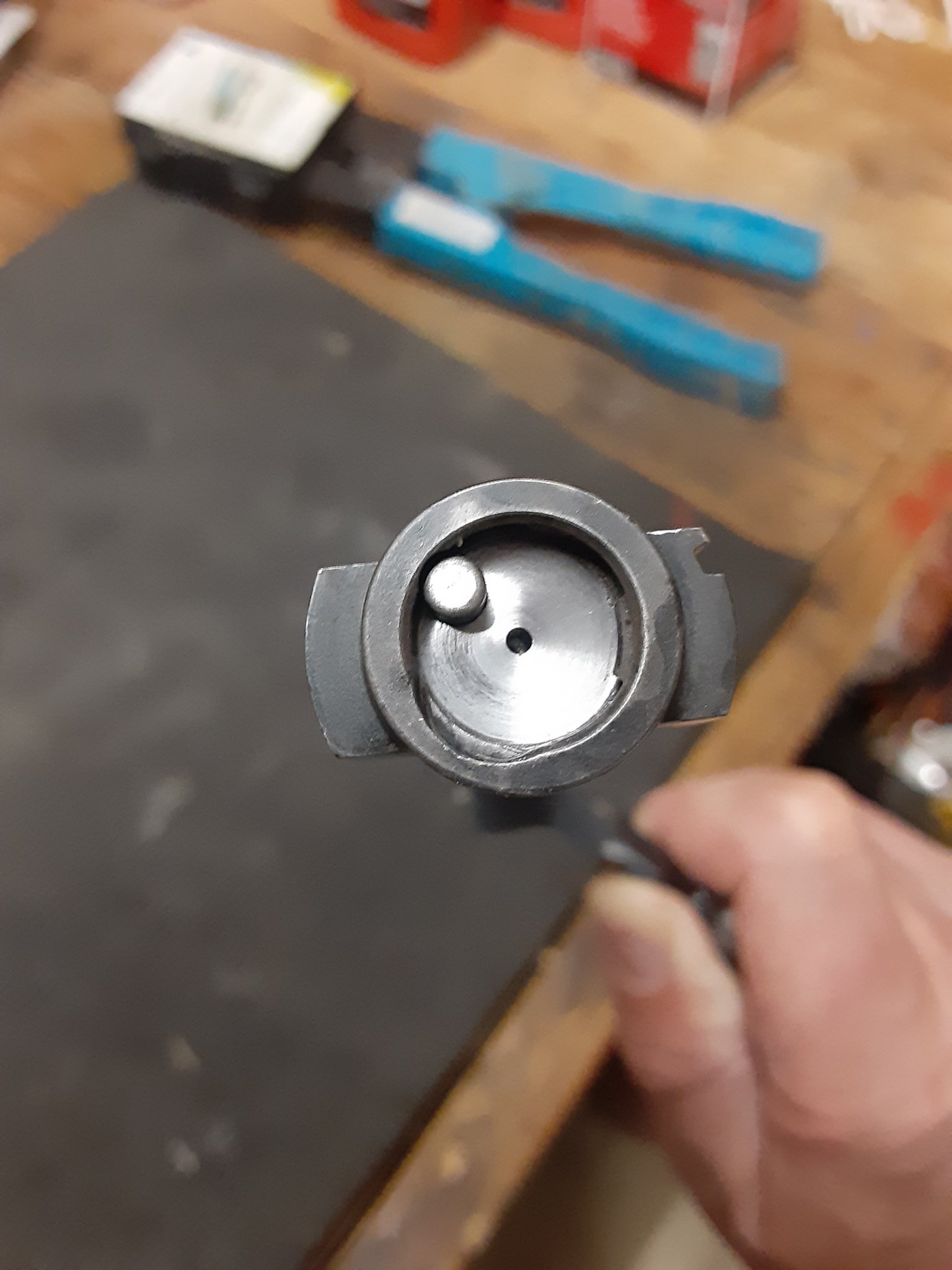

Also my firing pin measures .076" that's probably a big reason why I'm piercing primers right?

So basically I need my current pin bushed, or get a smaller one altogether, from my limited research correct?

Correct, .062 or smaller.
.076 is huge. I was piercing cheap primers with a .068, but it worked with more expensive primers (M205 and CCI 450)

Thank you. Who does bushing besides Greg Tannel? He is not accepting any work right now sadly. Any other recommendations??

You're forgetting the biggest issue here is probably the big ass fucking firing pin I have, or you just don't care and like talking shit, which probably is the latter I'm guessing...

PM Carlsbad on here or accurate shooter. He bushed the bolt on my 700 6.5x47 and it looks great. No more primer cratering.
LRI is who you seek. Might even get a twofer by getting your headspace right where you want it all at the same time.
