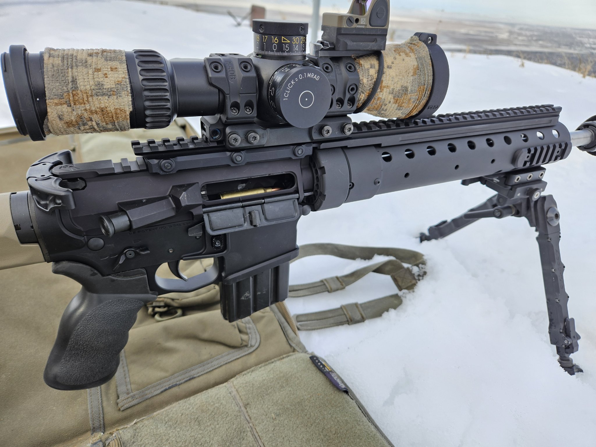

I can but it's 💯 me pushing the rifle to see where it isn't reliable tho....
My build:
Adm adm4 billet receivers
Compass lake kreiger
Jp scs
Superlative adj
Jp bcg
Sico hybrid suppressor
Ammo was 23.5gr of tac over a 77smk

What temp?
Do you have mv measurements at that temp, and a temp where you’d call function of the rifle ideal?
What, if any lube, were you using?
Was the rifle clean when you started?
Did the rifle struggle at the start, or did it get progressively worse?

What temp?
25-30 F
Was like 2700 iirm. In 90 weather it's closer to 2760ish.
No intentionally had about 300 rounds all supressed I did however, use my lube of choice...old 0-20 oil on the bcg to start.
First 100 rounds started fine. The next I could start to feel the bcg starting to drag a bit and get sluggish.
